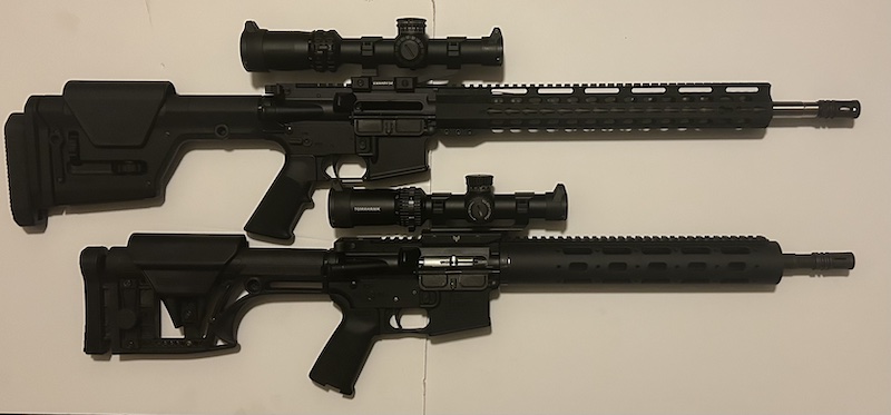

Having a 22LR version is always fun and good training. Top has a 18" 1-8 twist barrel with 223 Wylde chamber. Bottom is a heavy 16" CMMG dedicate 22LR barrel.

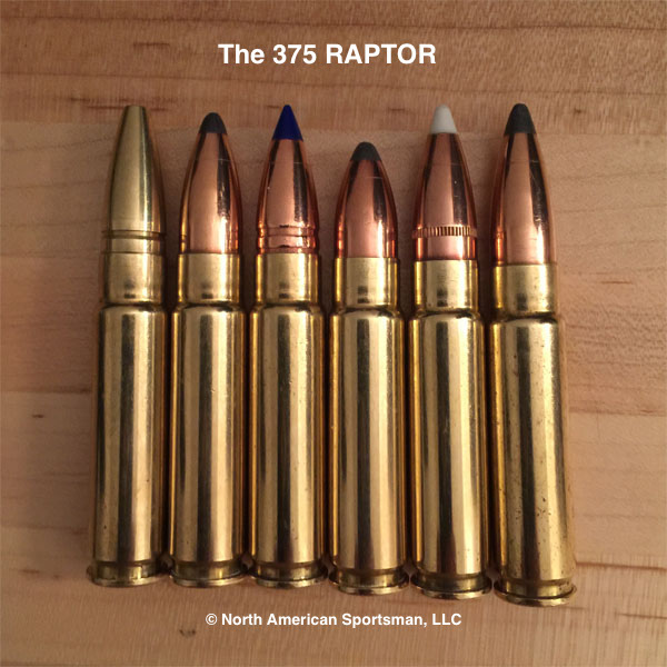

I think 375 Raptor will be my next. 16" barrel throwing 225gr at 2400 fps. 400gr subs too.

May I introduce you to the 375 raptor? its a wildcat based off the .308 win, so everything but the barrel is still standard .308, but it has some crazy nice properties. It was originally created as a short action option for hunting african dangerous game because of the legal requirements there for .375 cal and up.
its expressly designed for shorter barrel lengths too. Maker Bullets makes a 400gr copper monolithic for the caliber for subsonic use.
