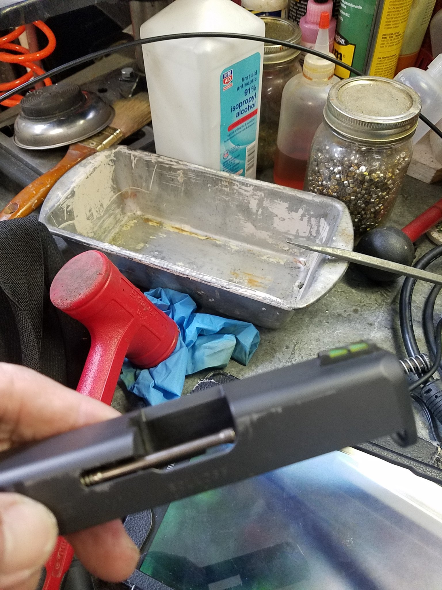

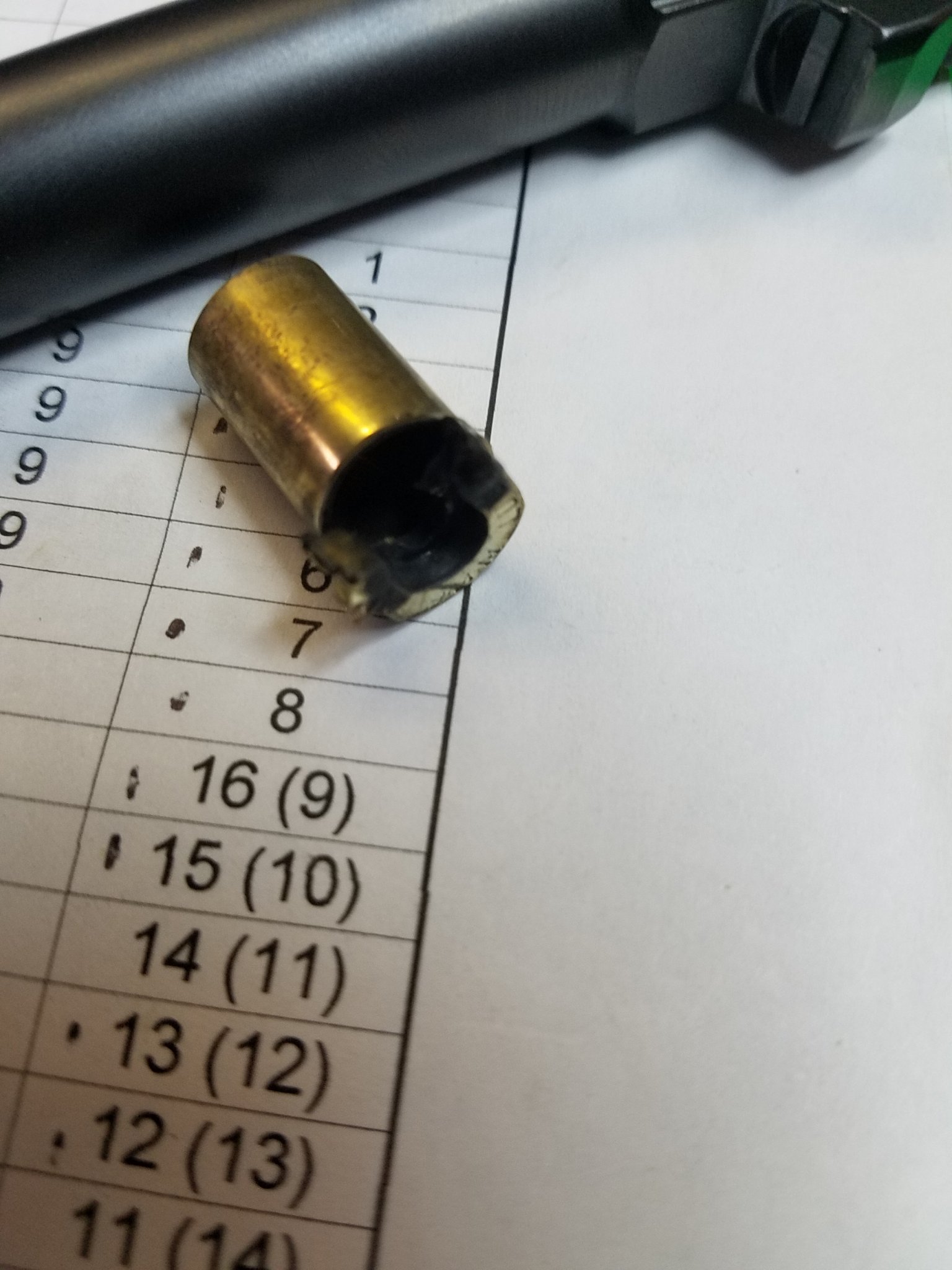

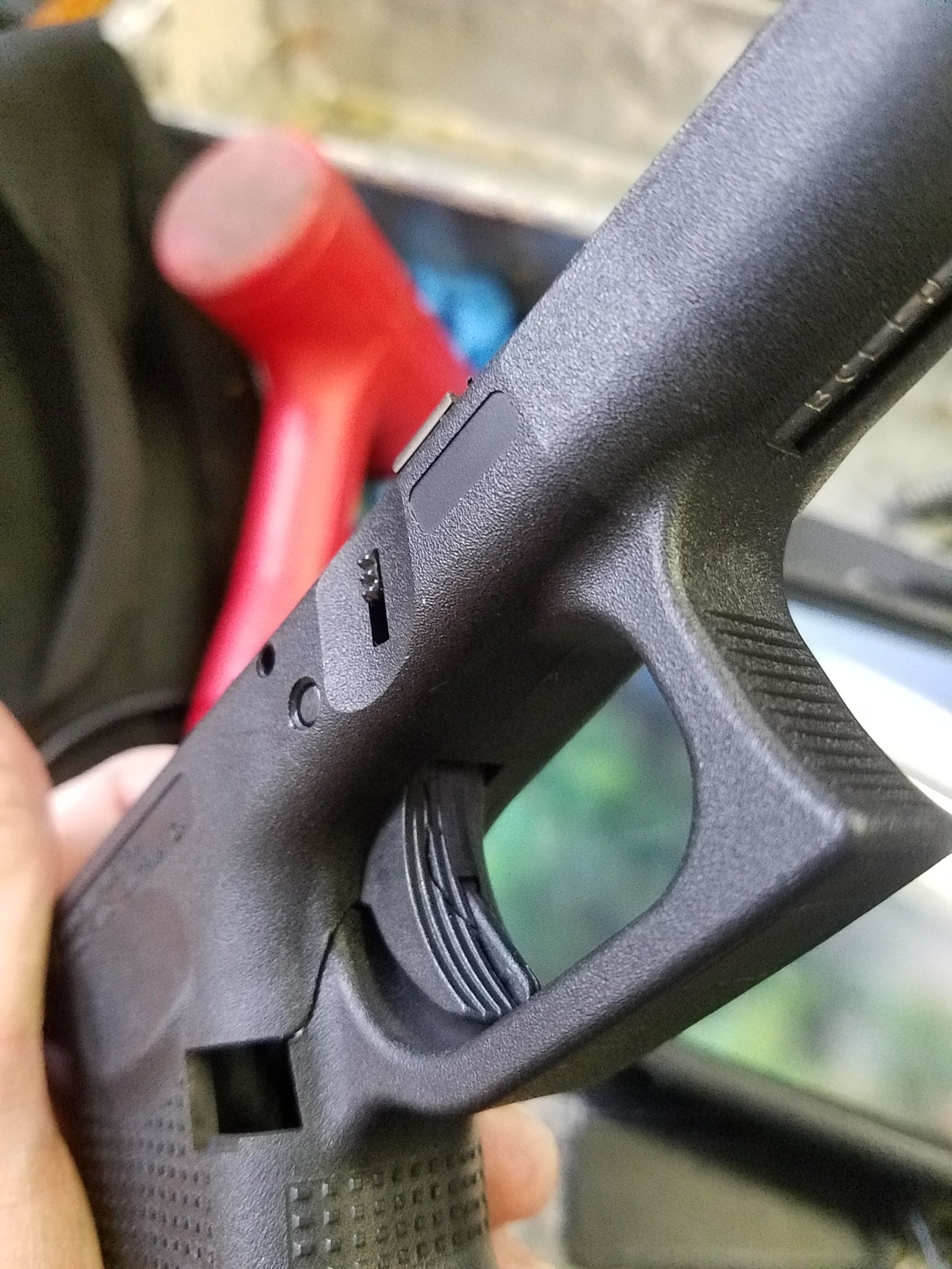

Took a trip to the range with the wife today and had a bit of a mishap. I fired about 7 or 8 rounds of 9mm reloads (berrys 147gr plated over 3.2gr titegroup with cci500 primers) and BOOM! Blew the mag out, cracked the frame, and my trigger finger hurt like hell! When I regained my composure, I attempted to figure out wtf.... Slide was locked up and would not budge. Decided to call it a day (had other pistols but the wife was nervous). Got home and ran the borescope down the barrel and it was clear and I could see brass in the chamber. Clamped the slide in the vise and hot the handle with a compothane hammer and was able to disassemble the pistol. The attached pics are what I found. Just wondering what any of you thought may have caused this. I have a theory but not sure if I am right.
Thanks

I ran a double charge of titegroup with a hornady 147FMJ in Gordons Reloading tool app and it came up with over 100,000 psi
where 3.2 titegroup is fine.
You need to review your reloading practices.
Were these loaded on a progressive machine?
Edit: You are real lucky, you almost had to learn to spank the monkey with your left hand.

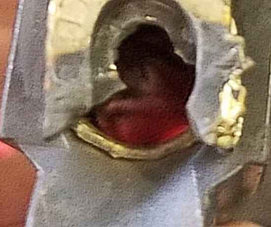

Also, factory glock barrel doesn’t fully support the case. Not ideally suited for handloaders.
I've seen where the glock can fire when not 100% in battery an blow exactly like that. All on reloads. Those were the earlier Glocks, haven't paid attention to any of the later versions.
I don't remember, is that a fully supported chamber?
Powder Burns appears to answer the previous question
Thanks for the replies. Double charge was my thoughts as well. I have loaded thousands of 9mm on the Hornady progressive with no problems, till now. That load is my pet load as it just makes power factor and shoot pretty easy. I must have gotten careless on this one. I use the Hornady powder cop die when loading just as a backup and visually look in the case too. Somehow I got careless.....My problem is I have a couple thousand loaded already and I am not sure if I can trust them or not. I weighed a couple hundred loaded rounds tonight and they all seem close to the same weight. I put the slide back together and reassembled the gun and it appears to function. I think I can replace the frame and trigger and have a gtg pistol again. My trigger finger feels like I hit it with a hammer but it's is still there!
If it's a load that you're go to round that you've never had any real issues with before it's seriously doubtful that's the problem. Firing out of battery is a known issue, especially with reloads.
As you can see with the factory Glock Barrel it doesn't take much at all

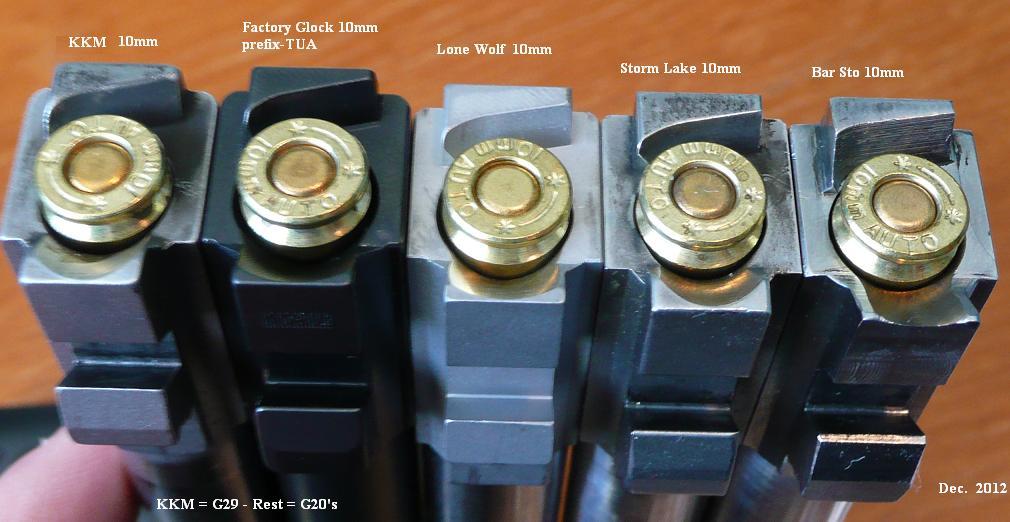

Go post this on a more pistol-oriented forum like Enos and they'll all say the same. The 'unsupported' thing many like to jump to isn't what's at fault here.
Not to mention the 9mm Glock barrels aren't unsupported like the old G20's in the picture above. I have a KKM G20 barrel and it has the same support as the Gen 4 G20 barrel it replaced. I run 10gr of Longshot under 180gr Gold Dots and the factory barrel is identical to the KKM barrel.

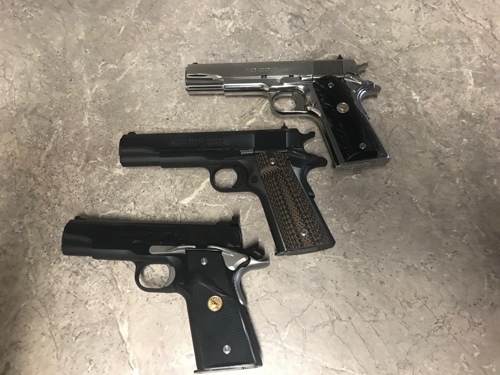

Hmm i have several thousand ( lots of thousands) round run through my 1911s in 9mm and 38 super never an issue with reloads.

Colt 1911, or another manufacturer? A ramped barrel like wilson/kimber/dw/sti uses makes a difference. I can run 38s 125gr gold dots at 1450 in my dw, looks perfect, same load in a buddys colt 38s looks bulged badly. 10mm in ramped vs colt non ramped is the same. Might not be as drastic with factory 10mm that is loaded to warm 40sw level, but with Buffalo bore or equivalent handbags, those colt non ramped barrels show a nasty bulge.
