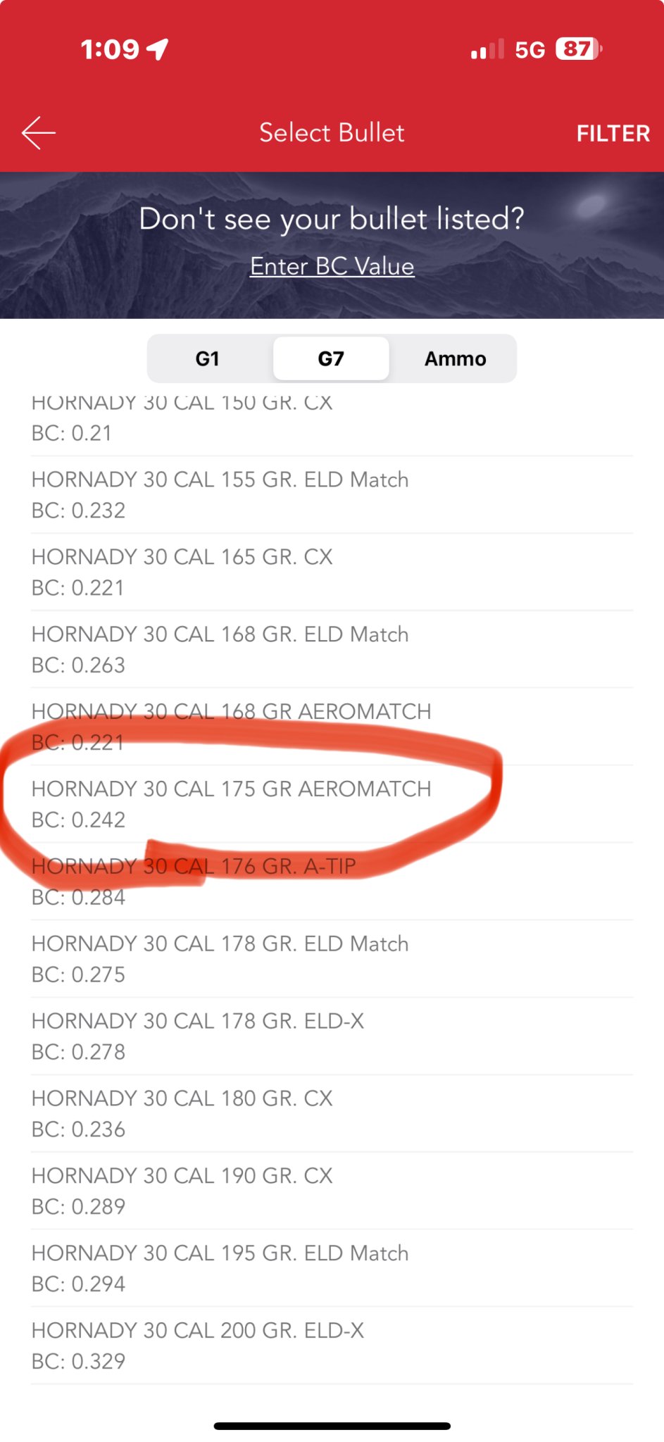

G5 from the software I’m looking at is for shorter boat tail bullets. G7 is for longer heavier “VLD”.
