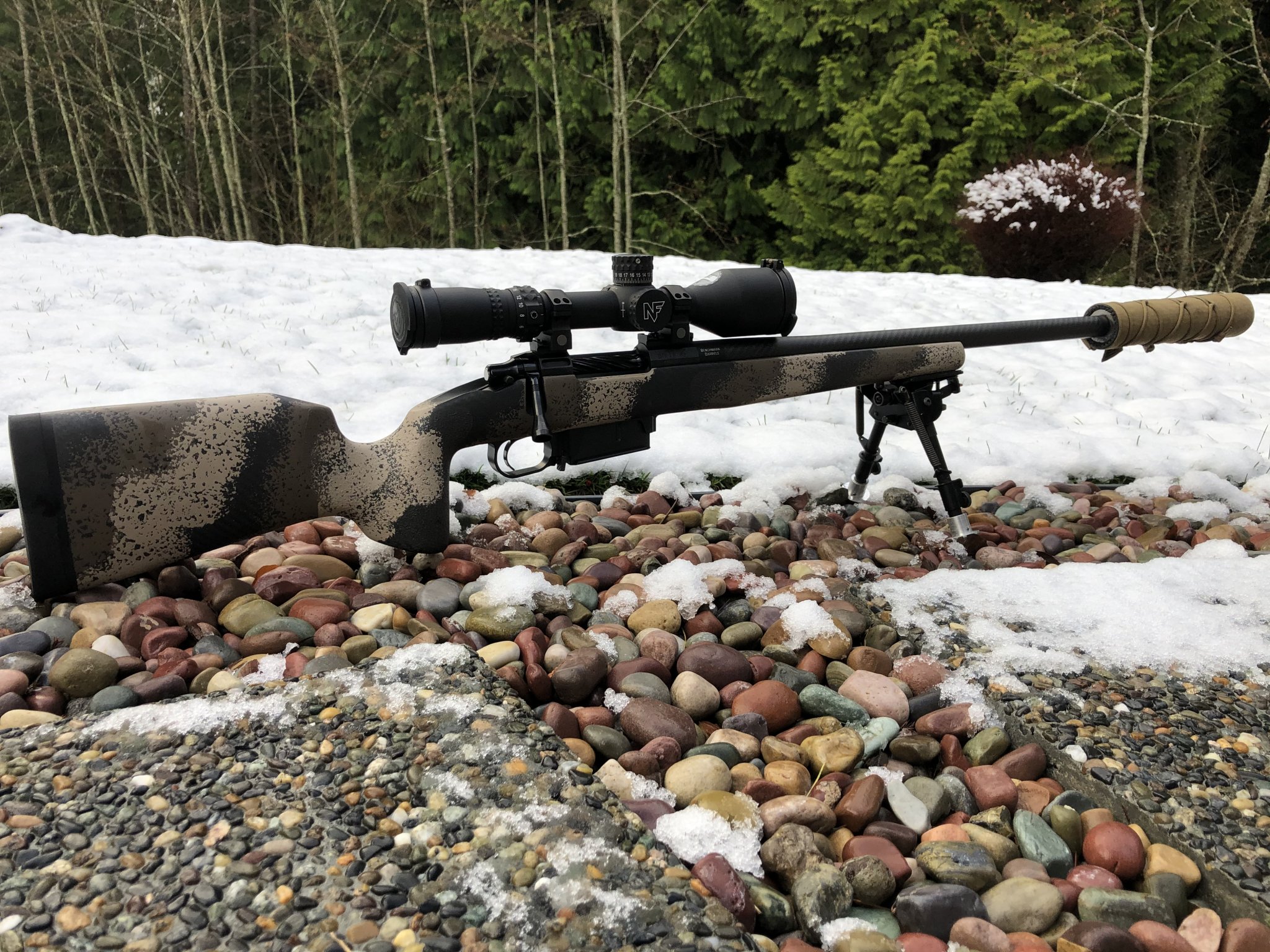

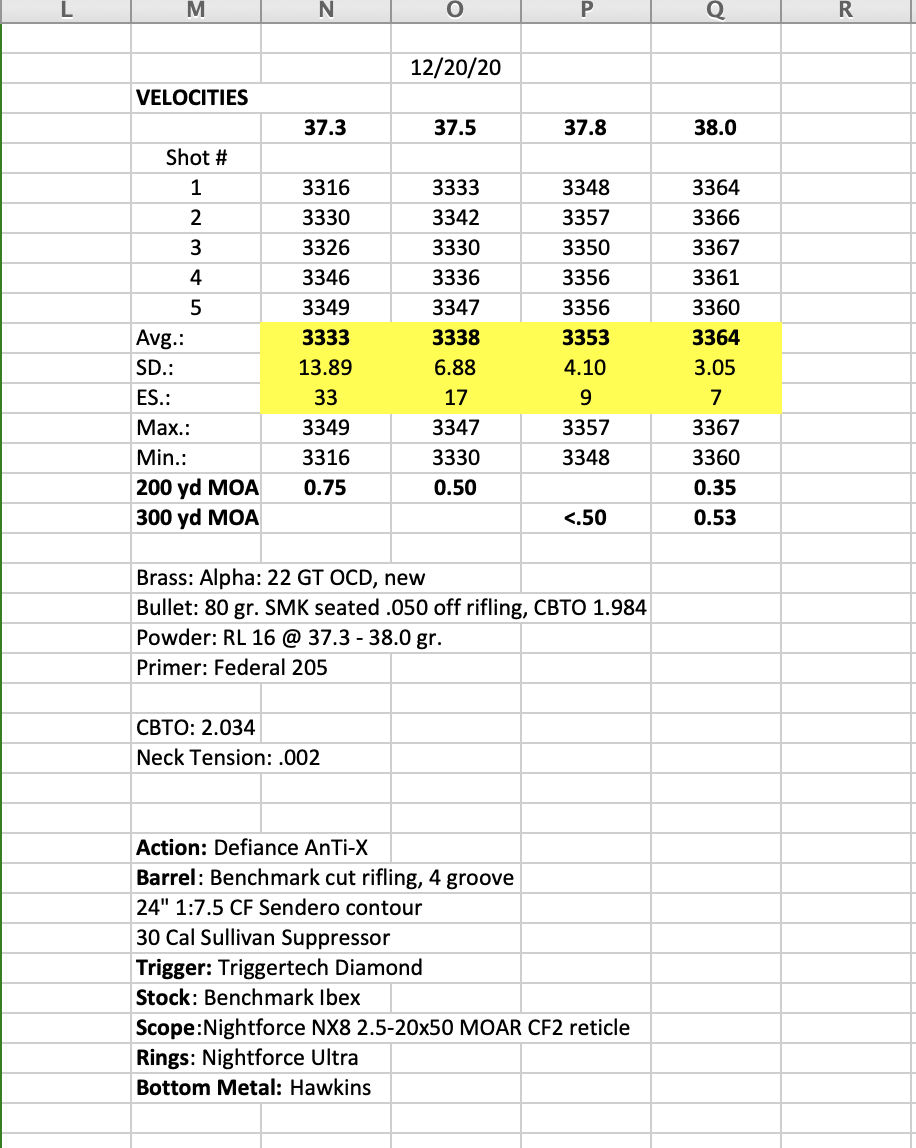

Since mid-summer been doing extensive work on the 22 GT in different Benchmark Barrel builds for the sole purpose of building an Idaho backcountry wolf gun. Couple observations that are my opinion only based on recent personal experience: in a 1:7 twist barrel, some of the premium 77-85 grain match bullets will blow up especially from a clean or hot gun. Since I don't believe in providing a wolf a warning shot, I've gone to a 1:7.5 twist barrel and have not experienced this with the same load/velocities. BTW, these same bullets shot out of my 1:8 twist 22 Creedmoor perform as well. I didn't start load development until the barrels were broken in and velocities plateaued off. Both guns between 140-150 rounds. Steel barrel gained 123 fps and the carbon fiber barrel 117 fps. Loading was done with Alpha brass on Hornady 6 GT Match Grade dies using .249 & .250 bushings and the 6mm GT seating stem replaced with their 22 cal 75-80 gr. AMAX/ELD-M seating stem. Load data and performance speaks for itself but as a disclaimer, this was from my guns only so start at least 2 grains lighter and work up.
Those are impressive speeds for the small case! I'm building a 23" 8tw 22 creed to shoot 75-85gr bullets for large predators myself. I will be running H1000 for case fill and to keep ignition temps cool, hoping the throat won't move too quickly. Did Mike build that rifle? Just curious as he uses a lot of those Ibex stocks and he's local to you.
It was mostly Ron who did most of the work on the build. H1000 should work well in your 22 Creed and you should get decent barrel life relatively speaking. Good luck.

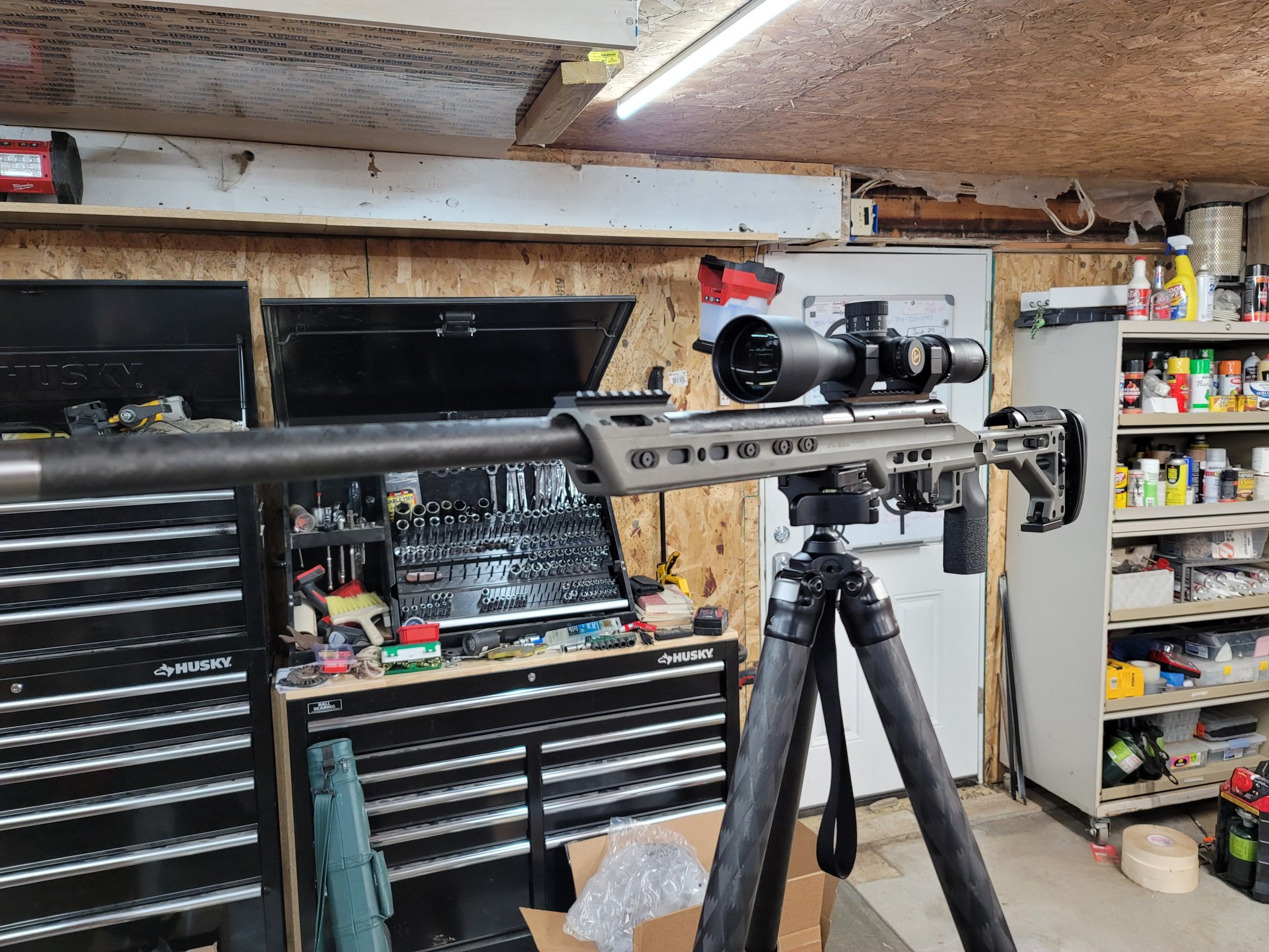

I did just that but in 6GT. It's still got stupid low recoil, and shoots very well. Only thing that will hurt me in a match is calm wind. Mirage off the barrel is crazy but I have ordered a Mirage cover just in case.
