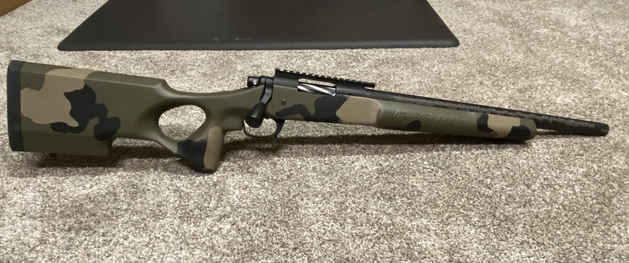

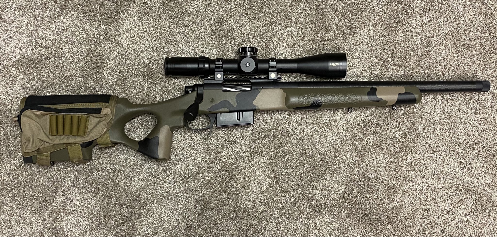

These two are almost twins...on the left is a 22 CM 16" #4 Bart, TT 3-15X50 LRH scope.

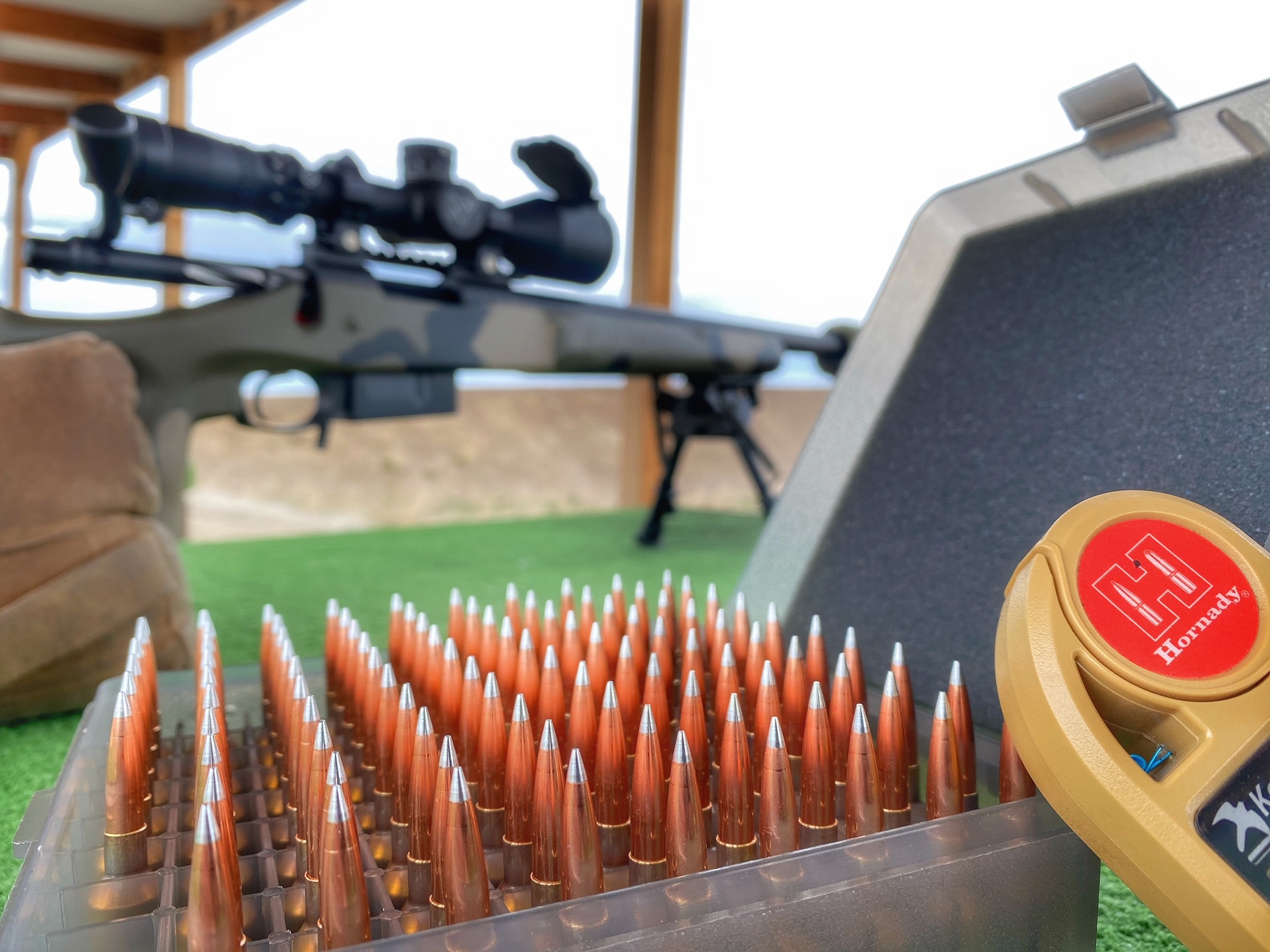

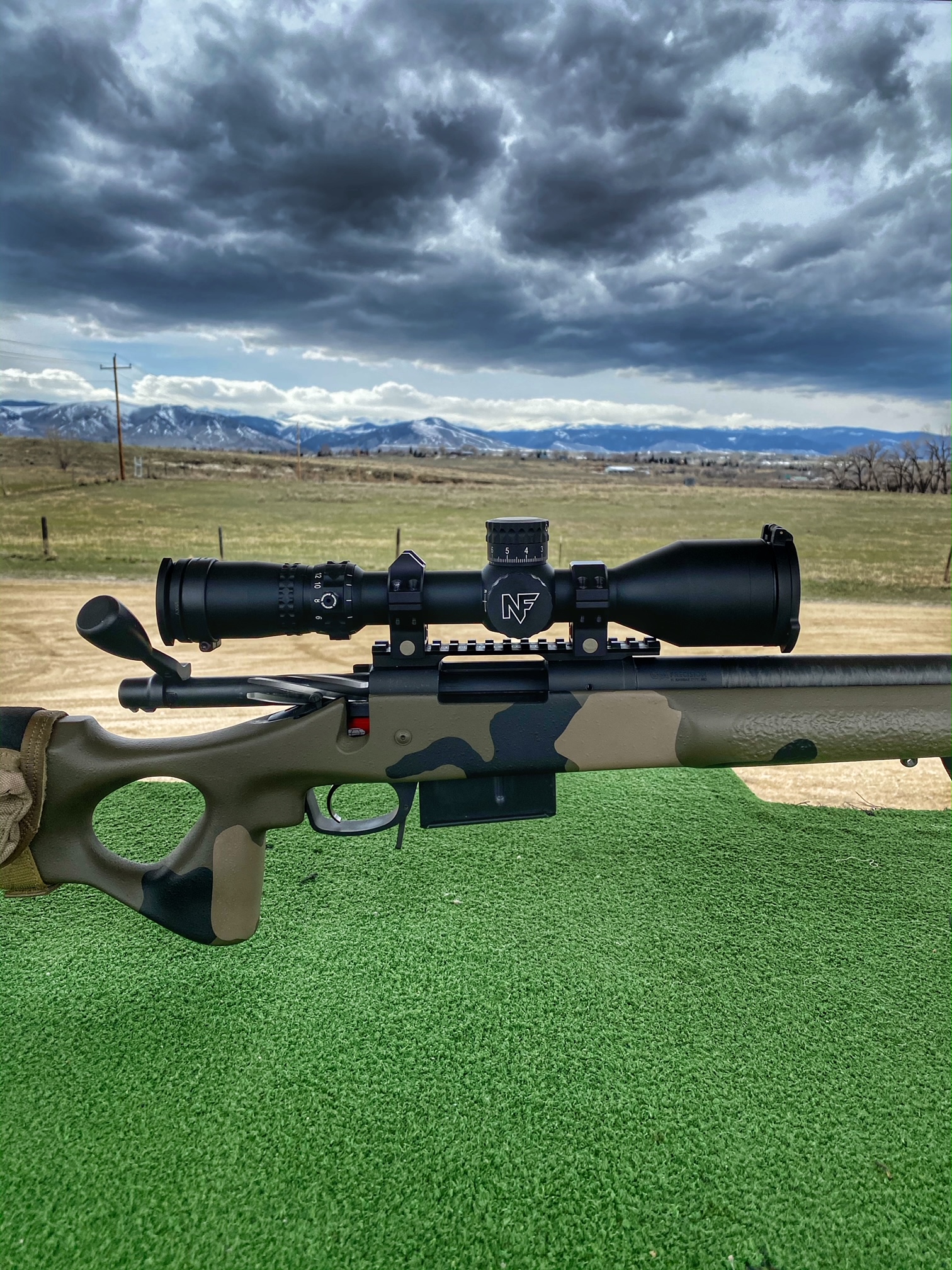

Got in some really good cold weather testing last week, shooting in temps down to -24F. I learned a lot about small rifle primers in the cold...

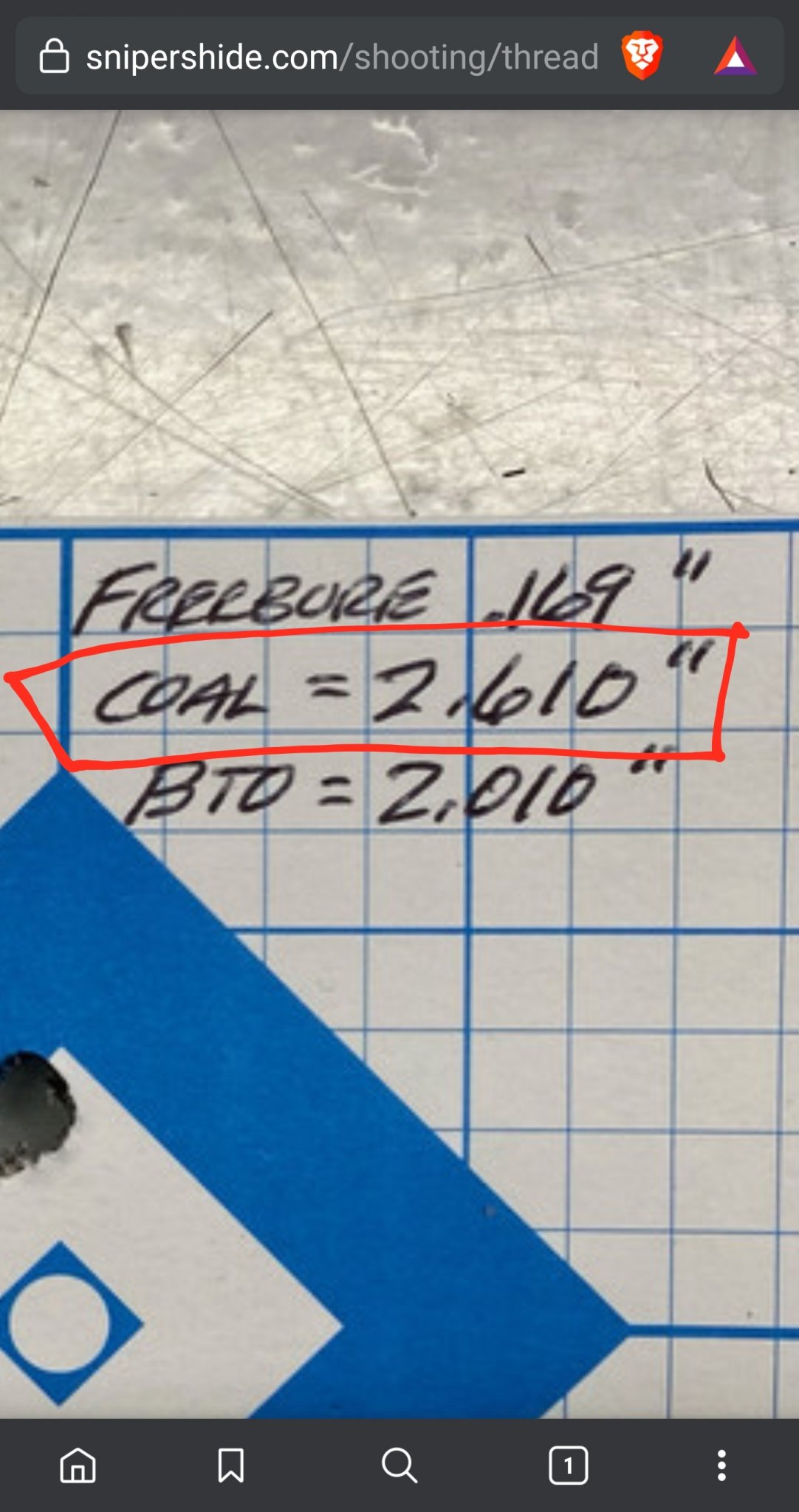

OAL length from tip to base?? Looks fun!
COAL = Cartridge Overall Length

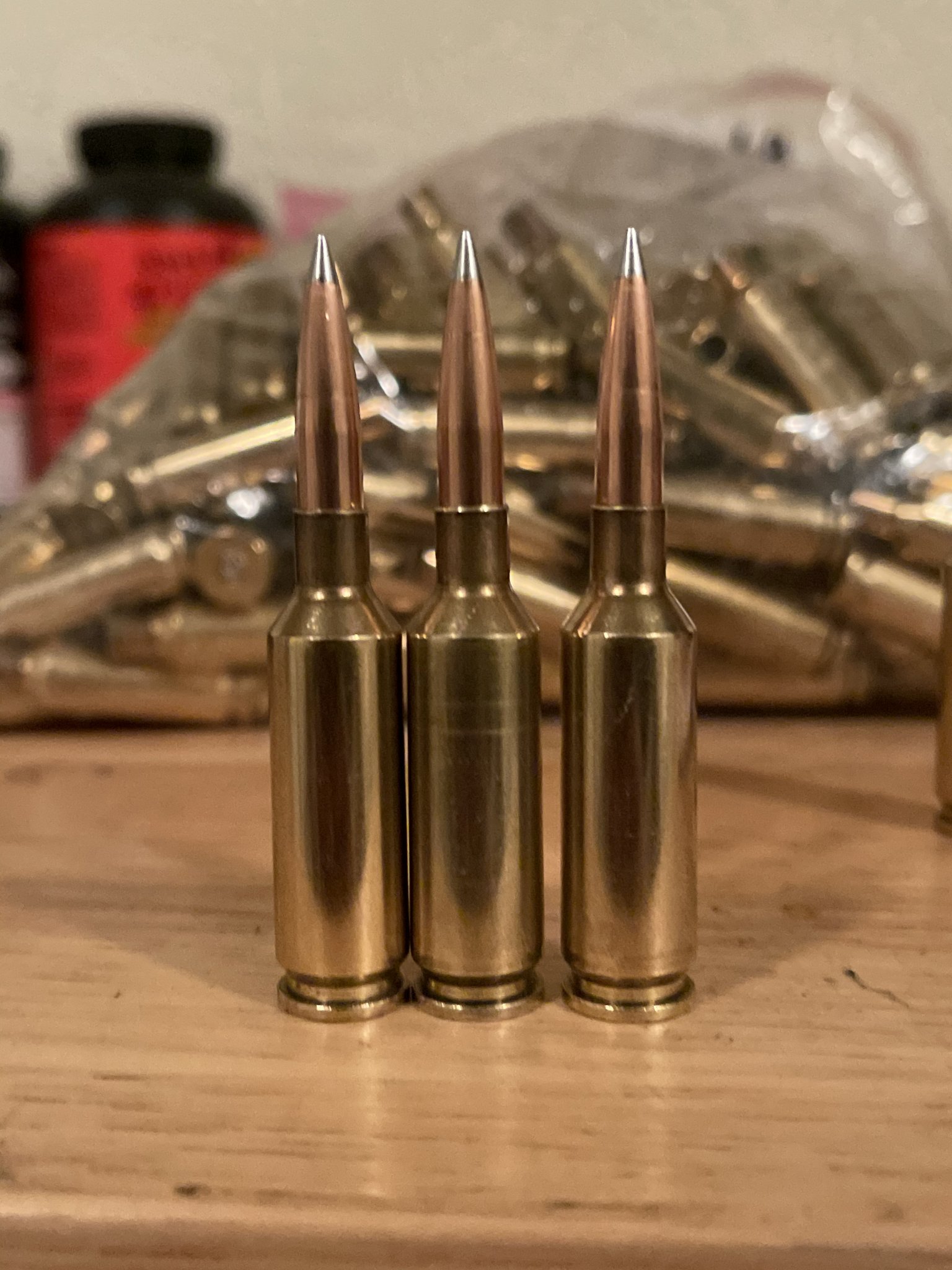

Barrel will be here Thursday according to UPS. Reamer is at the shop. Need brass and dies to make a dummy round for the smith. Hopefully Alpha will have the brass out soon. Dies I’m not sure what I’ll go with.
ETA: Ordered the Whidden 6GT FL bushing die with a 0.249 bushing.
Got my brass in, necked down, and dummy rounds made. Excuse the rings on the bullets. Used the wrong seating stem in my Short action customs seating die initially. Barrel, dummy rounds and rifle will be dropped off Thursday!
