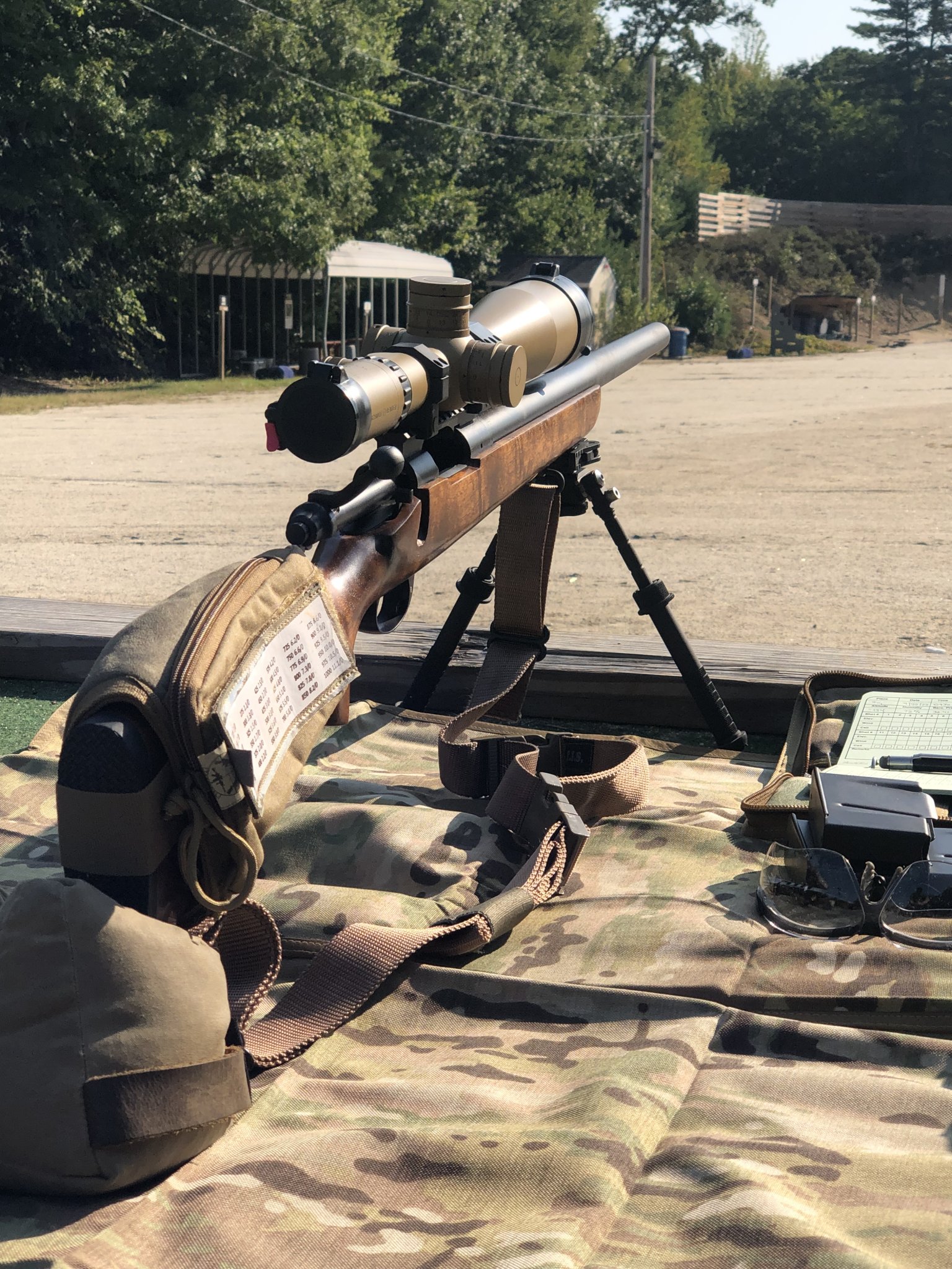

Finally got mine out past 300 yards.
It shot well and now just has over 200 rounds. It may still have some breaking in.
I wanted to FAFO so I went 9.5 to 8.75 lhgt.
It’s a .308 and I was shooting 175 FGMM.
It doesn’t give me the confidence of my 11.25 rh .308 but we may need to get to know each other better and I am shooting a lot less than I had been.
At 750 pretty beat up from recoil and a long day it was hitting the steel plate consistently if not in a fist sized ball.
