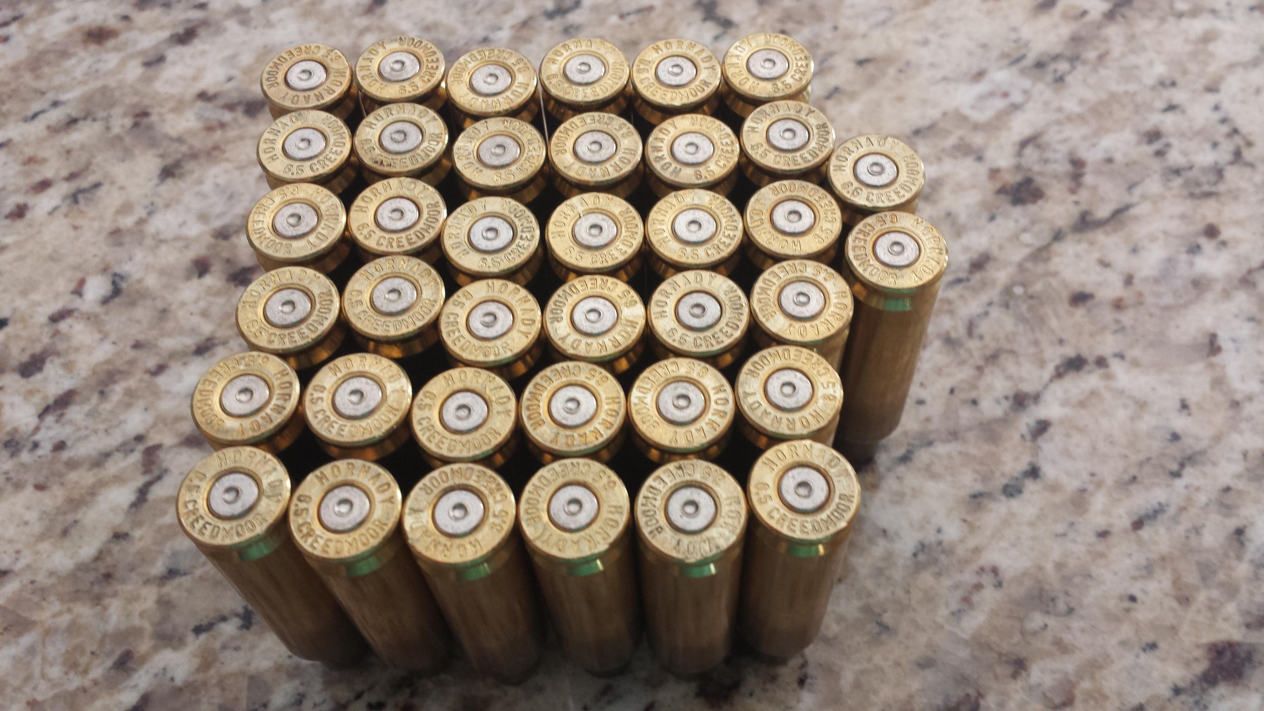

Here's a picture of fired brass from my last range trip. Shooting factory Hornady 140gr amax out of my gap10. I've never experienced any pierced primers but have always had some mild cratering. Does this brass show anything I should be concerned with?
I definitely see some cratering, but that's all I see at a quick glance.
If you had pressure issues, your primers would be flattened on the edges. You'd also probably be seeing some heavy ejector swipes from the gun unlocking prematurely.
I'm of the opinion that your primers look like any commercial primer suitably ignited by a mil-spec diameter 0.080" firing pin.
