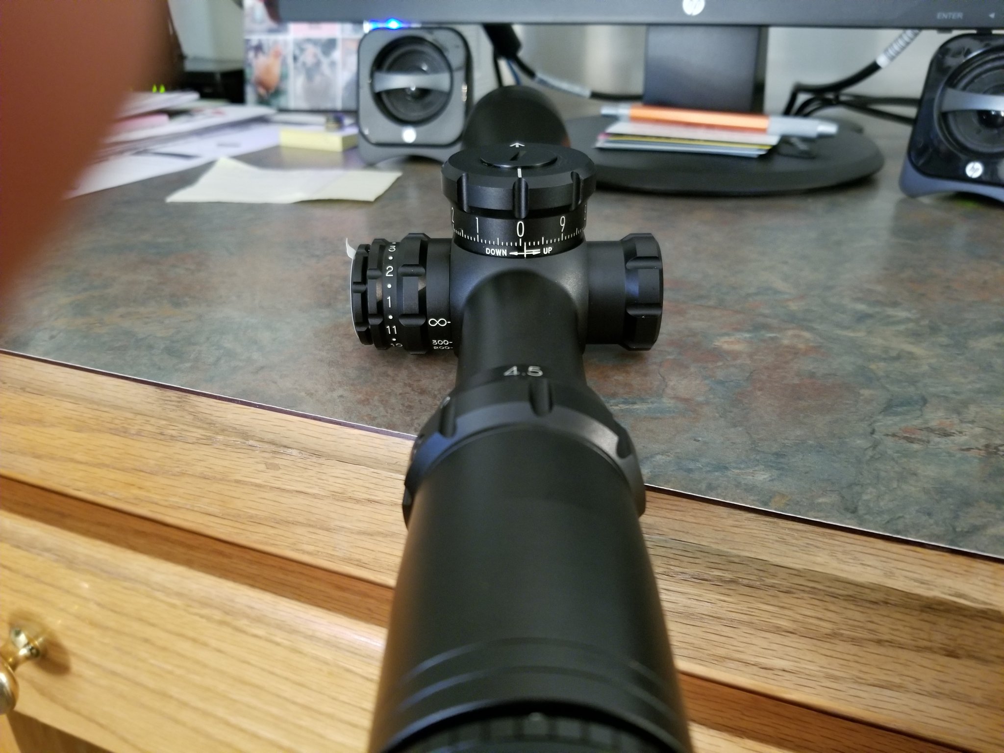

Just got mine. When the white arrow on the elevation knob points straight the zero marks on turret and scope body don't line up. The mark on the scope body is off, the knob seems to be ok. Being zeroed and the arrow pointing off will bug me. Calling Bushnell Monday. Oh well. Seems like nice glass playing with it. Thanks GAP for the deal. I think Bushnell will get me taken care of.

Just got mine. When the white arrow on the elevation knob points straight the zero marks on turret and scope body don't line up. The mark on the scope body is off, the knob seems to be ok. Being zeroed and the arrow pointing off will bug me. Calling Bushnell Monday. Oh well. Seems like nice glass playing with it. Thanks GAP for the deal. I think Bushnell will get me taken care of.View attachment 6936196

In the above photo, it looks like the elevation turret is fine but the scope body was engraved wrong. If you ignore the turret and look at the scope tube, you can see the markings are not centered.

Yeep, just checked, the knob is correct, the marking on the scope body is wrong. This will have to go back.....and I just zeroed...fuck
I feel your pain. I wish the arrow wasn't on the top of the turret. I could live with the scope marking being off a little but that huge arrow pointing at 11:00 is more than my OCD can handle!

Just pulled mine out of the box, and the arrow on mine is off too. The arrow does not point straight down the scope body. It's very slightly pointed towards the right off of zero, or a lot pointed towards the left on zero. I'm not really sure what to do about that.

I just noticed on mine, when the elevation turret is on zero, the arrow is not all straight forward to the objective bell. It is just slightly pointing left. Not too bad tho. If I go one click in the direction that it needs to go, it aligns completely perfect. Oh well, I'll just keep it as it is!

Reached out to Bushnell about the zero alignment issue. They were super helpful. The area where the engraving is off is actually not on the scope tube. It is a seperate part they called the indexing drum. Should be an easy fix I was told.
Shit happens I guess. At least they are making it right. They were aware of this thread and saw my pic posted. Thanks Bushnell and GA Precision.
