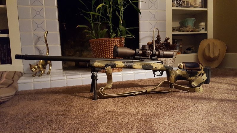

I'm trying to find a Factory ammo load that will shoot out of my GAP Remington 700 .300 Win Mag 24" Bartlein MTU barrel. I've tried ABM 185 Jug OTM that shoots really good, but it absolutely hated Hornady 195 BTHP Match, Hornady 200 ELD-X was horrible. I have some Black Hills 190 SMK coming tomorrow and would guess FGMM 190SMK is pretty close to the Black Hills. I'm currently not reloading but have started collecting equipment to start.
I did not have any custom specification on how this rifle was chambered so I'm guessing they just used a SAAMI spec chamber. Anyone have GAP rifle in .300WM can give me any advice on a load/brand that shoots nice?
Yes I got it directly from GA, but without getting into it about GA, if I never have to deal with them again I would be happy. They built the barreled action and chambered it. Jon at 419 finished it.

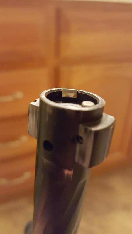

Shot the Black Hills today and they did ok, nothing spectacular. Broke an edge of the friggen extractor. It's still functional. PTG bolt with 60 rounds and the extractor breaks. And PTG doesn't even stock them. You have to order it. I found one at Midway for freeking $50. I worked out a couple other bugs fine tuning the set-up (moved the scope back a slot) and hope to do better next time.
I contacted PTG but have not heard back. Can anyone confirm if this extractor supposed to have the edge beveled like this?
I thought it was broke, but on closer inspection it looks to be ground down. Anyone?
I am kind of confused about this. The replacement I received from Midway today didn't fit. It was too wide, which confuses me because I ordered the extractor for the magnum bolt face. Could this bolt GAP used be a non-magnum long action bolt. I don't know the diameter difference between a 30-06'/.270 and a .300WM
Looks like it to me. I bet its to keep your brass from hitting your windage turret. LOL PTG customer service, call back, good one. You mean the owner himself didn't answer and offer to hand wash your underwear?
Ok, thank you for the feedback. I bet you're right with it being a cut for the brass. I looked at my 6.5CM built by Jon at 419 and it has the same cut. Well, I have a spare then. I guess I shouldn't hold my breath on getting a call back. I cringe when having to deal with PTG again. I ordered a bottom metal once from them. I actually called to confirm they had it in stock, they said that it was, so I bought it. After awhile when it didn't show up I called again and was told it was back ordered. So, I cancelled the order and they tried to charge me a cancellation fee. I couldn't believe it. They finally let me off the hook after arguing about it.

"I am kind of confused about this. The replacement I received from Midway today didn't fit. It was too wide, which confuses me because I ordered the extractor for the magnum bolt face. Could this bolt GAP used be a non-magnum long action bolt. I don't know the diameter difference between a 30-06'/.270 and a .300WM"
The angle on the extractor uses the rim of the cartridge to push the exactor out so the entire rim can be inside the bolt face with the extractor snapping over and grasping the rim.
There are two widths of M-16 extractors:
Mini-M16 (narrow)
Standard M-16 (wide)
GAP and many other manufacturers like Defiance, use the mini-M-16 extractor, accounting for why the standard M-16 you ordered from Midway was too wide.Had you called Mark at GA Precision, he could have:
Explained that your picture shows a proper angle on the face of the extractor.
Sent the proper replacement out if you felt at that point that you still needed one.
hohlspitz, thank you kindly for the explanation of the difference between extractors. I'm always learning something new everyday here. I got the right extractor today from midway, so I have a spare. Thank you again!
ETA: Is there a reason why they don't come from the factory with the edge ground down? Is it done differently for different cartridges?
