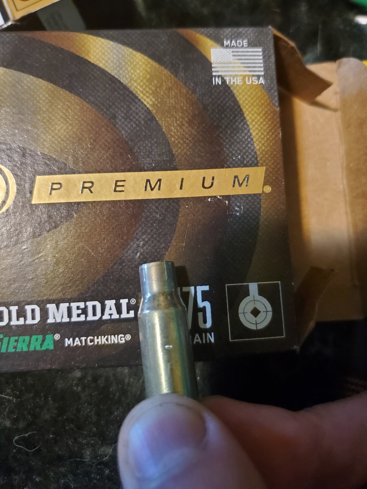

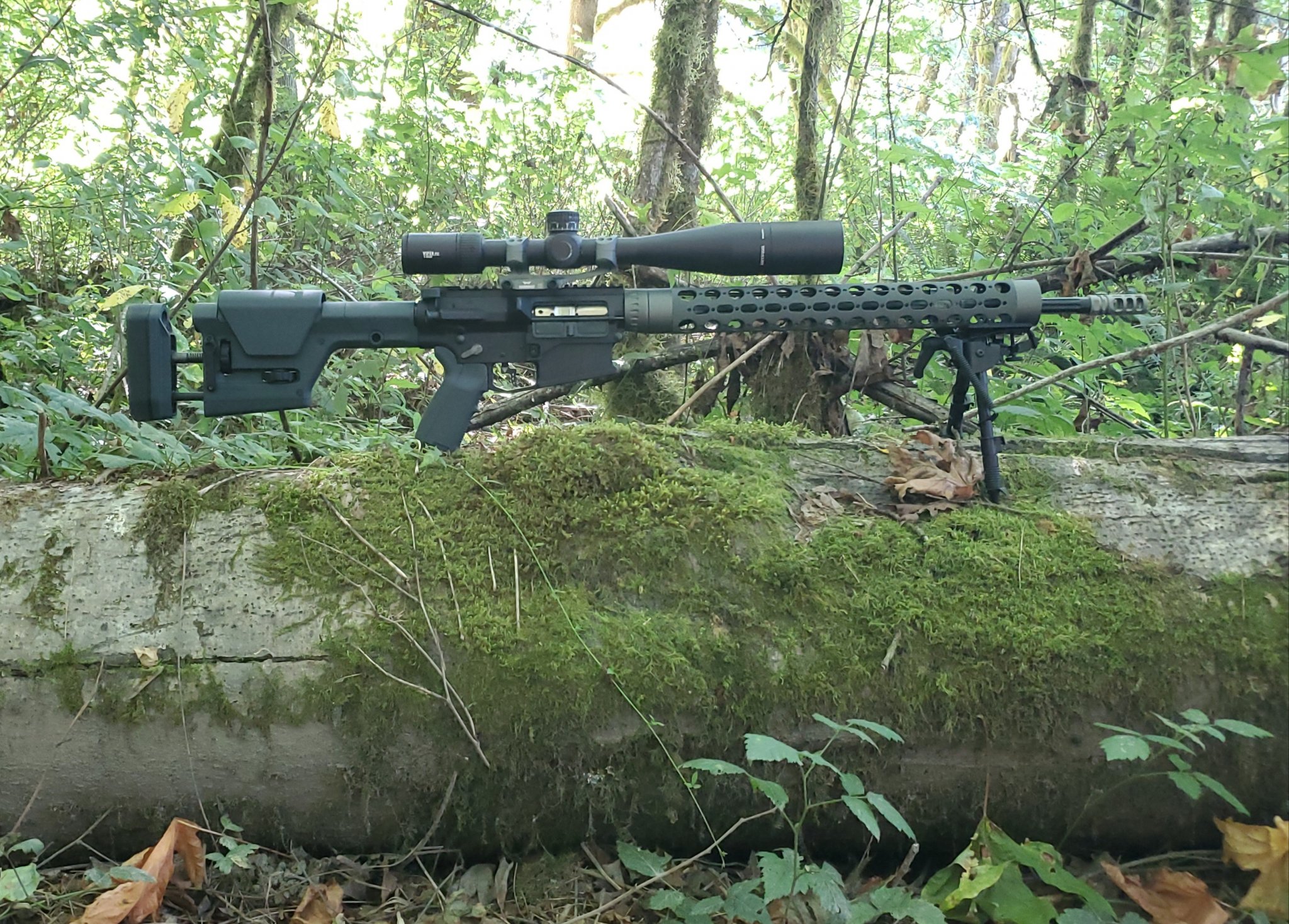

I took my .308 out shooting today for just the second time. The first time out it put 5 rounds in an inch at 50 yards but then opened up at 100 yards to about 2 or 3 inches. I put a lot of the blame for this on me, the walking feet on my harris bipod and the shitty filling in the rear bag I was using. I got spike feet for the bipod so it stays put and I can load it a little and new filling for the rear bag that doesn't just collapse under the slightest of tension. This time my groups were the same as before at 100 yards and I felt far more steady. I noticed that the spent cases have 2 scratches on the mouth from the feed ramps, but otherwise no signs of damage. I've got a Faxon 20" heavy fluted barrel and read a thread somewhere about them sometimes having sharp feed ramps, but people were able to fix them. Im kinda nervous to go at my new barrel with a file or something. Does anyone have any suggestions on this? Or should I even be worried about it?

2moa at 50yds and 2moa at 100yds sounds consistent to me. Chamber a round and dont fire It. See what the bullet looks like as that’ll tell you if the feed ramp being burred is causing your issues or if it’s something else.

If you're not happy with that accuracy, you might just want to try another match ammo as well, see if you barre likes it better.
IMO, large frame gas guns are the hardest guns to shoot precision wise. I don't own one but have shot various rifles over the years and it was always a more difficult time "feeling good" behind the rifle.

The long scratches are not from the feed ramp, but from the sharp corner of the locking lugs on the barrel extension. That’s normal, and may wear in with use. As said above, 2moa is 2moa. Could be you (gas guns are hard to shoot). Could be the gun (gas guns tend to be harder to build accurately, dollar for dollar compared to bolt guns). Maybe it doesn’t like the ammo. Try the fgmm 168, Hornady match is good too. That said, what are your goals for the rifle?
I tried out federal 168 grain and Hornady 178 grain, along with the federal 175s. They all shot about the same. I guess even knowing that a gas gun would be inherently trickier to tune in and get super acurate, being fairly new to precision shooting, I had hoped for closer to one MOA. I don't have many long ranges near me. The longest only getting out to about 600, but I'd like to be able to eventually take it out around 1000.
