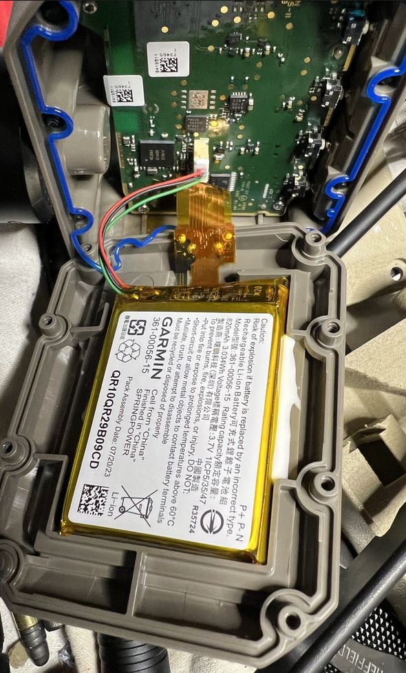

Hey guys with the Garmin chronograph. Mines been eating muzzle blast and has missed a few readings which hasn’t happened in the past. If I shake the housing real good I can hear a rattle almost like a small bb or something’s slightly loose inside. Can anybody shake theirs so I can figure out if this is normal? If you reload with bushings it sounds like shaking your sizing die and the free floating bushing inside rattle

@Awesymoto - No, mine does not rattle no matter how I shake it. Could be a loose screw as @Rocketvapor suggested (but, wouldn't' the screws be steel and hence a source of possible short on the board???), A piece of solder come loose, a little piece of the board broken off, or any other stuff that's in there and breakable. My view is send it back to Garmin for repair before it fucks up further (I assume it’s still working, right?)

It works on and off, misses some shots here and there, I’m going to contact garmin for a RMA soon. Here’s my week in review (Vortex 4000 took a dump 2nd one) Trigger tech Diamond safety stuck on fire (warranty) and now my chronograph. I’m on a streak.

Small update, if I press and hold all 4 buttons it doesn’t rattle, but oddly if I push each individual one it rattles so either the rattle is the switch or something loose?
Quit fucking with it before you possibly fry it. Sounds like it may…may…be an inner mechanical structure for the buttons.

My Xero had a rattle. It was the OK button that had broken off. It was hard to push compared to the other buttons from day one and eventually broke off. Sent it back to Garmin and had a new Xero in less than 5 days. Send it back
