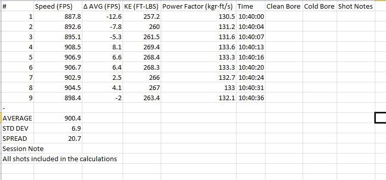

You should be able to download each string of fire as a .csv file from your phone. Go in to the string and export as CSV to google drive, onedrive, email attachment, whatever your phone supports, then open using anything that displays spreadsheets. I notice there's no file extension, so you can add .csv to the end of the file in windows.
Here's a pic of a string from last week 4.3gr VV N320 and a 147gr plated bullet in mixed brass, for the curious. Used to be my go-to for USPSA Production division.
