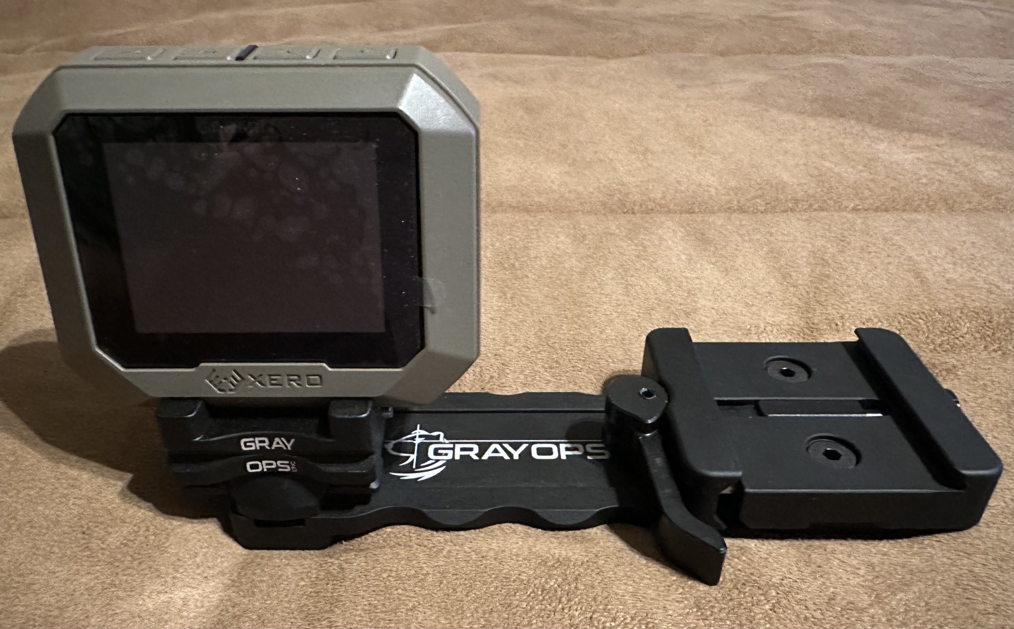

Anyone noticed any unusual effects of being farther than 15 inches back (outside of the recommended alignment window) from the muzzle using a nodal slide?

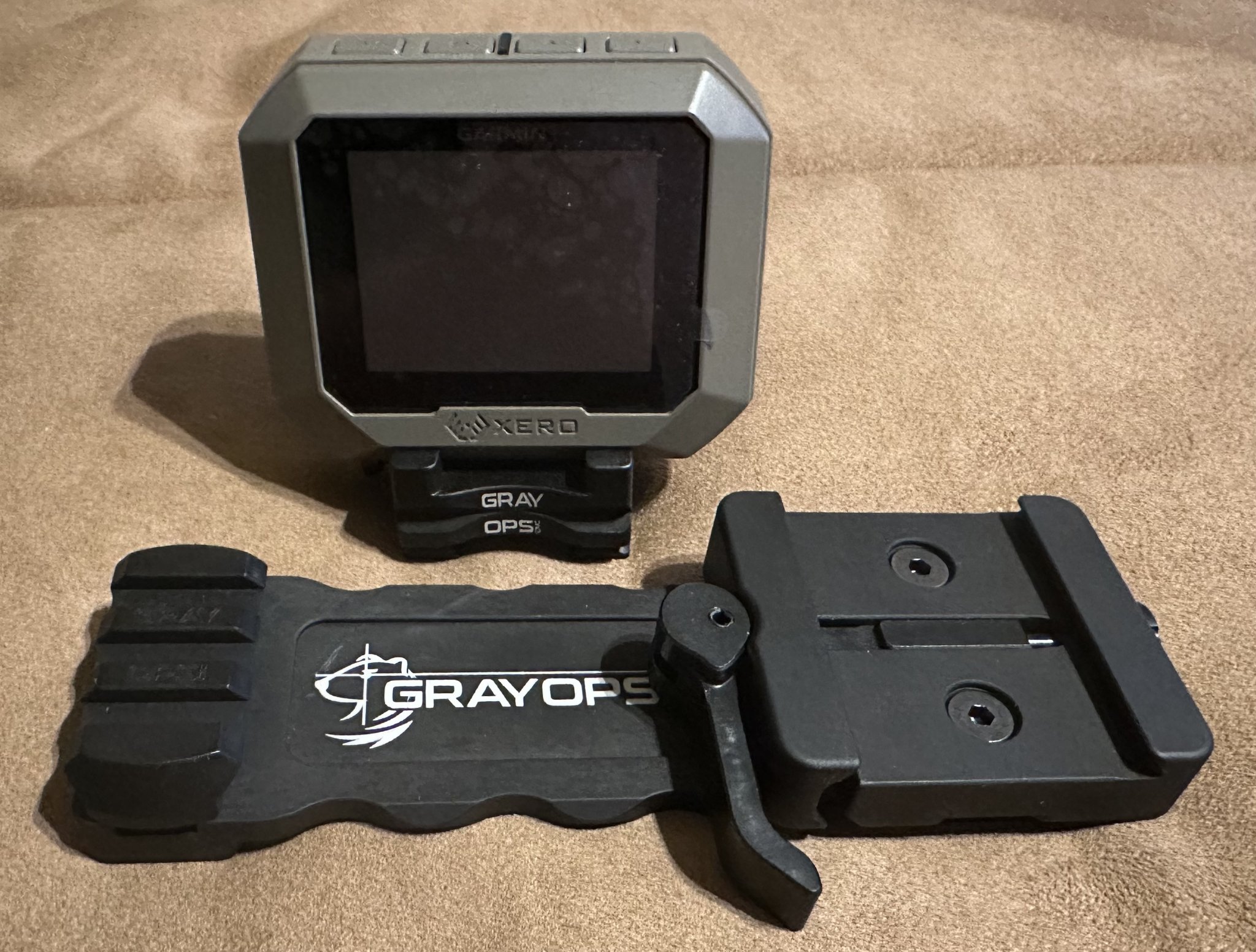

I got the amazon special mount in today
So I'll test this weekend and report back as I still have two that I can compare.
I'll try to video like I did with the 22s placement testing.
Plan is to test one on heavier side as well as lighter side to see if recoil shows a difference either way.
If anyone has some ideas on specific parameters to test while comparing the two let me know.

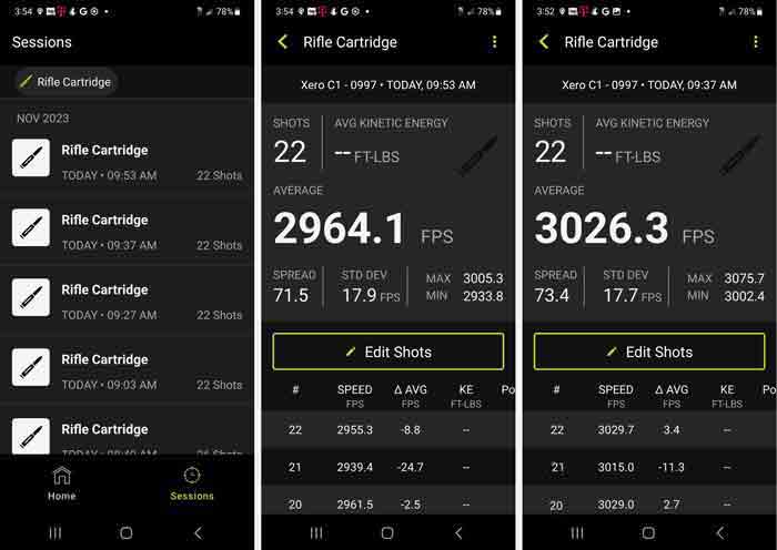

We compared our units today. My friend had his on an arca mount all the way back to his mag well. I would say about 28 inches from the muzzle and I set mine up at the recommended 5”/15” the difference was 4 FPS consistently

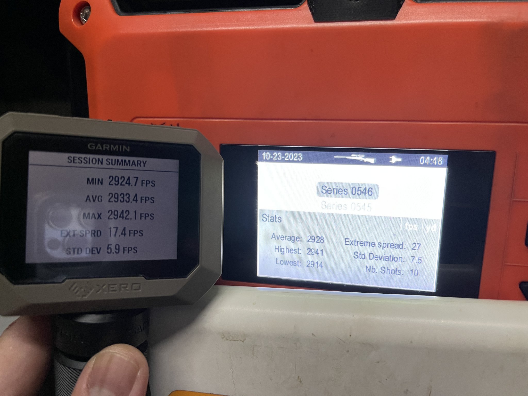

I've seen reports on a few forums and "YouTube" of the velocities being very very close to the LabRadar and Magnetospeed (just a couple fps at most). Part of the 'Clear' distance in front of the Xero may be to reduce to magnitude of the 'Return Signal' off target boards, the berm, etc. in front of the radar antenna. I bet it picks up the bullet long before that. Mounting way back from the muzzle, the barrel may mask part of the signal receiving cone, causing the bullet signal to not show for a few feet.
The Xero may take some flight distance to calculate a velocity and the return from a small bullet can be swamped by a large return or masked by a barrel but I think the recommendation to place the unit 5" to 15" behind the muzzle shows me it's looking for a moving bullet within a few feet.
If you use a calculator for velocity, a 55gr .224 bullet @ 2800fps (muzzle) has lost 7fps in 2 yards, 14fps in 4 yards, 28fps in 8 yards. Are people seeing that much lower readings with the Xero over the LR?
I posted this a few days after release day. My Xero has given me a few FPS faster numbers. I also confirmed yesterday with my rimfire. It was avg 1125 and the LR has given me 1119 with the same ammo and barrel with similar conditions.
As someone mentioned above, does a few FPS difference matter? To me, no. Data gets trued down range. Always.

I've shot 100 rounds of various calibers by the garmin and the labradar at the same time. Just got the garmin last week. The most I've seen so far is a 8fps difference between the two. Everything I've shot has been 6.5, 7mm, and 30 cal. Haven't shot anything smaller by both of them at the same time. Labradar will be going to a good home very soon.
Edited... My garmin has always been slower than LR.

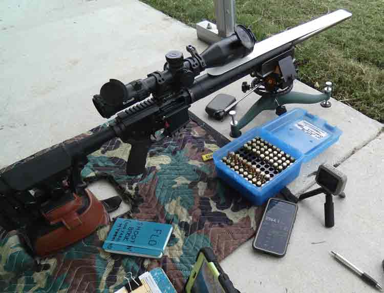

The wife and I made a 600yd F-Class match today.
Set up the Xero (I know it's against the NRA rules) and it did great.
Didn't drop a shot and I tried various positions. Would move it towards my position when I shot and back closer to her when she shot.
Scores weren't terrible and my new barrel has sped up. Guess it's time for some more load work.
Relays on an Android phone.
22 Nosler with 85.5 Bergers. Mine is on the right.

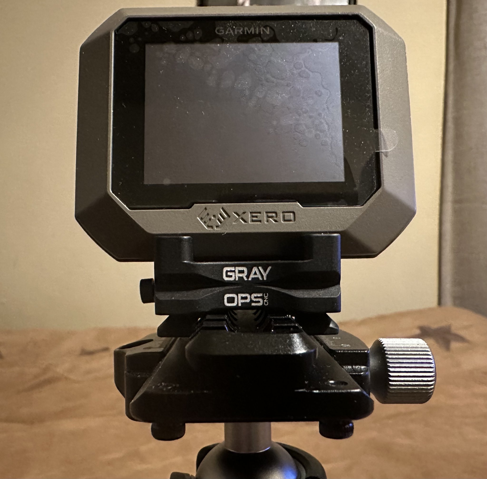

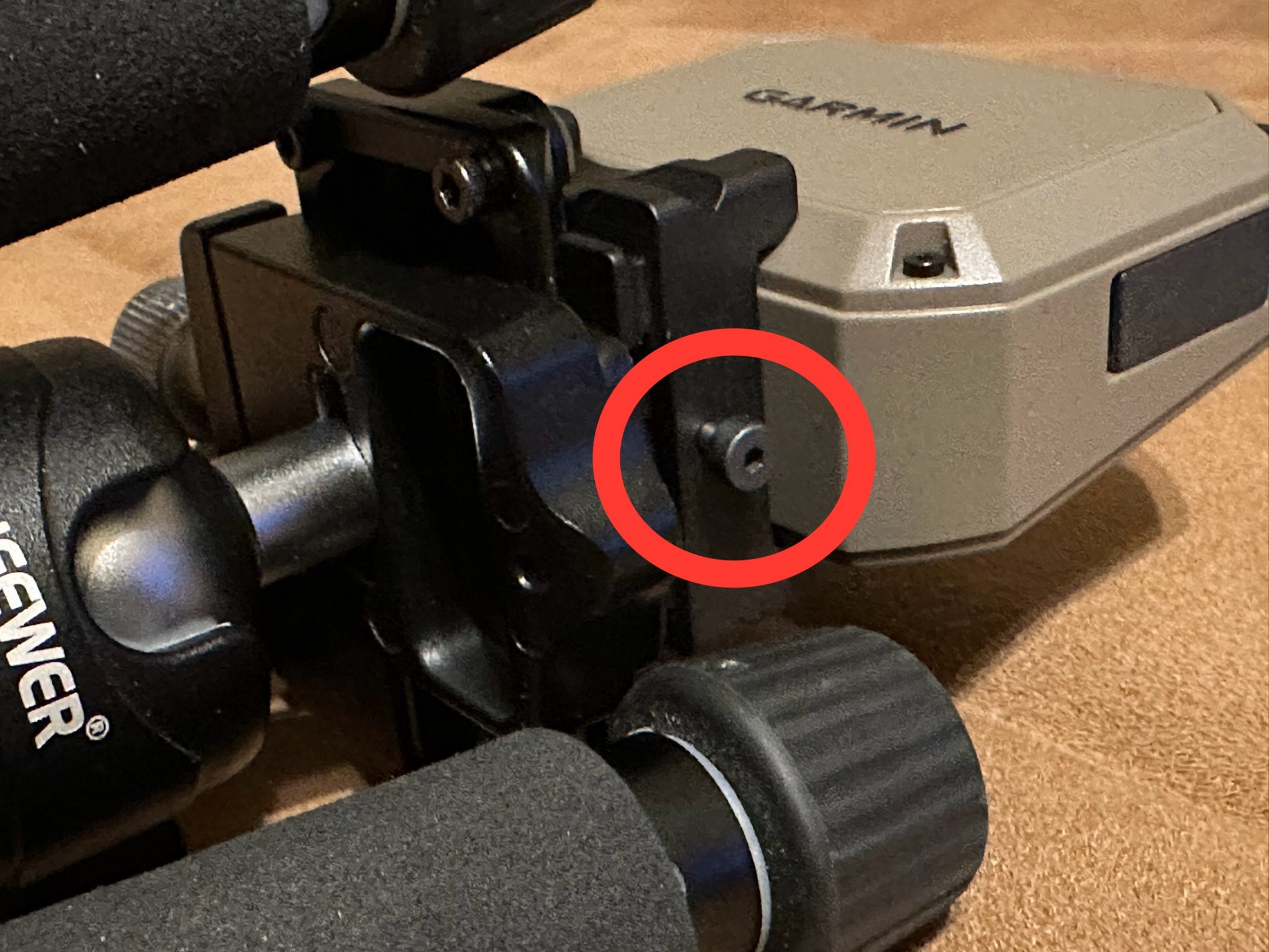

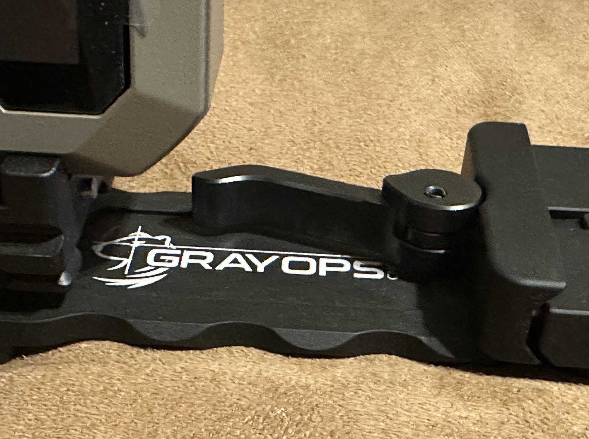

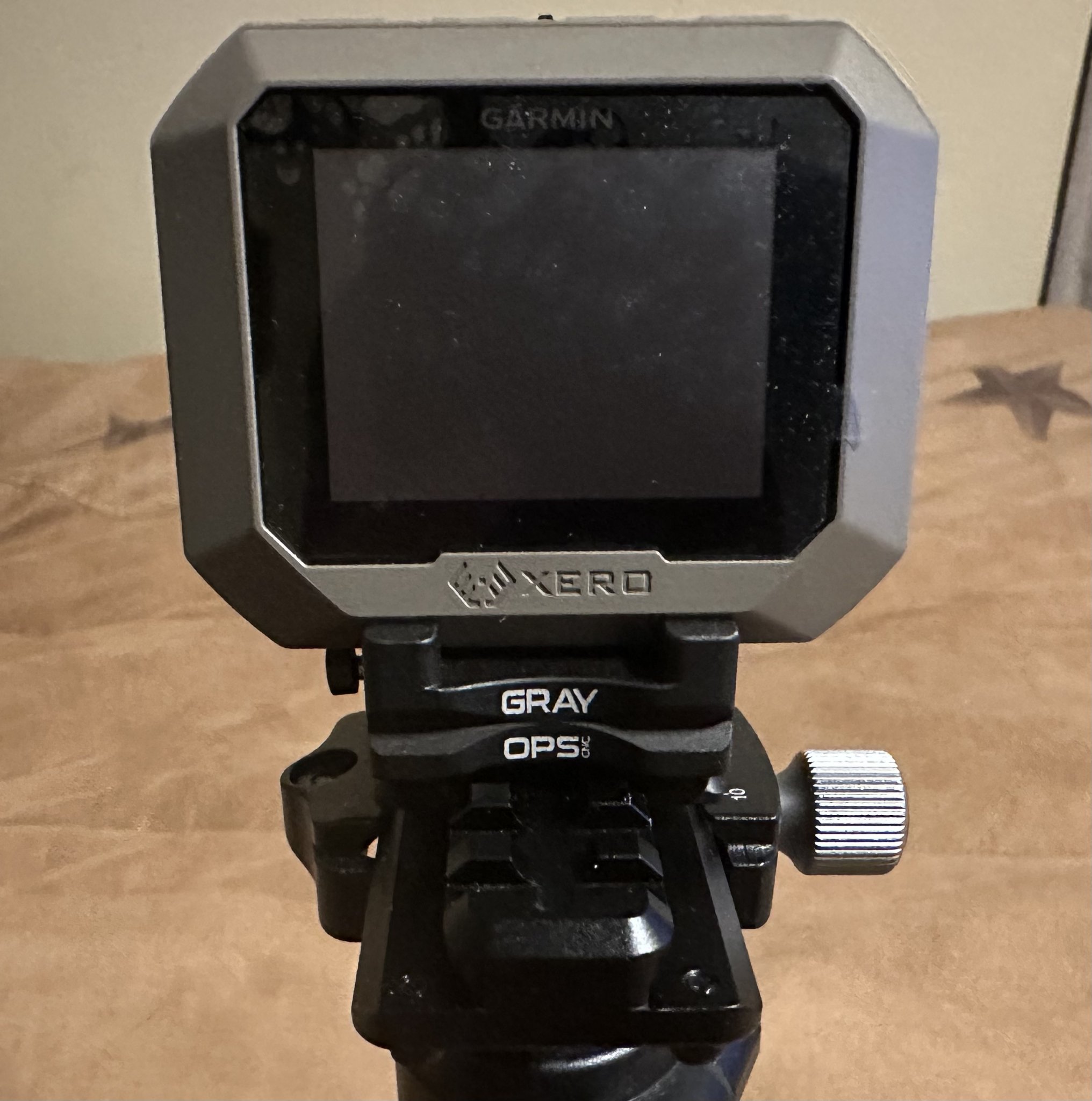

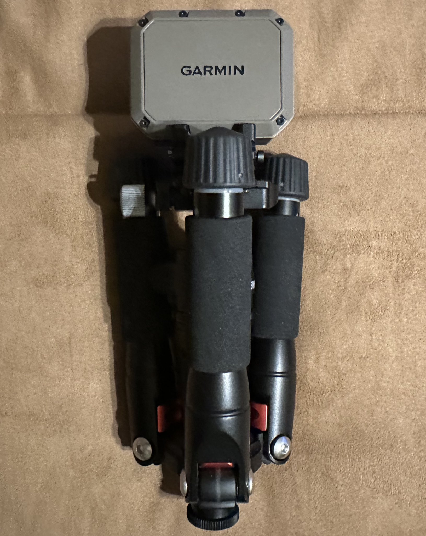

My Grey Ops Inc. Garmin XERO mount showed up today. VERY impressed! Nice clean smooth anodizing. Very nice CNC work. And it was a very thought-out design. I really love the solid-lockup on the QD picatinny setup (circled in red in the pic below). It would work very well on an AR with a quadrail, or a rifle with a pic rail on the fore-end of the gun, or if you want to run it mostly on a tripod, like I will. The QD makes it quick and to remove and reinstall so I can carry the unit protected separately from the tripod in my bag.
I decided to mount my ARCA clamp with the lever on the INSIDE, not the outside (there's plenty of clearance to swing it), so it wouldn't be sticking out and get in the way, and get hung up on anything on the right side of the gun when using it on an ARCA rail. It came disassembled, so I test-fit everything and figured out that it was all reversible, and how I wanted to position the lever (inside or outside). Then I pulled it apart and put some Vibra-Tite VC-3 on the screws and let them sit for about 30 minutes for it to cure so nothing will vibrate loose while using it. Then reassembled it.
So far, I really like the mount. I'll give it a try at the range tomorrow, both on the tripod and on the ARCA mount, so I will see how close and consistent my readings are.
View attachment 8275481View attachment 8275482View attachment 8275483View attachment 8275484View attachment 8275485View attachment 8275487View attachment 8275486
How much is the full kit from them? It's sold out and won't show the price for the whole kit
I think it was like $210 when I preordered mine. IMO, worth it, since I can keep the high-quality QD pic mount screwed onto the unit, and just swap the whole thing around to different mounting options, guns, rails, etc... by pushing a button and sliding it on/off the rail. The convenience factor is off the charts.
I just ordered a Pelican 1060/1062 setup off Amazon, so I can carry everything, including the mount, around in a nicely padded container. The small zip up pouch was nice, but it won't work with the mount, mini-tripod, unit, cable, etc...
