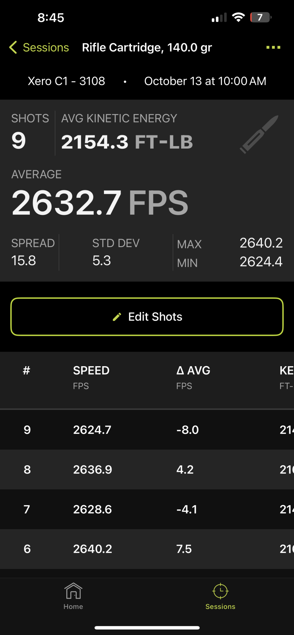

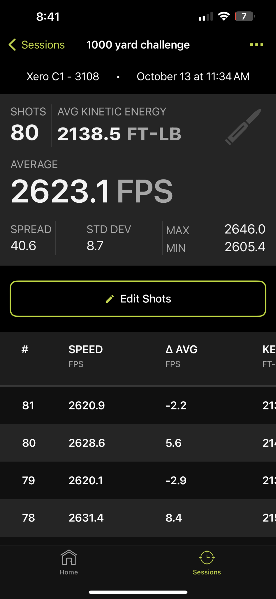

I shot both these sessions using the same ammo on the same day but 40 mins apart. They are split because the Xero went to standby. Is there a way to combine them in the Xero app or device itself?
Thanks!

So, you didn’t power it off and didn’t go into Pause. It timed out on standby and that locked to session? Correct?
If I’m going idle for a while, I pause the session having been locked out after…er, maybe powering off…so I do Pause. I believe that works to keep the session open.
And yes, take them both to Excel and run average and SD there…only thing I can offer.
Reactions: adaptive
Yes, if you Pause the session it will keep it open, even if you turn it off, and you can Resume it once you turn it back on. If you don't, the session is closed when you turn it off (or it turns itself off, apparently). I have not had one time-out on me yet, I didn't know they would even do that. So, it turned off after a certain length of time with no activity? Does anyone know how long before it does that?

After about 30mins of inactivity it first disarms the radar, then after another 10-15 mins of inactivity it shutdowns. By then your session is automatically closed and apparently cannot be resumed. Sucks because where I shoot we group into relays and it takes 40mins before a relay gets to shoot again.
