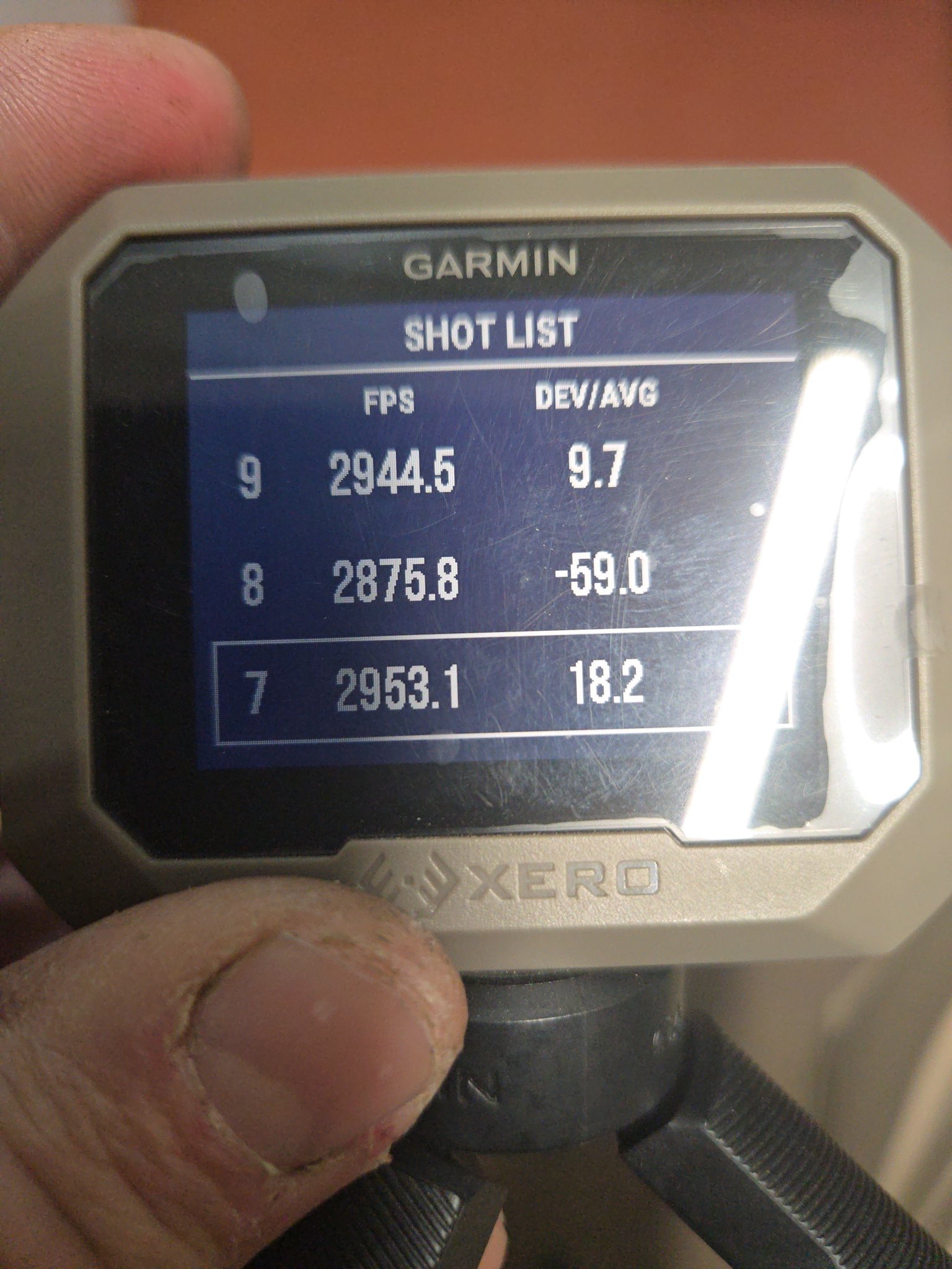

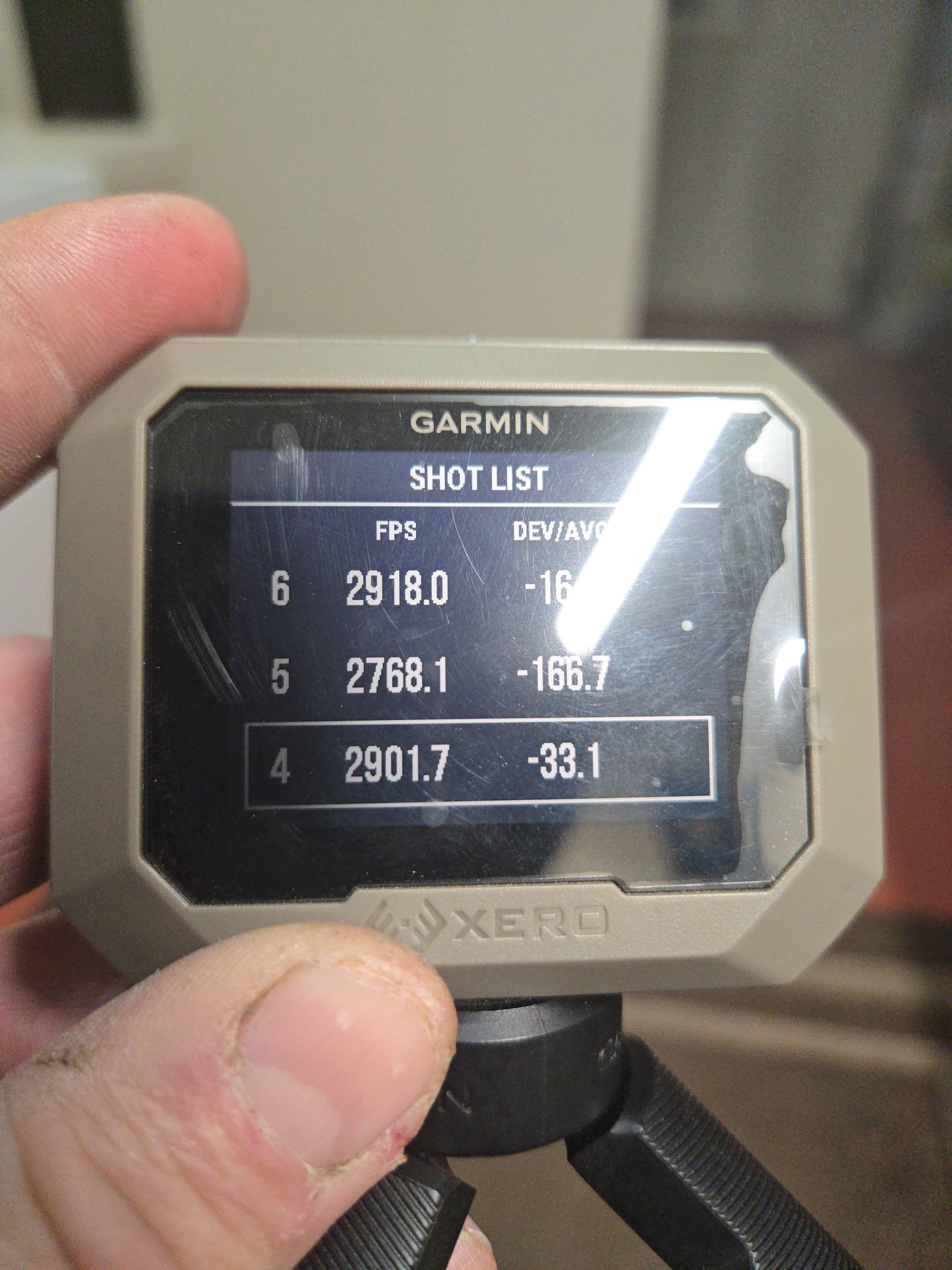

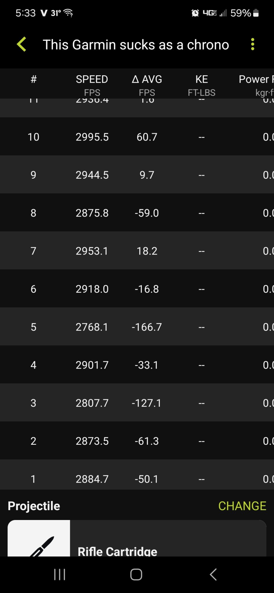

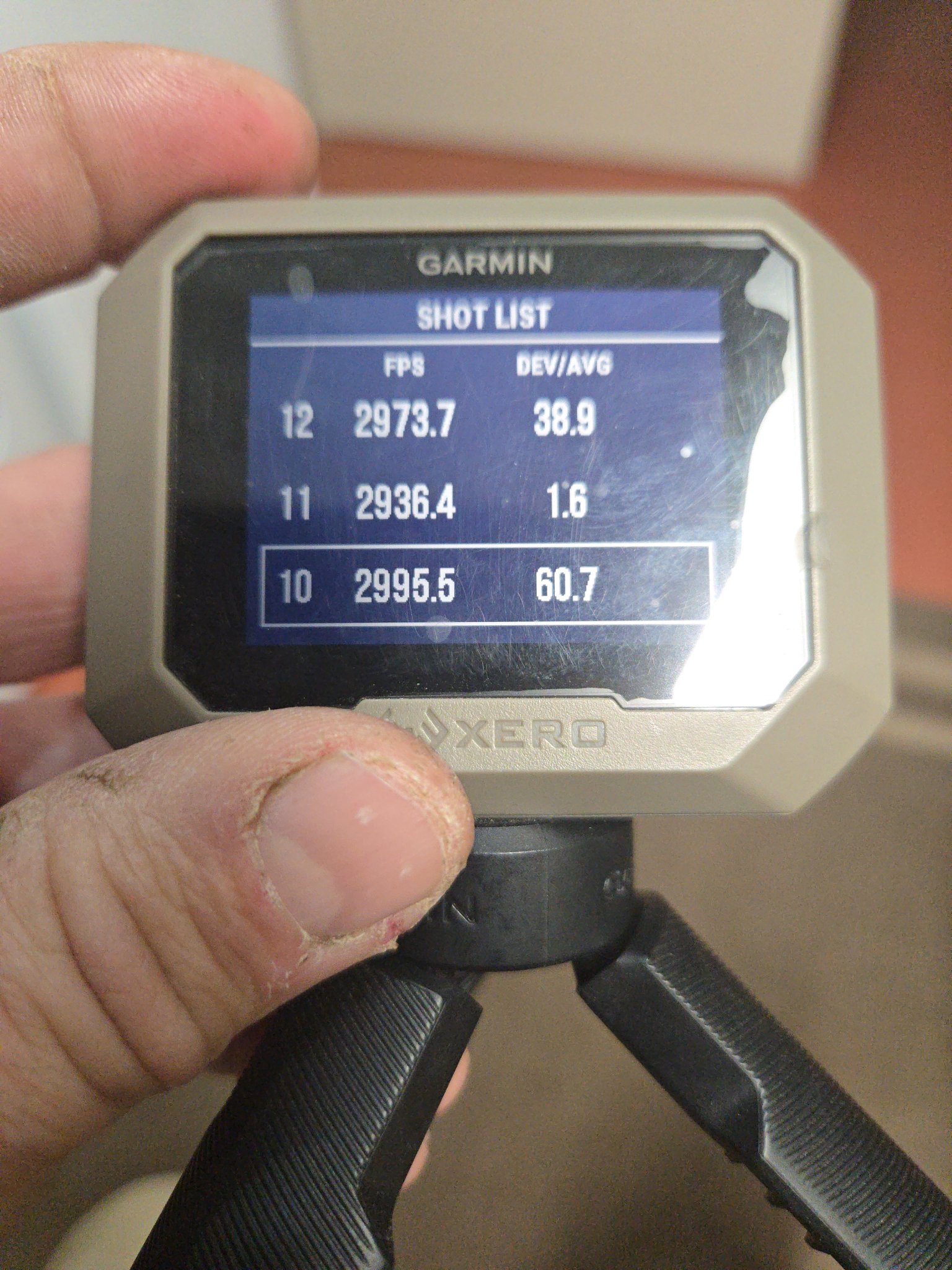

    Bought a xero last Feb and have been using it for the last yr. I noticed early on that sometimes it would show the first shot in a session as 60+fps faster than the rest. Not always, and when it happens it was usually first rd. Fouled barrel, cold barrel, warm barrel, doesnt seem to matter. It has missed 15 or 20 shots over the year, but so did my magneto speed.
    Yesterday, I did a velocity node test to narrow down a couple flat spots. Started at 40.4gr and went to 43.8gr in .2gr increments. I've done this test before with magneto and it worked great to find some accuracy nodes, using powders or bullets or cartridges I didn't have experience with. I trickled up to each charge and verified weight, alpha brass, br4, amd 107smk in 6creed load. The garmin was a shit show.
    The ammo was loaded and went straight to range in loading block, it never left my sight. Cartridges were single loaded and fired in order, lowest to highest charge. Some velocities stair-stepped as expected, some dropped 20-60fps, and 1 dropped 150fps. The "slower" shots felt normal and in line with previous and next shot. 1 day I was having issues with it showing a random "fast" rd in a couple different rifles/loads groups. A friend had his garmin with him so we put them on each side of my rifle and only my unit would show a random fast shot, his would not. Mine even dropped a shot or 2 that his captured.
    I talked to garmin today, hoping they would have an easy solution or rma this shit box. Unfortunately I get to be a garmin engineer and send them folders of data, kind of a pain in the ass as I'm not the most computer savvy. After I send them this, I have to do a hard reset, and then burn some more rds to see if it's fixed or not. If it's not fixed, they wanted me to get my buddys garmin, he's 40miles away, and run them side by side and video the discrepancies and send the video to them.
    Seems like with athlons new chrono out, they'd really want to step up and take care of their customers, instead of have their customers do the fault analysis.

    Yeah, both were on their own tripod, sitting on concrete as I shot prone. It didn't always throw a fast shot, but the way it acted yesterday....it should be easy to determine. They called me back to get permission to access my garmin account and had me upload the last session to the app. They wanted this xml file to see what exact parameters and whatnot is on my xero. I pretty well thought it would be easier to rma it and they can sort it out on their time.
