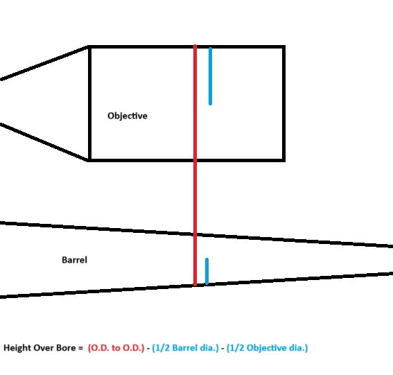

Especially with people using 20, 30, 40 moa bases and/or mounts, the most accurate method is actually to measure at the objective bell. The image that the reticle is imposed onto, and that the erector tube "looks around at" is generated from the objective bell. Outside-to-outside widest measurement between the barrel and objective, then subtract half the barrel diameter and half the objective lens.
