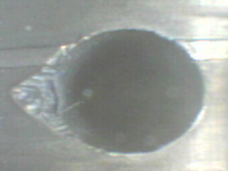

gas port erosion pics, new and after 100 rounds.
vincent7
Jan 14, 2019
109
36

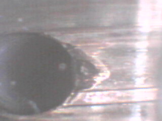

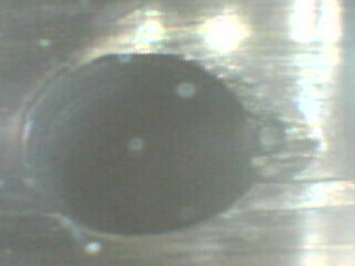

Stainless 18" rifle length 223/ 556, 100 rounds, slow fired, mixture between factory and reloads. Black hole weaponry barrel.
One pic before installed and fired ( might have been test fired at factory once or twice, since there was some black crud in there.
Second pic after 100 rounds.

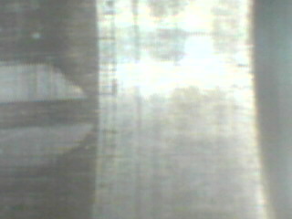

Pic of throat after 100 rounds, didn't make a pic when new.
Throat still looks about the same. Surprised how fast the gasses start chipping away at the gas port hole.
Barrel shoots really well, hope it lasts for a while :)

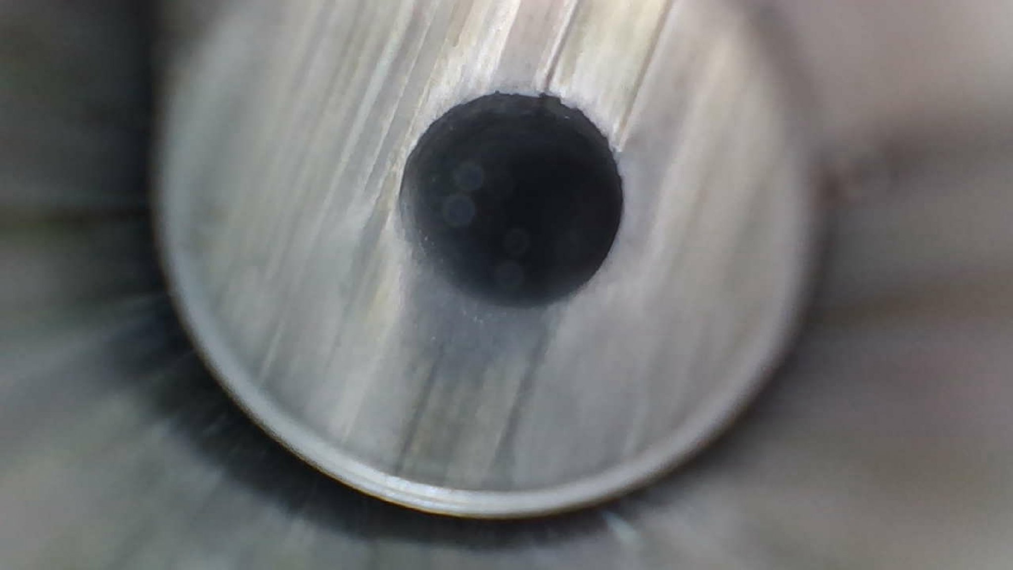

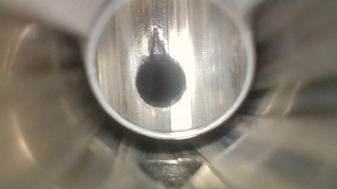

Ballistic Advantage barrel. Note that the gas port cuts into a land and there is a huge burr.
Larue barrel. Little to no burr, but the gas port cuts into a land.
Krieger barrel. Krieger Barrels Inc. drills the gas port in the dead center of a groove so that the gas port doesn't encroach on the lands and of course there is nothing in the way of a burr.
The shorter the gas system, the more rapid the erosion. The bore-scope view below shows the gas port of a 14.5" chrome-lined CMV AR-15 barrel with a carbine length gas system after only 500 rounds have been fired from it.

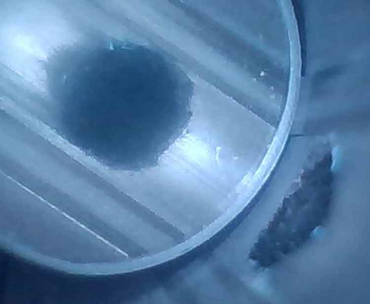

I've got one gas port in a SS match bbl that is eroded so bad you can't get it all in 2 pics, you'd need to show a movie. I'd estimate 5/8" or a little more not counting the port.

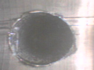

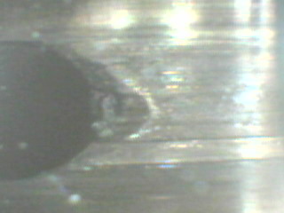

Am now at 150 rounds, scoped it again. Looks about the same, so the gas port wear seems to slow down.
Made some pics and will keep doing this for every 50 or 100 rounds, so i can keep tack.
Will share pics again when erosion seems to advance further down the bore. Shoots darn nice right now (sub MOA with handloads) .
Paid only $125 plus $20 or so for shipping for the barrel, so i'm happy :)
At 150;

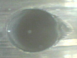

200 rounds total. Starting to pic up some copper.
Ran a boresnake through but have not cleaned the barrel.
Throat still looks great & Accuracy is great as well. (consistent sub moa groups with 69 smk & 24 grain Tac)
Interesting to watch the rate of erosion appear to slow down as the edge rounds over.
