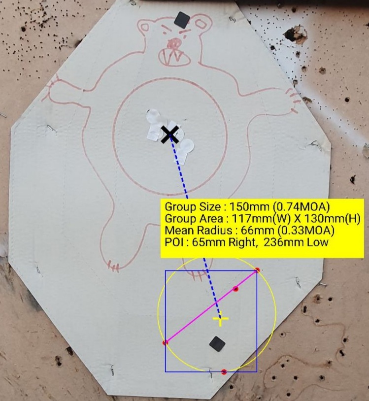

    At the beginning I assumed that I would get correct elevation at 700 with the 800m set DSF. But this was not the case. So most likely my first session had its data ruined by winds or something else. I could not do paper on the first trip so it is easy to get bad data without good group to really see the group.
    Anyways, after the fiddling with temps I got 8.7 and still got it too high. So I aimed 1mil low and spotted a hit at 8.5mil.
    For some reason I proceeded to dial 8.1 and then shot a group on the paper, obviously striking 0.4 mils low.
    I initially shot 3 but felt I held one too low so I shot 1 more, we were running out of time and in big hurry already.

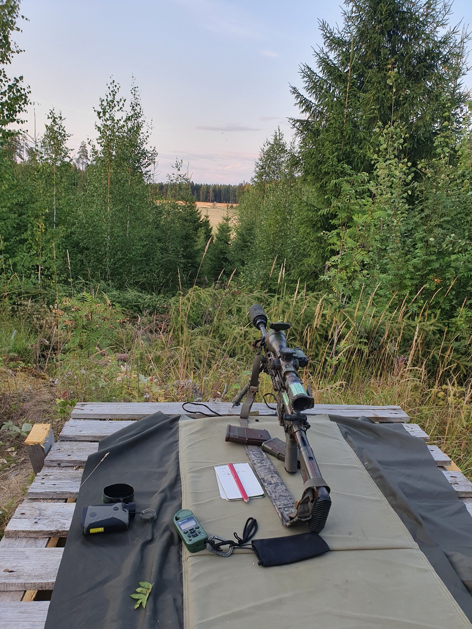

    One necessary pic from the range and the 700m target:
    It seems that the quickly dropping temp was also a part of this, the difference between 20C and 23C is 0.15mil.
    This really becomes a very scientific at this range, next time after chronoing I will see if my latest DSF gives me a correct elevation for the enviromentals and if not then I will just restart it with precisly recorded data.
