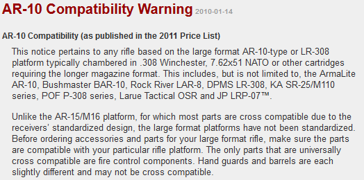

FYI Geissele CS said there is no standard (ie, Mil-Spec) for large frame ARs as there is for the small frame, and that fitting problems will occur in about 10% of AR10 variants.

Geissele CS is partially correct in stating no mil spec for AR 10's, however all AR 15, DPMS, LR, SR, etc. use the same blueprint spec for fire control i.e. trigger pin spacing & safety selector location in relation to trigger pins. The for/aft placement of the fire control group differs especially in large frames.
Per JP fire control components are cross compatible.

The info from 2011 is mirrored in JPs current description of the Ambi Safety which says it "can be used with any AR trigger components to allow for a perfect and safe relationship between trigger and selector". If only they were available for questions about their products---
