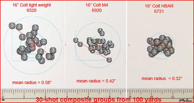

    If you want to make statements about what “is pretty much agreed” upon pertaining to the precision of light-weight AR-15 barrels versus standard weight AR-15 barrels you have to do some apples to apples comparisons using significant shot sample sizes. At a minimum, that means the same barrel length, the same steel, the same type of rifling, the same chamber/bore treatment and particularly the same chamber.
    For the last thirty years the de facto standard for what constitutes a 16” light-weight AR-15 barrel contour has been the Colt barrel found on the Colt 6520 and 6720. The ubiquitous government profile is what is found on the overwhelming majority of standard weight 16” barrels. Anything outside of those profiles within the same weight category makes the profile itself an uncontrolled variable.
    Colt light-weight 6520/6720
    Colt government profile 6920
    The graphic below shows the results of an accuracy/precision comparison of a Colt 16” HBAR (6721), a Colt 16” government profile barrel (6920) and a Colt 16” light-weight barrel (6520/6720). The graphic shows the results of three 10-shot groups fired in a row at a slow cadence and over-layed on each other to form 30-shot composite groups. The mean-radius metric is used to compare the precision of those different barrel weights so that all 30 shots from each barrel are evaluated in the metric.
    The Colt HBAR was the most accurate/precise barrel with a mean radius of 0.32”. The Colt light-weight barrel was the least accurate with a mean radius of 0.58” and the accuracy of the Colt standard weight barrel was in-between those two barrels.

    Now we are getting somewhere! Love this data, thanks for sharing and compiling.
    I don’t know if this is an appropriate conclusion to draw, but it looks like most of the shots that opened up the lightweight composite group were in the 3rd string of fire. The other profiles seems to be more evenly dispersed.
    Was each barrel allowed to cool to ambient temp between groups?
    I would be extremely interested to see these same results if you ever have the chance to shoot Criterion Core, Hybrid and HBAR barrels. I would be curious to see if their claims of intelligent weight distribution on the Core result in better performance.

    My take away from Molon’s post is probably incorrect but 30 rounds in 0.58” from an AR-15 at 100yards from a lightweight barrel is outstanding. I don’t compete so I can’t speak from that context but there is no hunting context I’ve experienced where 3 strings of 10 shots around 0.5” at 100yards is even close to a performance requirement. When shooting an living things, they all tend to run around after the first shot.
    I agree with the above, but what he’s showing is mean radius. Double that for how groups are usually measured (about 1.2” in this case). Still not bad though

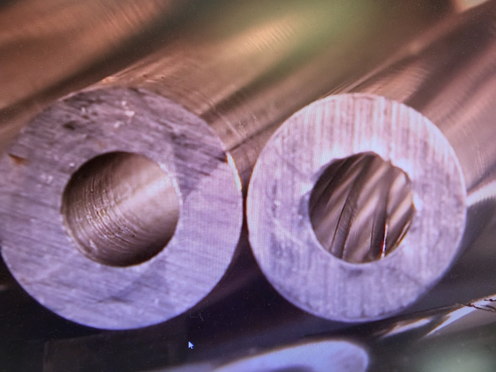

    It's not just the contour/heavier weight that will help you. It goes back to the quality of the barrel and the way it's been manufactured.
    Button and hammer forged barrels work against you and it gets worse with a lighter weight contour and or if you do fluting and muzzle threading. Because of the way these barrels are made....as you turn it smaller/lighter and or flute it etc...the bore ends up opening up on you. Changing in size.
    Cut rifled barrels don't have that problem as we don't work harden the bore and or induce stress into the blank.
    Four things make a good barrel. Bore and groove uniformity over the entire length of the barrel, twist uniformity and the straighter the barrel and more stress free it is the more forgiving it is going to be when it comes to accuracy and consistency. This applies to bolt guns and gas guns as well.

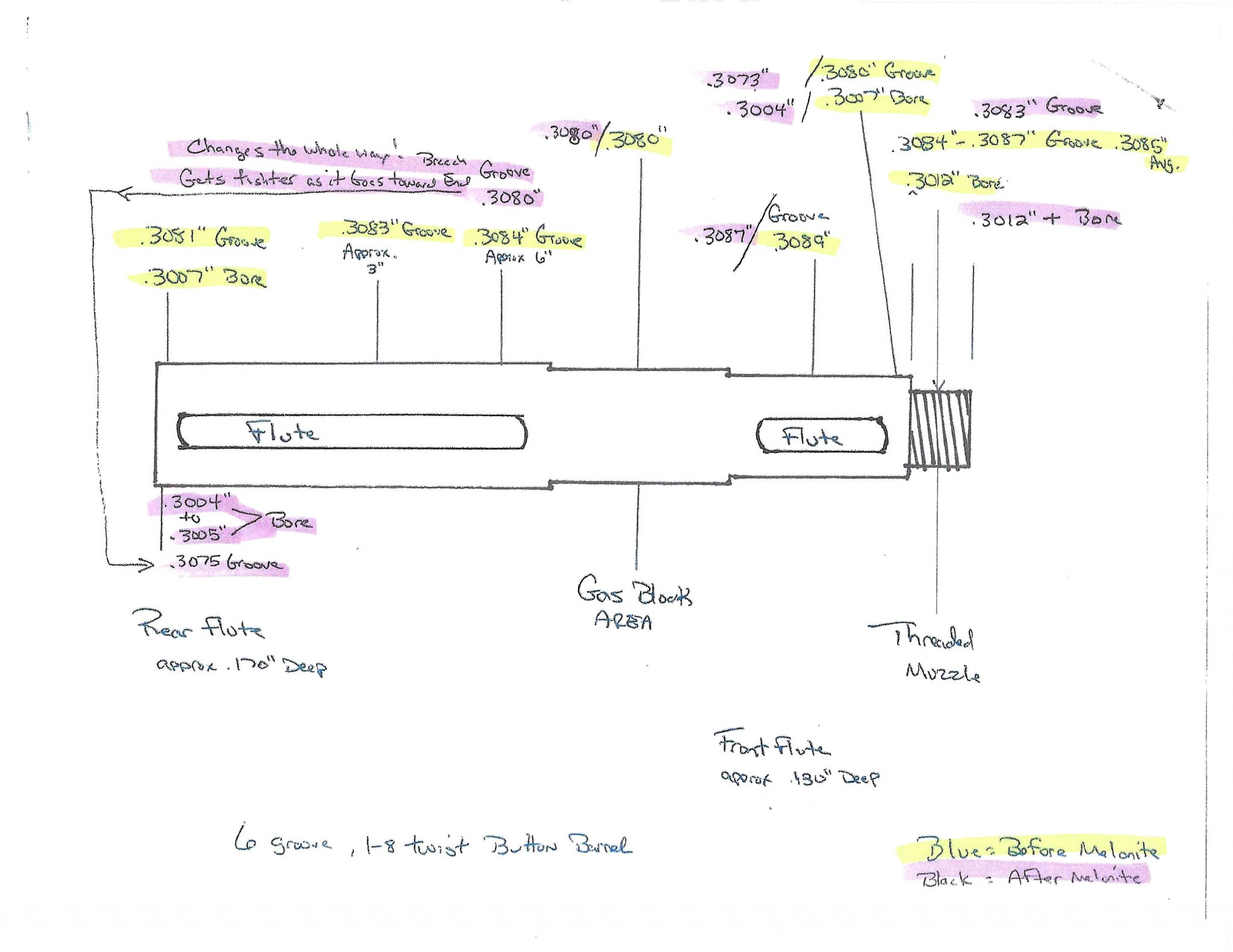

    The attached sketch was an inspection we did on a button rifled 308w AR10 barrel. The barrel was fluted. The barrel after all the finished work got done to it then got melonite treated. Several barrels got overnighted to me. I had to do a quick gage of the bore and overnight the barrel back to the shop doing the melonite treatment. Then they got overnighted back to me for the follow up measurements and I had to overnight the barrels back to them again. So sorry for the chicken scratch writing/drawing. This will give you an idea of before and after on a AR platform and a button rifled barrel blank.
    Later, Frank
    Bartlein Barrels
    I was able to post it as a pic by itself instead of an attachment.
    I'm not hacking on the melonite treatment process. This all has to do with the quality of the material and how the barrel is made. Those dimensions shouldn't be changing like that.
    The closer the machine work gets to the center of the bore/wall thickness....as button rifling doesn't remove the material it displaces the material. All of that stress has to go some where. When you do the finish machine work like fluting, contouring, threading the muzzle etc.. the closer you get as you cut into the wall thickness of the barrel....it will have an effect on the bore changing more often then most people think.
    So you have to ask yourself some questions. What is your accuracy requirement? How hot you going to get the barrel etc....
    I love this picture as it shows how the steel gets pushed/moved around when the button goes into the blank.
    That is incorrect. ;) The results I posted above were for the mean radius, not the extreme spread. The "rule of thumb" for comparing the mean radius to the extreme spread is to multiple the mean radius times three to obtain a high probability of the extreme spread for averages of 10-shot groups. (There's more to it than that, but the rule of thumb works well enough for this discussion.)

    Really trying to understand here then... What would your conclusion be?
    For the lightweight barrel below, most extreme outer impacts are mostly from either 2 or 3 (with most of them being from group 3). Essentially, if I look at the composite group and visualize taking the third group out, the mean radius should decrease. Interestingly, the outer impacts are more evenly dispersed for the M4 and HBAR barrels.
    Maybe I'm overthinking it and want barrel heat to be an issue when the real issue is simply the barrel profile (and per Frank's comments, barrel quality)
    You're trying to see something that just isn't the case and ignoring the data that doesn't fit your preconceived notion. As I stated above, heat build-up was not an issue for those groups because all of the shots were fired in a slow cadence. If your hypothesis was correct, then the smallest group that could possibly be obtained with the light-weight barrel would be the first group fired and group sizes would get progressively larger with each succeeding group with the last group fired being the largest group, yet that's just not what happens on a regular basis.
    Here's the data that I posted above from a different Colt 16" light-weight barrel from six 10-shot groups fired in a row in a slow cadence.
    Six 10-shot groups were fired in a row in a slow cadence. Those groups had extreme spreads of:
    1.18”
    1.92”
    1.28”
    2.53”
    0.96”
    2.24”
    for an average extreme spread of 1.69”. Using RSI Shooting Lab, I over-layed all six groups on each other to form a 60-shot composite group. The composite group had a mean radius of 0.56”.
    If your hypothesis was correct, the first group would have had the smallest extreme spread, but that wasn't the case. The fifth group had the smallest extreme spread.
    If your hypothesis was correct, the third group would have had a larger extreme spread than the second group, but that wasn't what happened.
    If your hypothesis was correct, the sixth group would have had the largest extreme spread, but that wasn't the case. The fourth group had the largest extreme spread.
