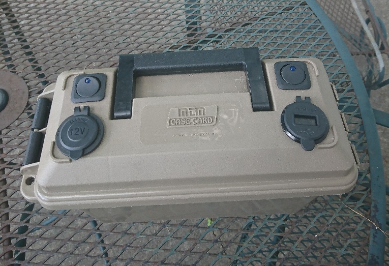

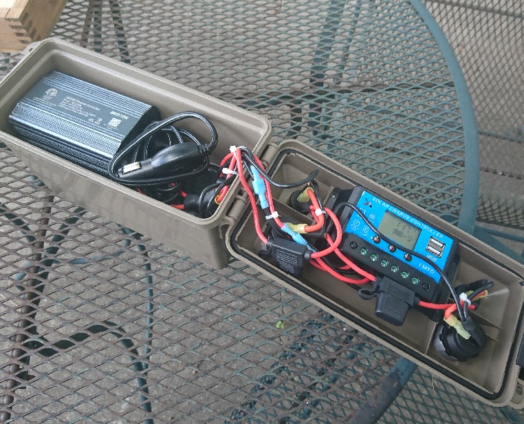

We like to camp also and a few years ago I put together a solar generator using recycled 18650 batteries paired with a 100 watt panel. It does what expected and I use it regularly around the house to charge devices. Most often I charge smaller battery packs that get used by the wife and kids wherever they are sitting. I have it set up to hold the 300 watt inverter inside the box to take out and use as needed. It gets used to charge a couple laptops and run a tv.

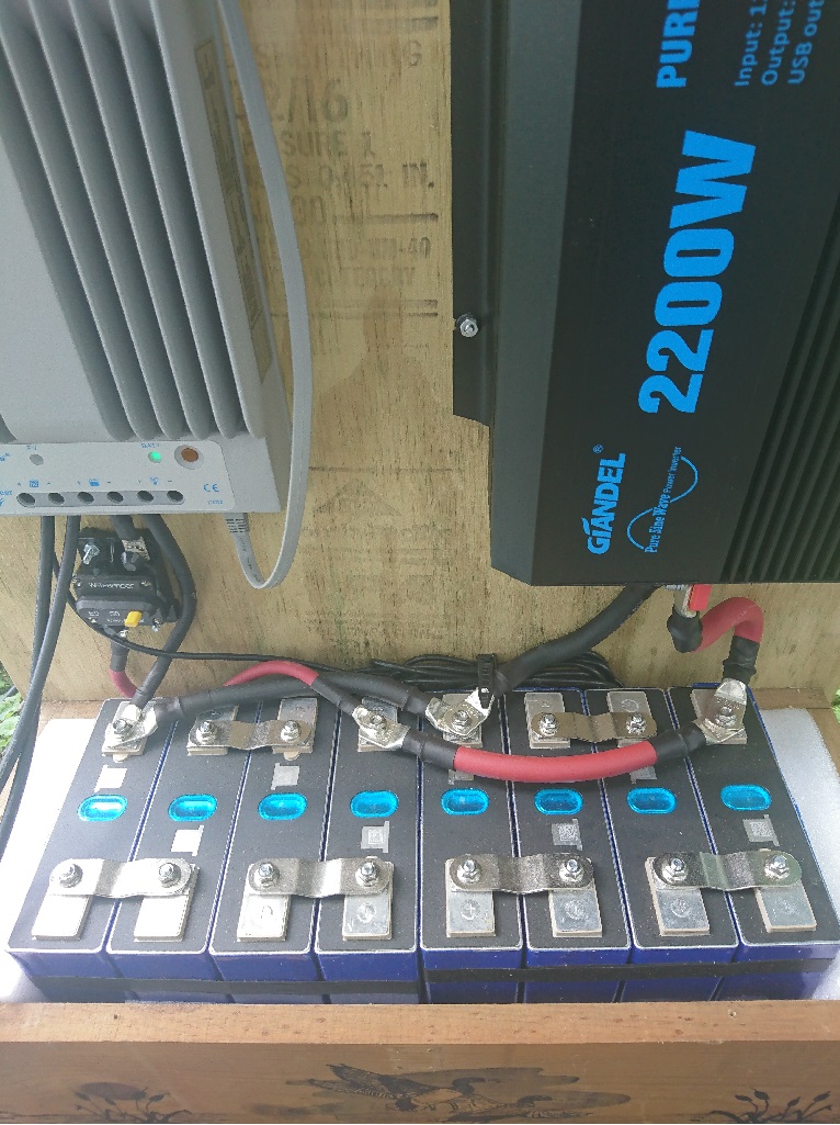

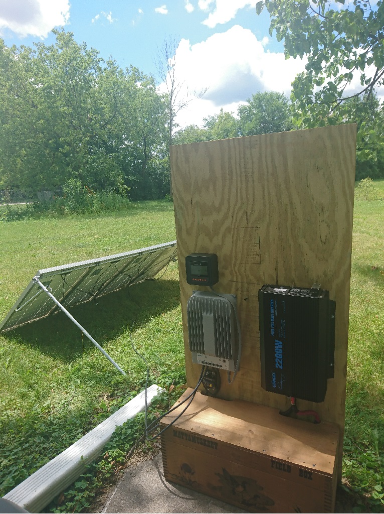

More recently, I put together an off grid solar setup for our camper which will now be used for an off grid cabin we have been working on. 400ah of lifepo4 storage and a 2200 watt 12v inverter paired with 400 watts of panels. I brought the setup with us for 4th of July camping to test it out and I'm happy enough with it. It's a work in progress so I have to add some items yet. The battery prices have fallen considerably in the last couple months and I'm seriously considering doubling my storage capacity and switching to 24v, possibly even switching to LTO for the cabin to leave them without worry during the winter.
