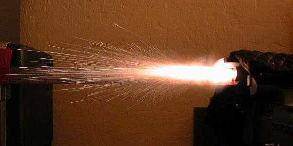

getting hangfires CFE223
using the rem 7 1/2
7 1/2 are pretty hot for SRPs. I had some issues with consistency running just under 40gr of Staball 6.5 in a 6 GT that I suspect might have been the result of using 450s to light that much ball powder. I've never had any issues with ball powder in similar or larger charges with LRPs, just a thought.
