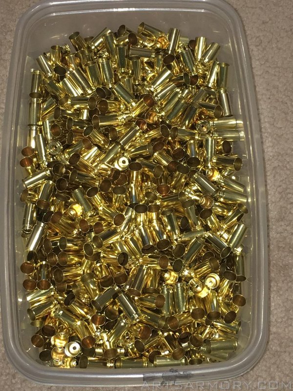

I am finally going to start wet tumbling my brass and was looking for suggestions as to what to get. Aside from the tumbler, what else do I need?
I assume some stainless pins
How do most people dry their brass? I live in a humid area do just setting them outside may not be enough.
Your correct - stainless pins. Possibly sized correctly for calibers you intend to tumble. If not, you'll just need to check and make sure no pins stick in cases like I do. Rarely happens
Some come with pins, some don't so read carefully.
A media separator is a must. I use the Frankford one and like it just fine.
Dawn and Lemishine.
I use an old food dehydrator for when I'm in a hurry. You can usually find a used one cheap. When I'm not in a hurry I leave laying flat on a towel for a few days and everything drys just fine.
From my experience less is more when it comes to adding Dawn and Lemishine to the tumbler. Also don't tumble after trimming your brass or you will have to trim them all again to remove a bur from inside the neck
When in a hurry I have put brass in my oven at 200 degrees for about an hour. If not in a hurry I will lay them out in front of our dehumidifier over night. Laying out in the sun also dries them up pretty well.
Priceless words of wisdom. Trim/Camfer/Debur AFTER tumbling.
I find a 9mm case of lemishine works great. To much and you'll have pink brass.
Also a good idea not to leave cases in your "magic solution" over night or you'll have stained brass. Doesn't necessarily hurt anything... but looks odd.
Never used lemishine. I tumbled thouands of .223 and 9mm using water, stainless steel pins, and a splash of simple green. Gave a dull finish, but the cases were very clean.
Sent from my SM-N920V using Tapatalk
I have been using the Frankford Arsenal Platinum Series Tumbler for two months and don't have any complaints. I got it from Amazon as it was a good bit cheaper than Midway. For the price, which includes 5# of stainless steel media, I think it's a great value.
As others have stated, I use a large squirt of Dawn dish soap and a teaspoon of lemishine and the brass comes out impressively clean inside and out.
I made my own tumbler out of a 5 gallon bucket, a gamma lid, and an old windshield wiper motor. Not as nice as the frankford tumblers but it gets the job done
I went cheap and use the Harbor Freight dual drum rock tumbler, think I got mine for $40 on sale. You can do a pound of brass in each drum at a time, so #2 is about 82 .308 or 140 .223. Has worked well for me, but if you plan to process a lot of brass it may not be the best option.
