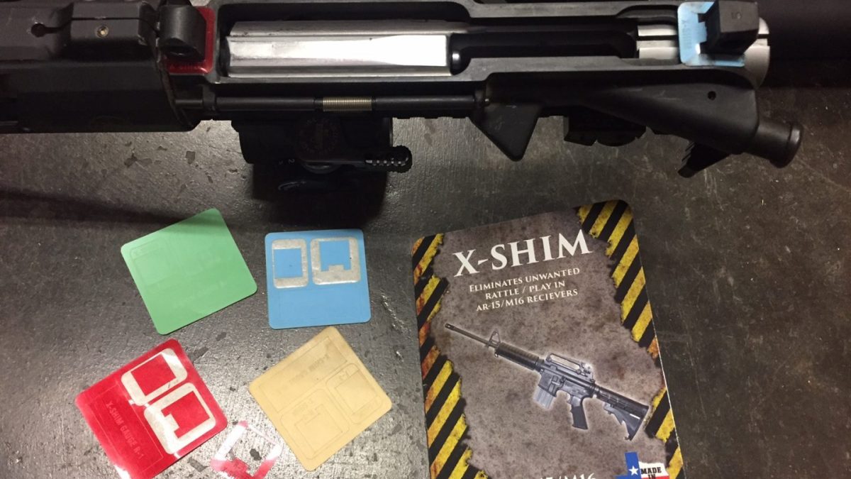

X-Shims "were" the best thing ever ( lol ) for eliminating slop... but the company is gone and frankly my CC would get hacked from them.
Here is a picture of them, they came in various thicknesses... super easy to use and snug up a upper to lower.
I would "think" you could make your own out of SS shim sheets...
Youtube video shows the various thicknesses....
Reactions: Rec1er
I think I could make some of those using shim steel , glue them on and all good.

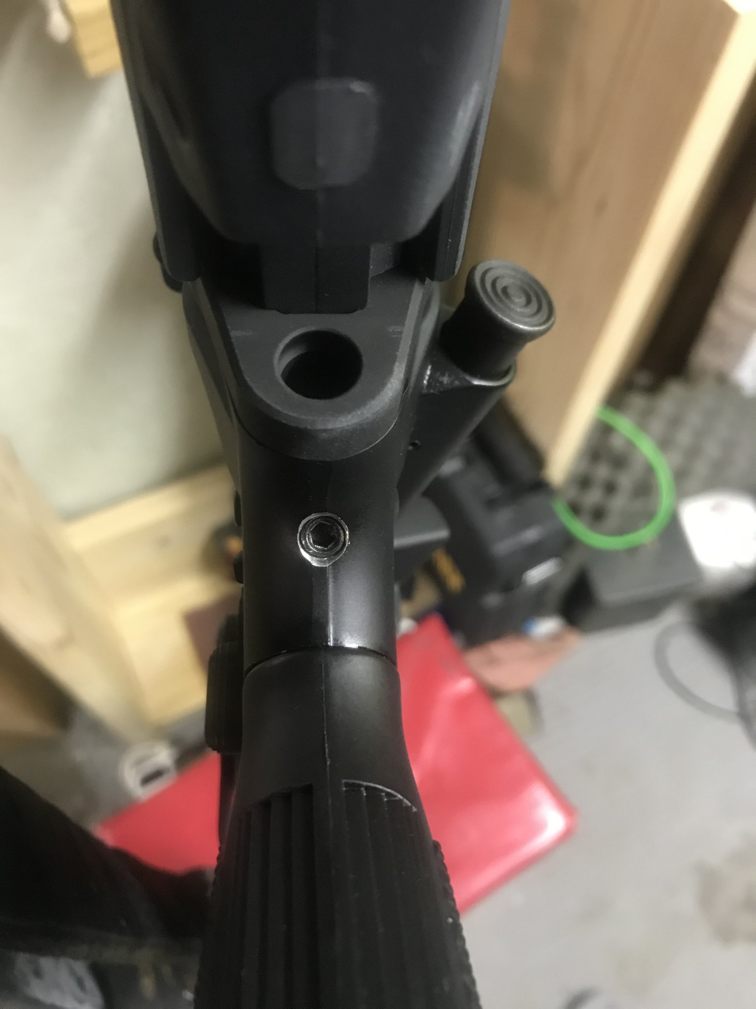

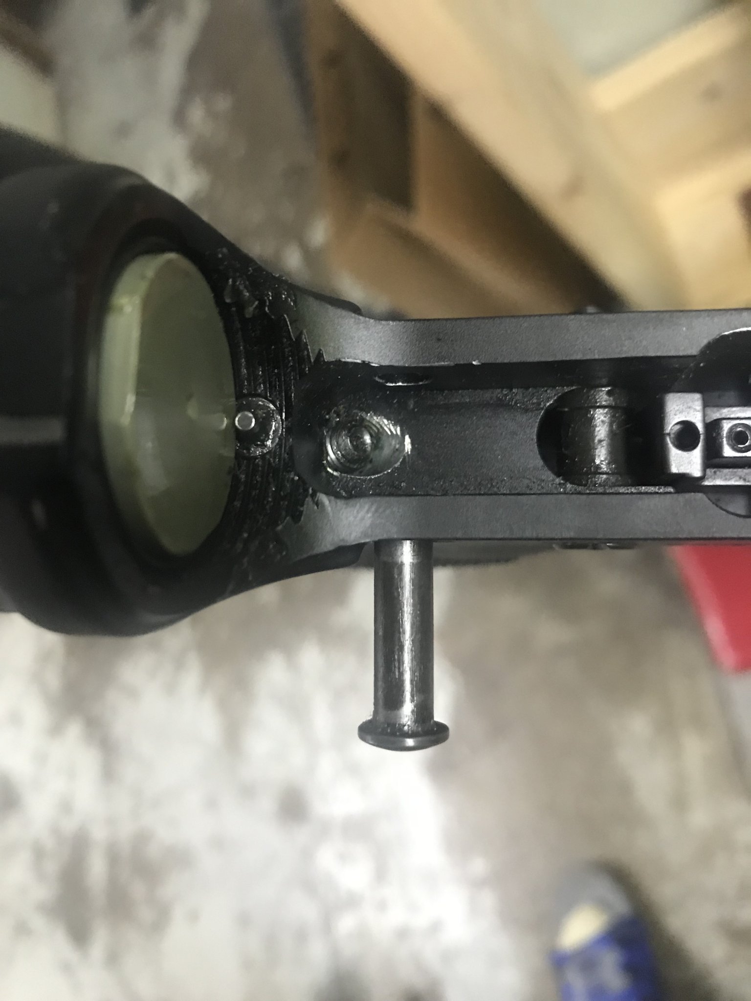

Drill and tap the lower receiver. 1/4 inch set screw. I think. It pushes against the upper receiver take down pin hole. You don’t have the quick opening anymore, but it gets all the slop between the two receivers out. And its still legal for cmp competitions. Hope this helps. David
I think the Aeroprecission method of drilling up through the lower and using an adjuster screw is better as you can still take the rifle down with no tools.

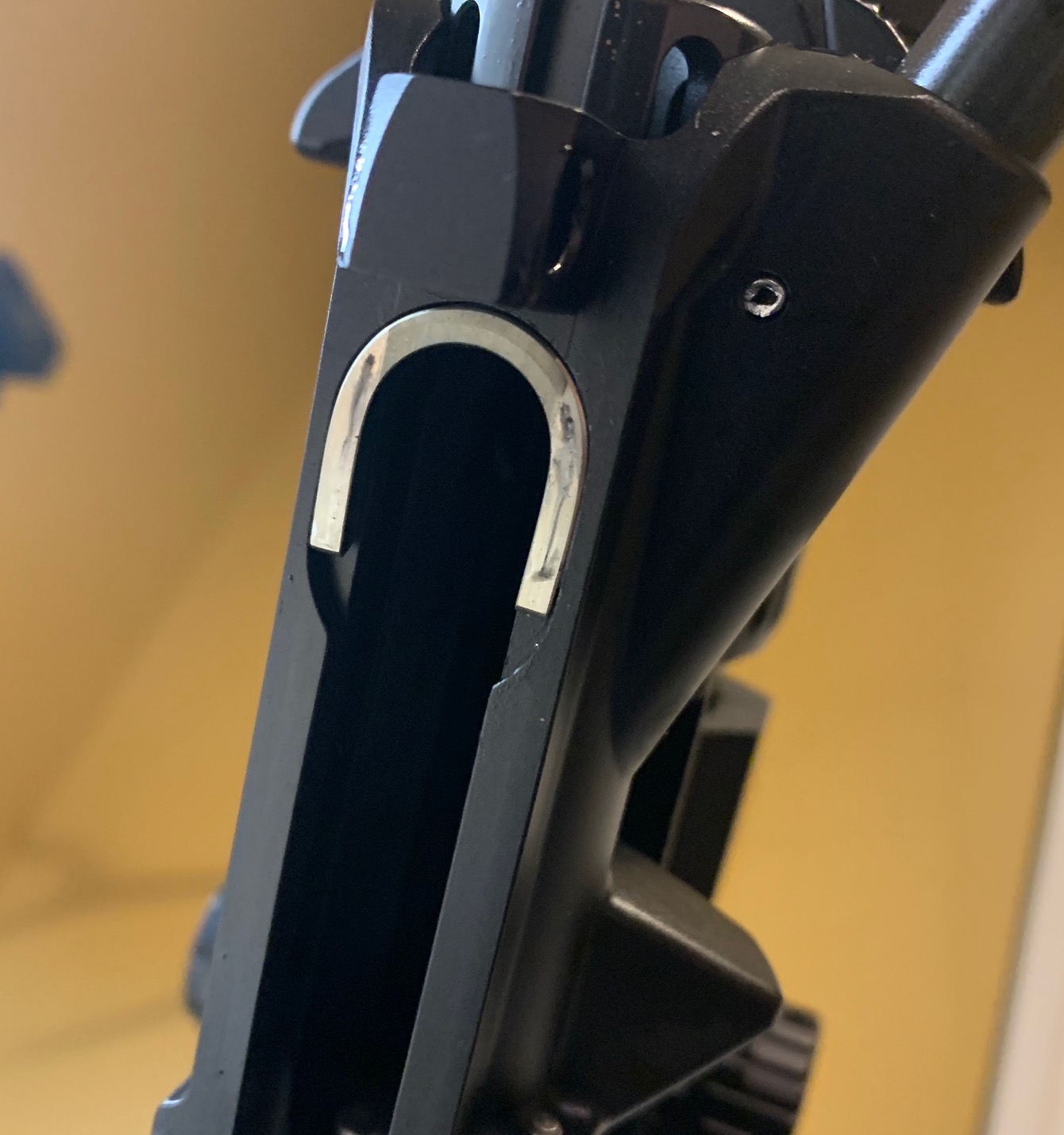

I run the National Match shims in all my AR's. Takes a little time to fit it, but they work great. Nice cheap little kit.
Work in large frames also.
Thank you for showing me this. I ordered 3 kits. This seems like an ideal solution. Semi-permanent, custom fit, and more durable than O-rings or plastic shims. Amazing.
