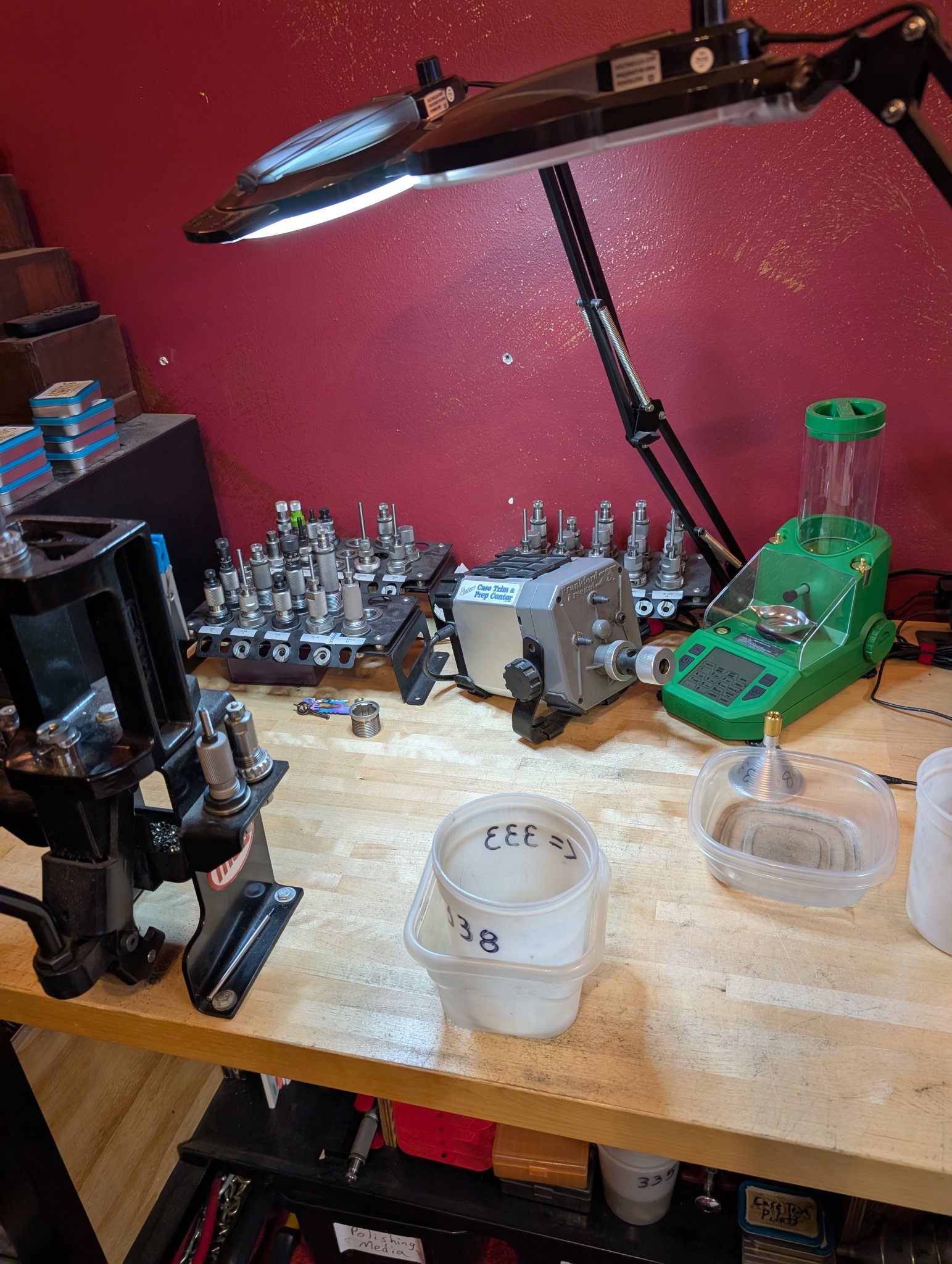

I have multiple Dillion 750s, multiple super tricklers, henderson, amp ,ect.....and I still shoot about half my matches with factory ammo. It's such a time saver and the actual cost difference ( about .80-1.20 CPR reloaded with top components) is negligible.
IMO unless your time is completely worthless then you need to invest in automation and repeatability. That means high end equipment. $5k on the low end and closer To $10k to do it right and maximize quality/time. You will also need to buy components in bulk to keep prices down.

I never understood the appeal for the Hornady die bushings. I was curious and timed the effort for removing a die from the press. It took less than 10 seconds to do it. Those bushings seem to me to be a waste of money.
The real time saver for me is the Giraud case trimmer for large volume case trimming.
The one thing that Hornady makes as an accessory is their die lock rings. Well worth the money to upgrade to their rings compared to most other die rings.
Yup. Most Hornady products suck but their die lock rings are among the best. I don't understand why so many companies uses lock rings with a set screw that drives right into the die threads. There is a pile of Wilson, Redding and Forester die rings in one of my drawers.. they all get replaced by Hornady. 6 for like $15 or something.

I really like the L-N-L bushings, but I reload a lot of different calibers on a single stage.
With the bushings I can drop in a seating die and it will be exactly how I had it setup last time. When I was screwing in dies I didn't get as repeatable results and would end up making minor adjustments. Not required for sure, but I really like them.
