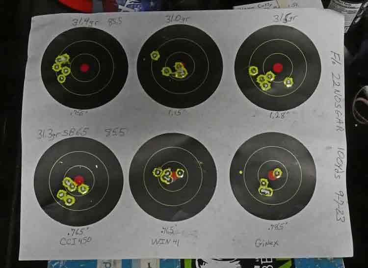

They made in Bosnia, most say mil-spec, so the meet NATO ammo specs. From 50 BMG to 5.56 and 9mm. So primer cups should be similar to CCI mil spec. I've used them by the thousands, and they work fine, for any general purpose application.
Yay or nay for precision type shooting? 🤣
You'll have to try them for your individual load and rifle. I did a limited test with a heavy target 308 rifle with premium Lapua brass & commercial primers...against random. Military primed LC brass the Lapua brass usually only resulted in .1" better 5 shot groups. You spend a lot of money on premium components for one tenth of an inch. So I run these primers in 223, 300 blackout, 300 hamr, 308, and 50 BMG most exclusively in autoloaders.
I've shot small 5 shot groups with these primers in all those calibers less than .5" some to .25".
Would the groups be smaller, with brand name primers? Maybe, but not much?...These especially useful in autoloaders, blasting steel, plinking at targets informally.
And maybe not for someone trying to set competition records, or a personal best endevor...confidence is part of your accuracy toolbox.
while still expensive I love them so far they work just as good as the cci 41's I have also purchased except I had to get 15k worth per shot every one I have used so far had gone bang and the numbers were better than the results I got for the winchester lrp I have I am getting more if and when I am able to . the one thing I did not like about them was instead of say 15 boxes easy to handle like most other primers these have only the shipping box and 15k worth of loose trays of primers , it's easy to drop everything out once you open it .

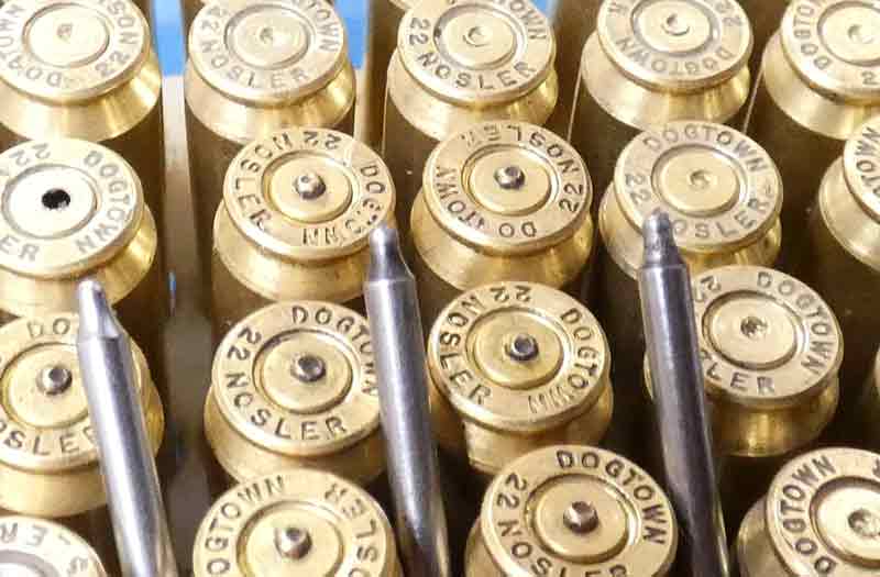

I have found the upper load limit for GINEX SRP (the brass colored one).
Fairly hot loads with CCI450, CCI41, or WIN41, blank primers when using the GINEX.
Had same issue with the old Win SRP.
BUT,
Once sorting out the weight outliers, and shooting a little lighter load do fine.
4 targets with CCI450, one each with WIN41 and Ginex.
The shooter (my wife) has this tendency to pull a shot or two though.
All 30 shots, half grain range in powder, 3 different primers, ended up being 1.6MOA, even with the fliers.
