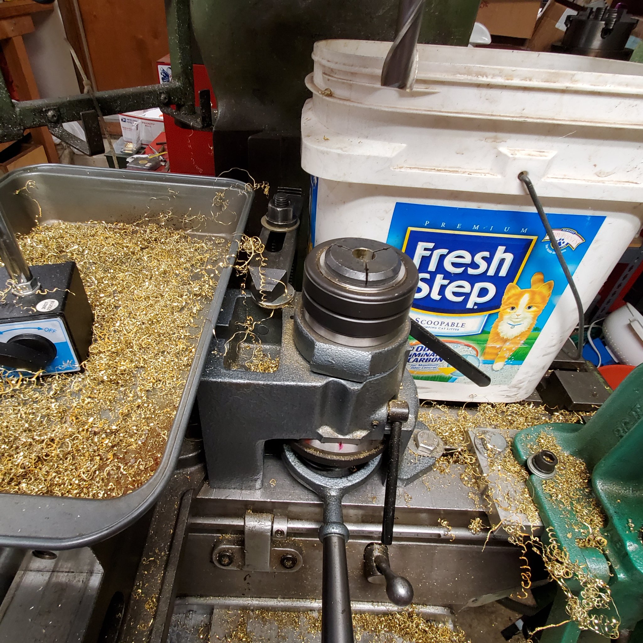

Need to take off 1/2" in about a second,..
Industrial strength Bridgeport mill, collet closer, with dead length collets.

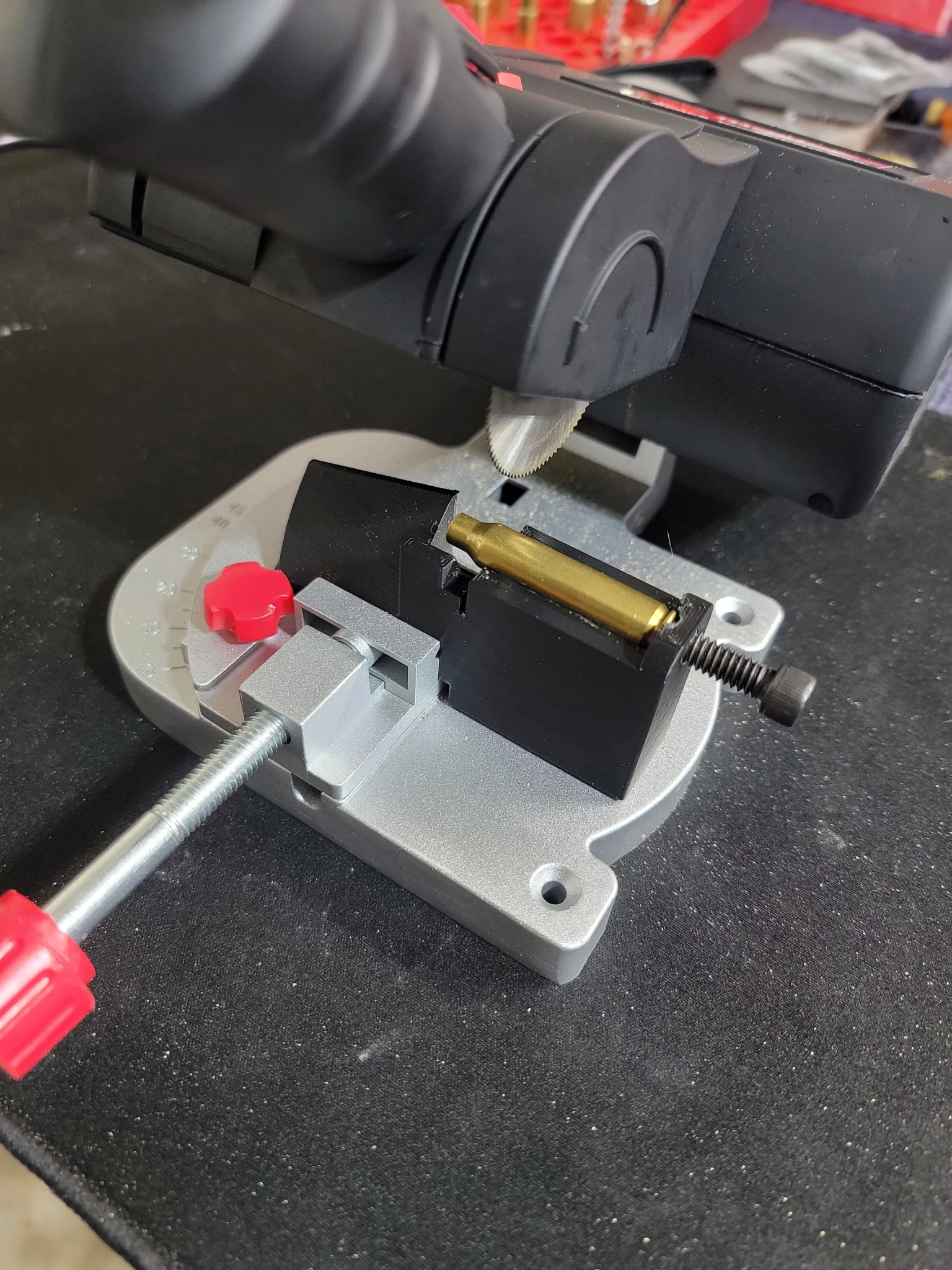

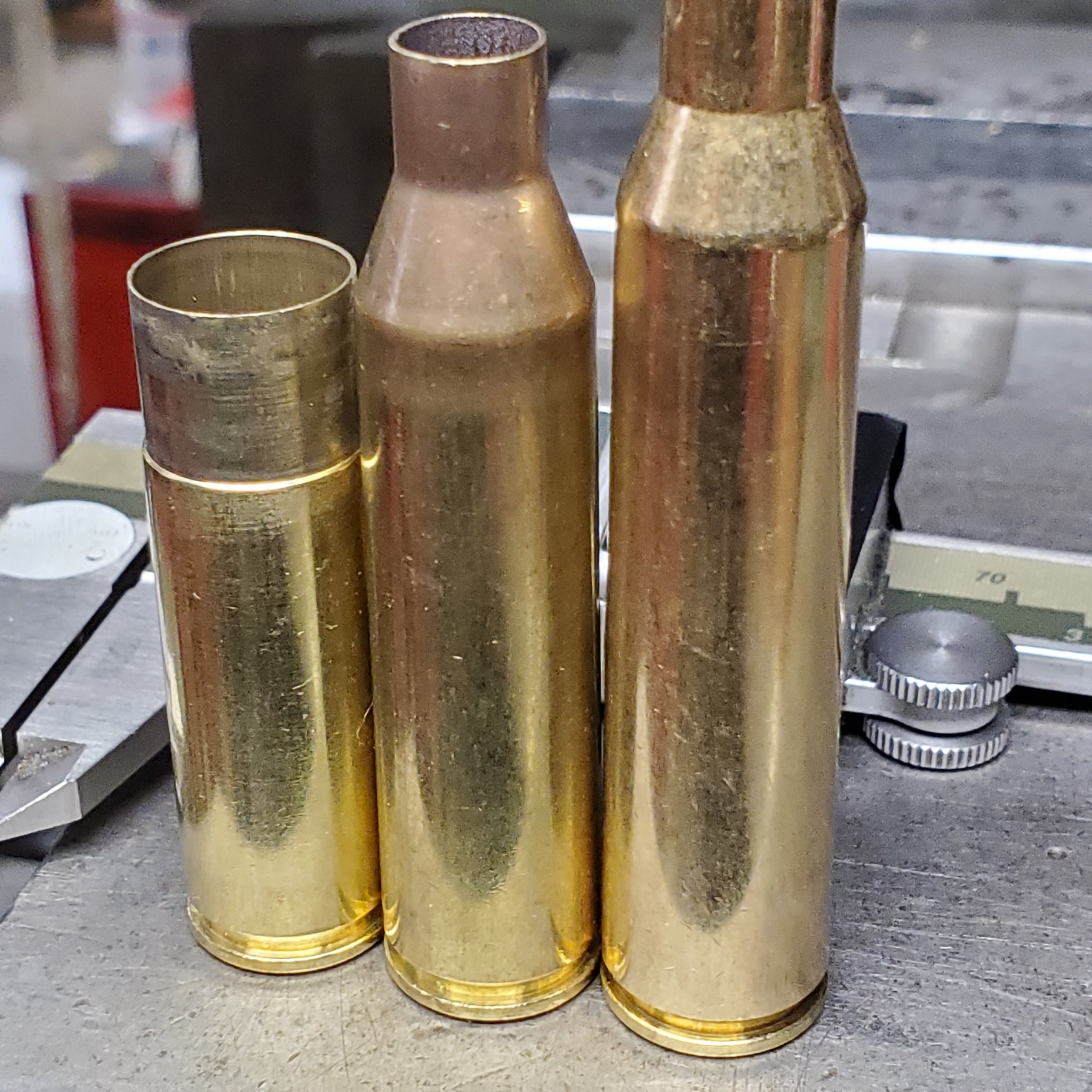

Make some chips...going .510 cal one thousand cases of 338 Lapua brass or Norma mag brass.
No time for toys...

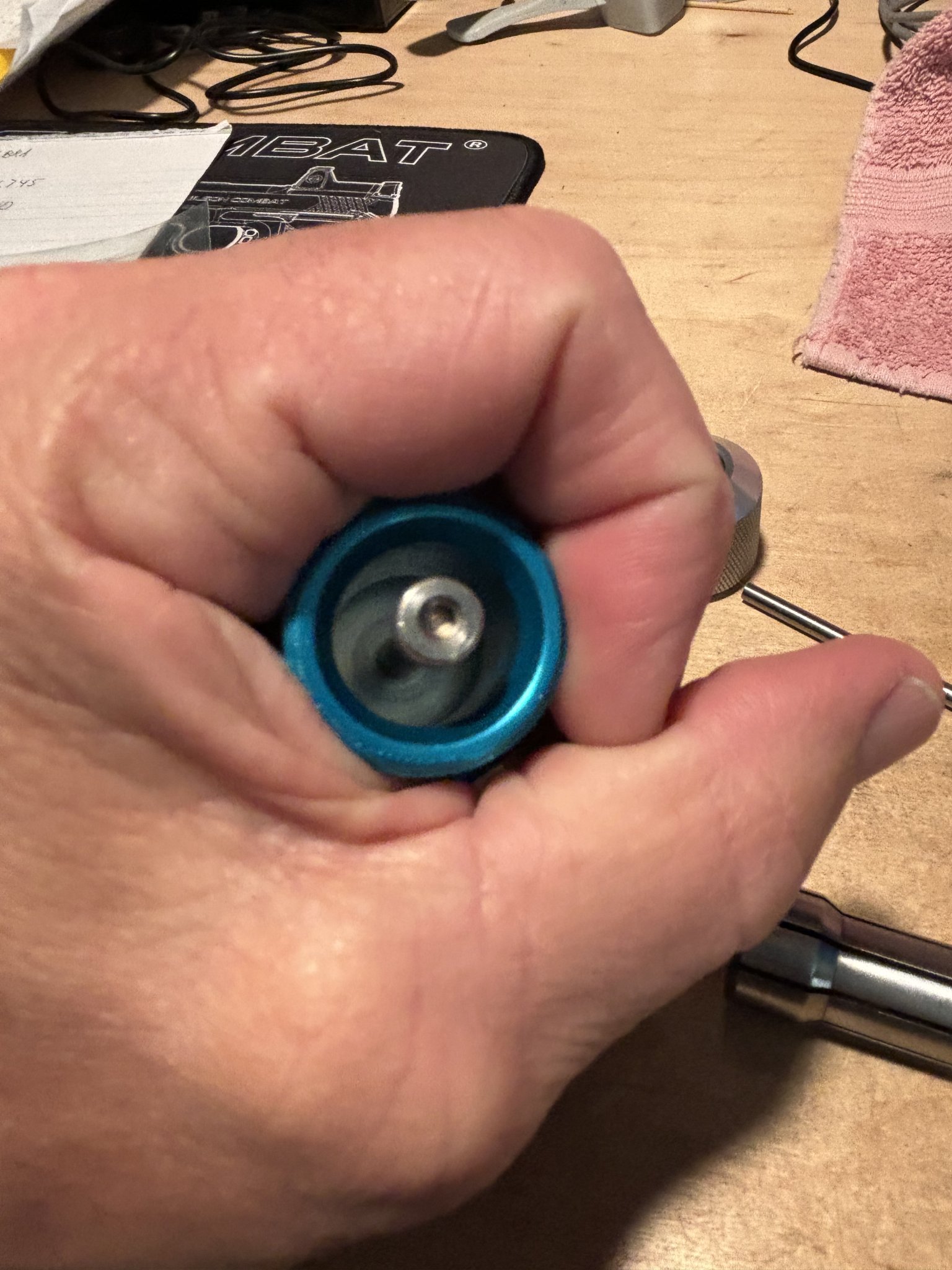

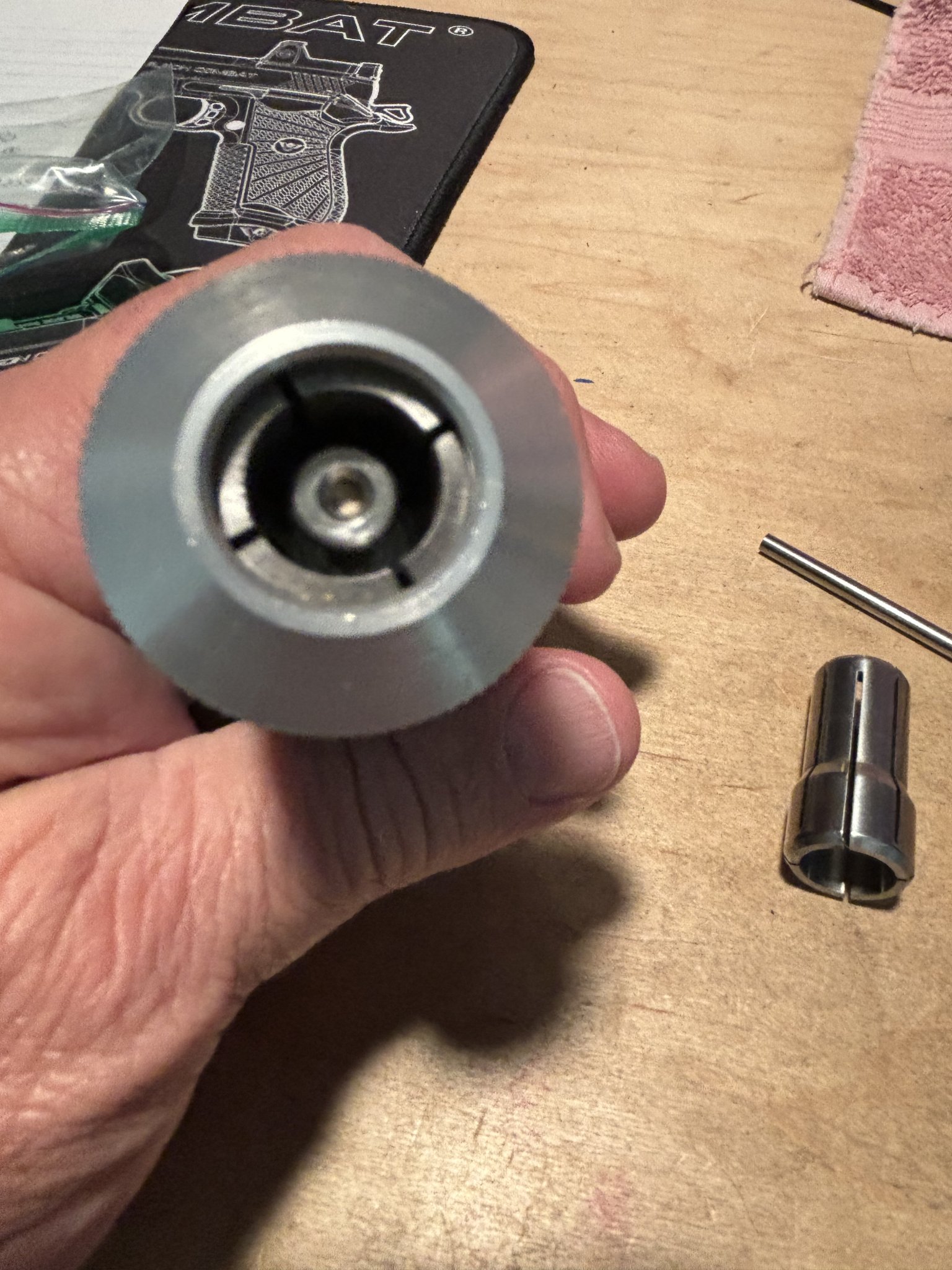

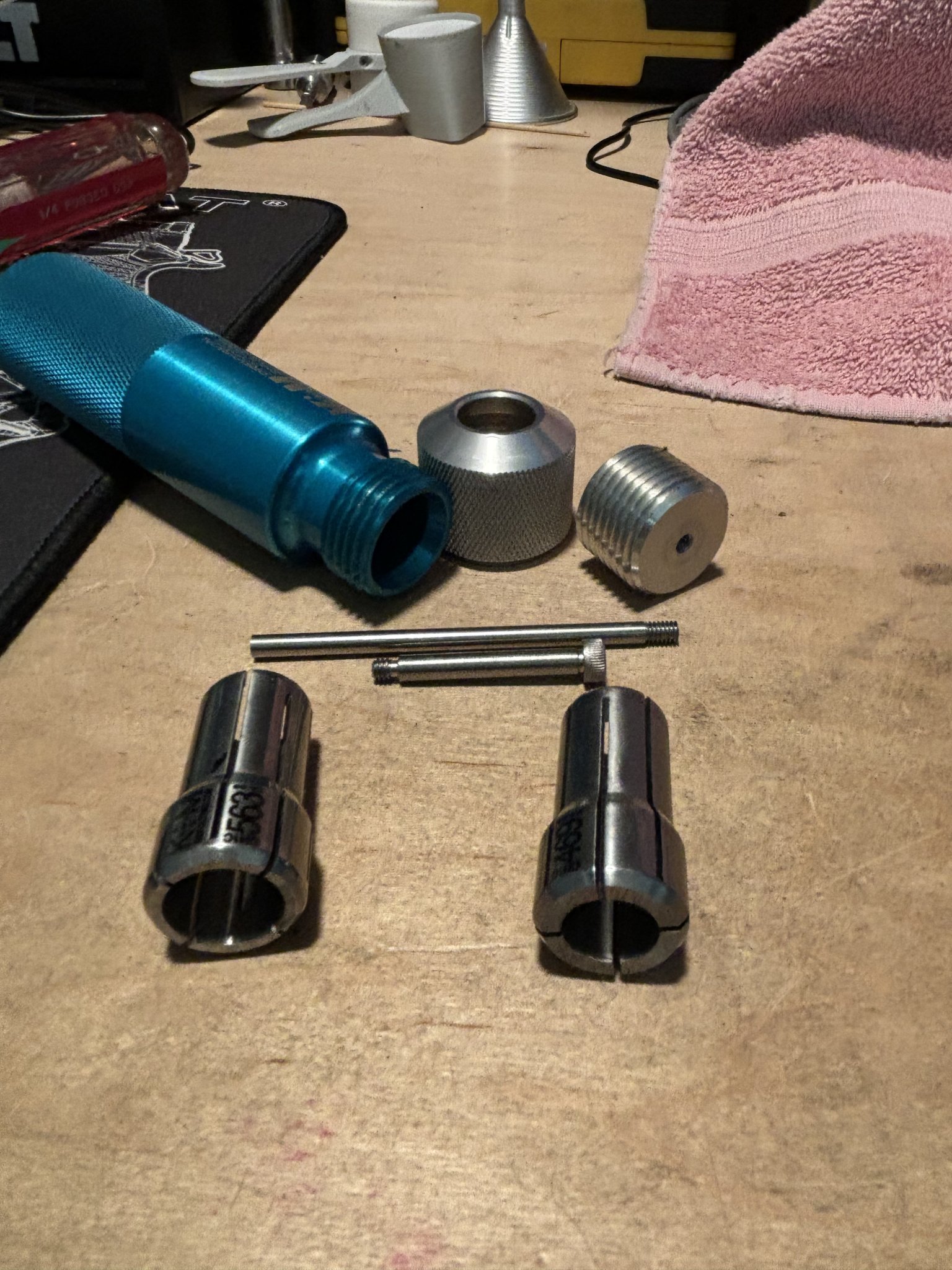

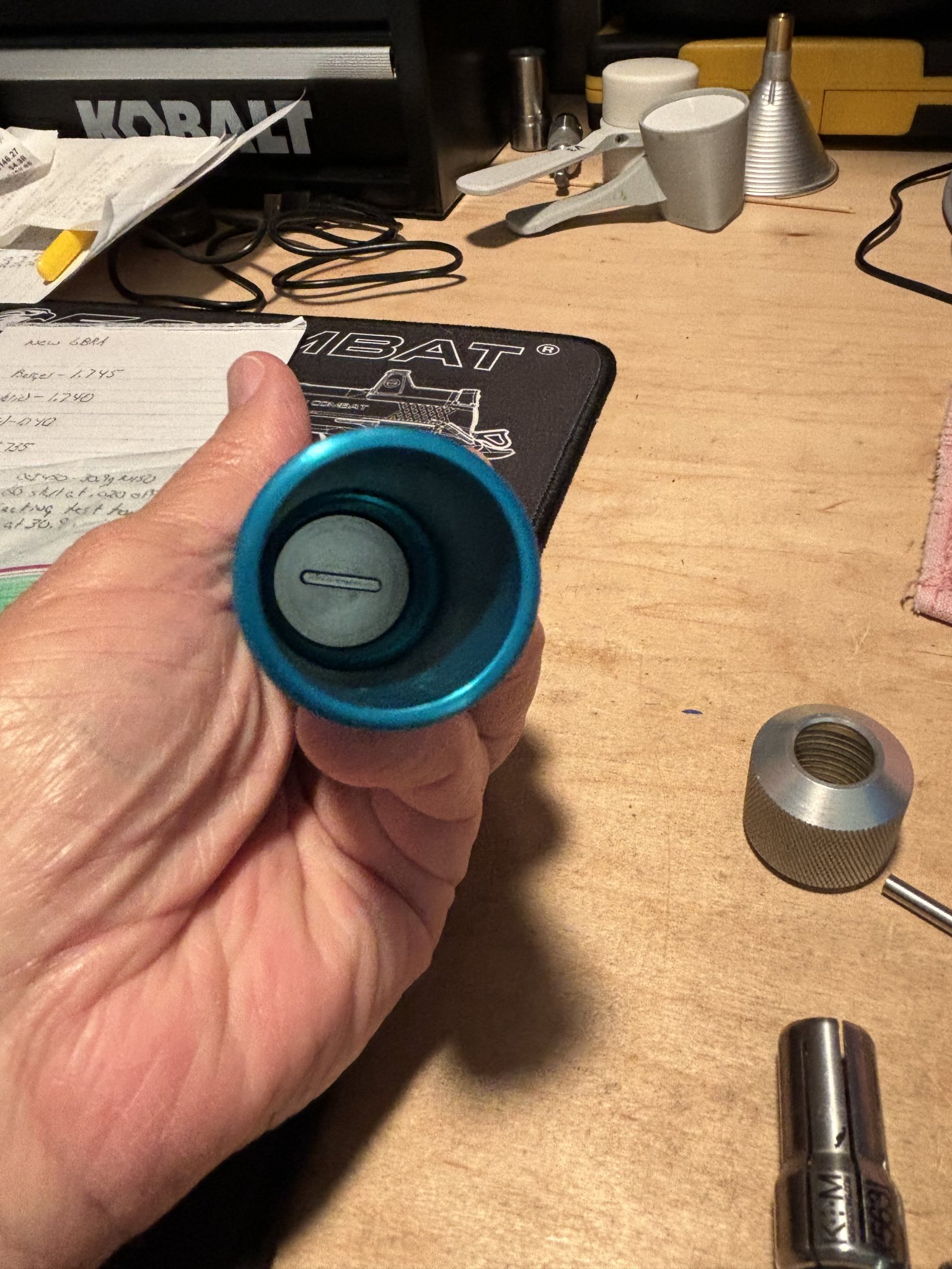

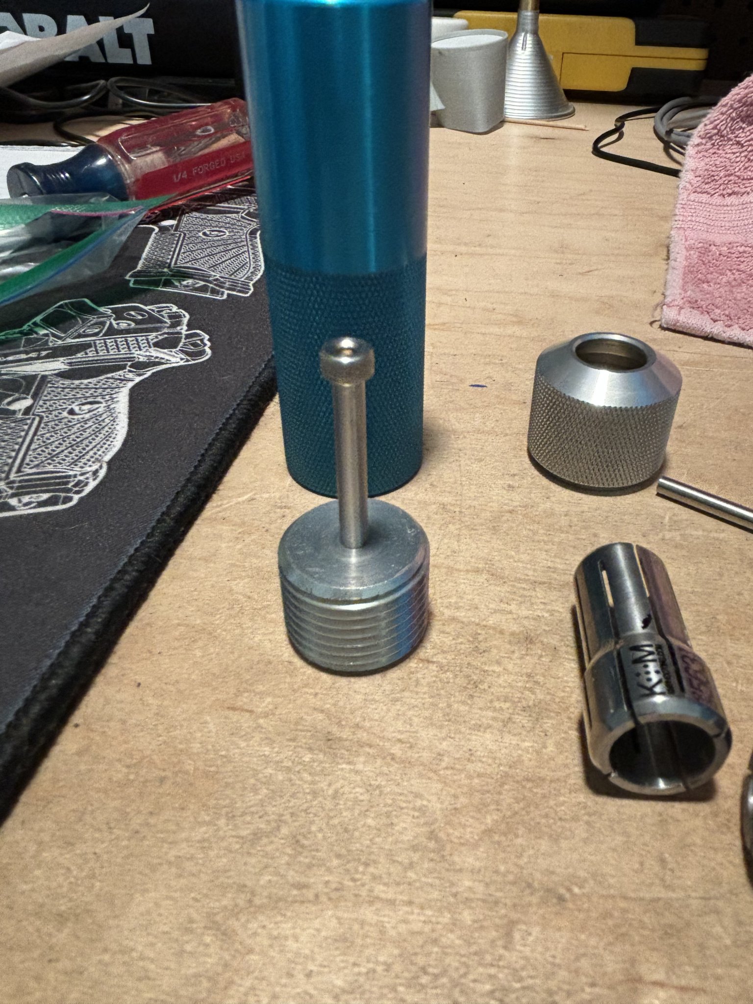

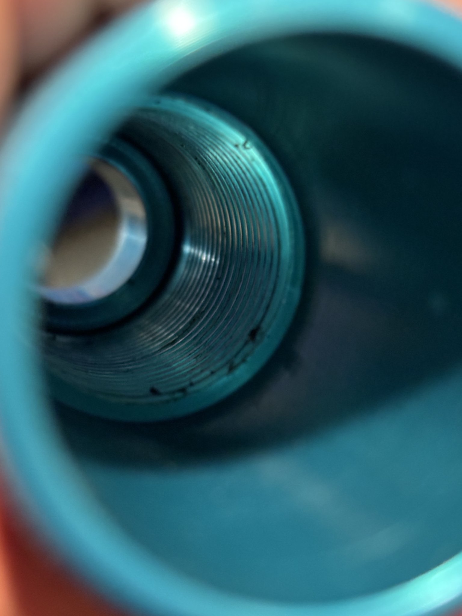

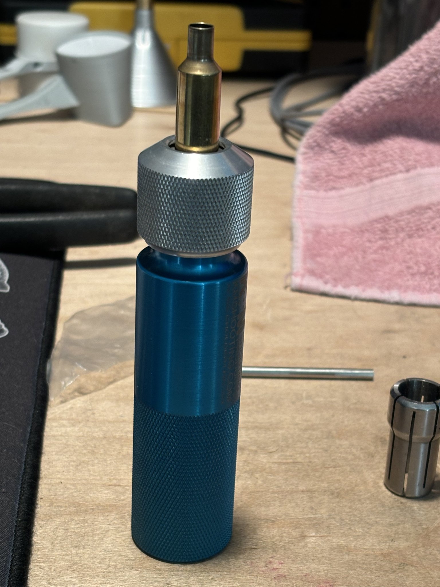

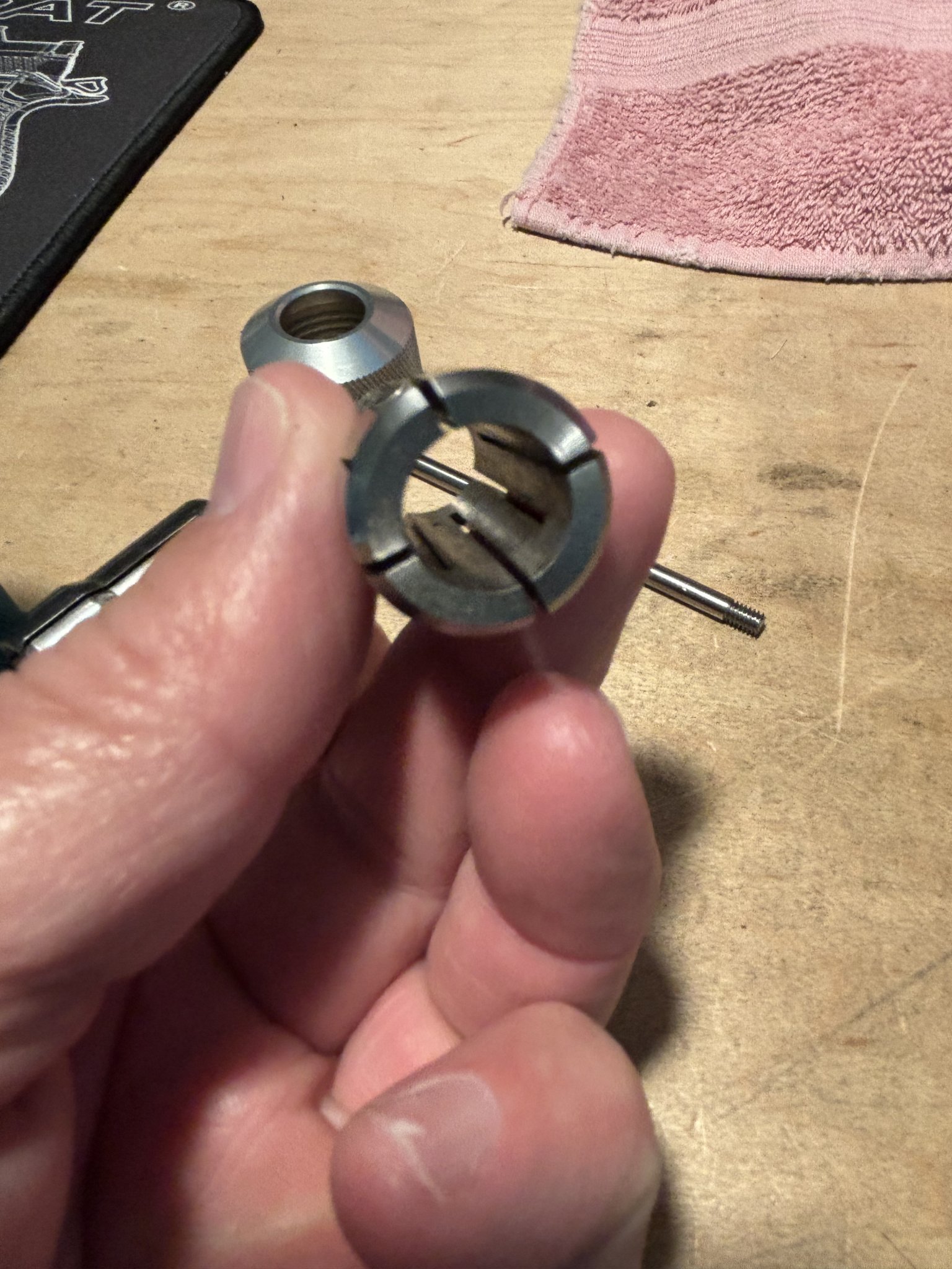

Here’s how the holder works the collets are not tapered if they are it is a VERY slight taper, this tool would be easier to use than the shell plate tool and faster and it holds the case centered and solid.
