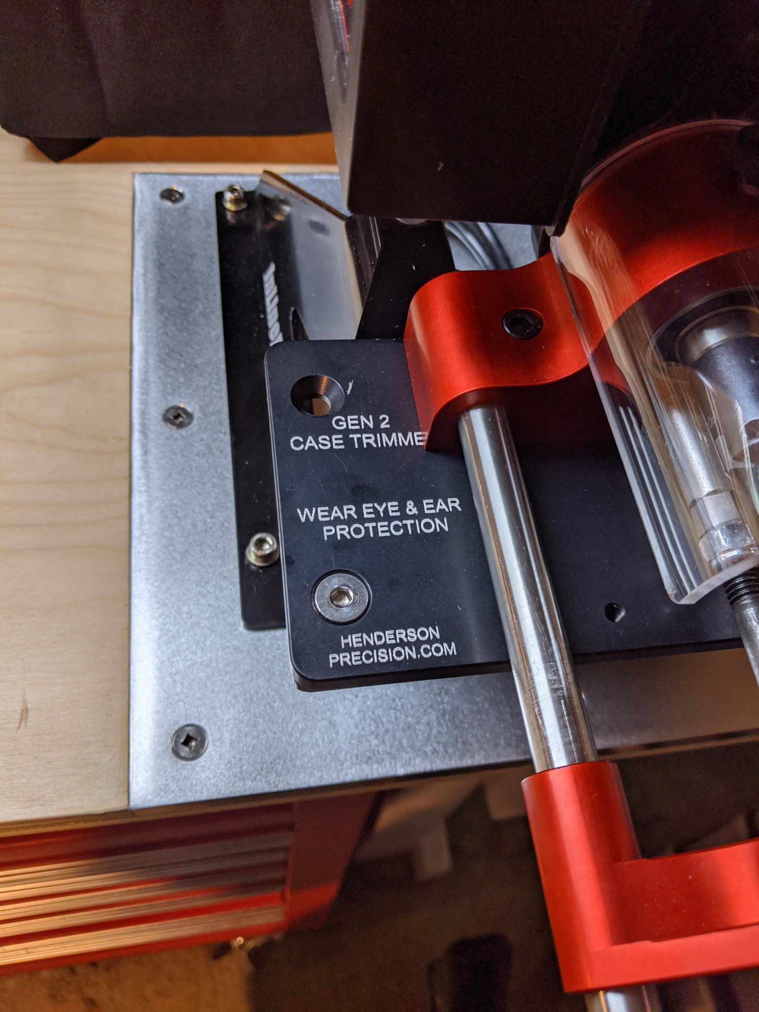

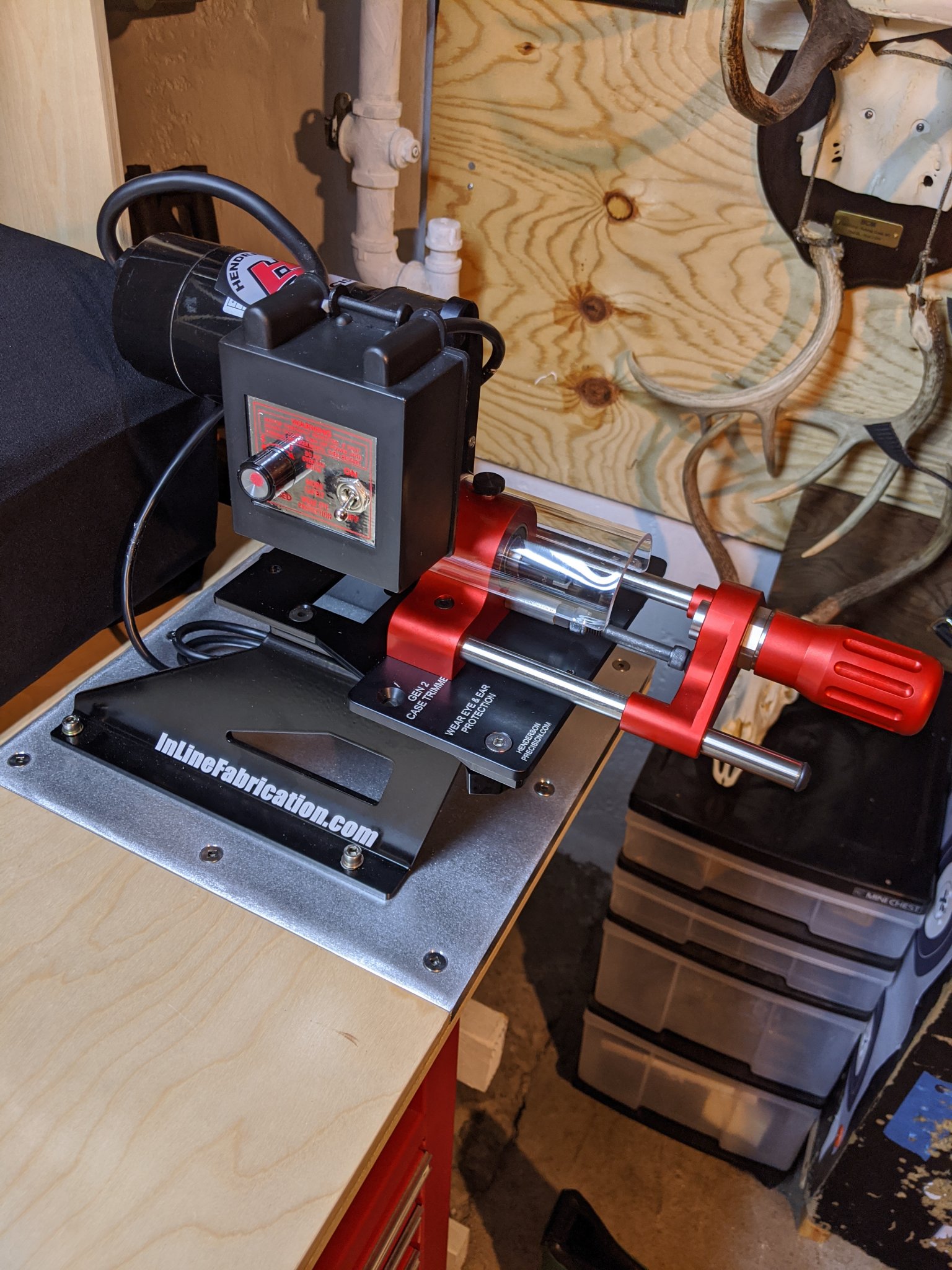

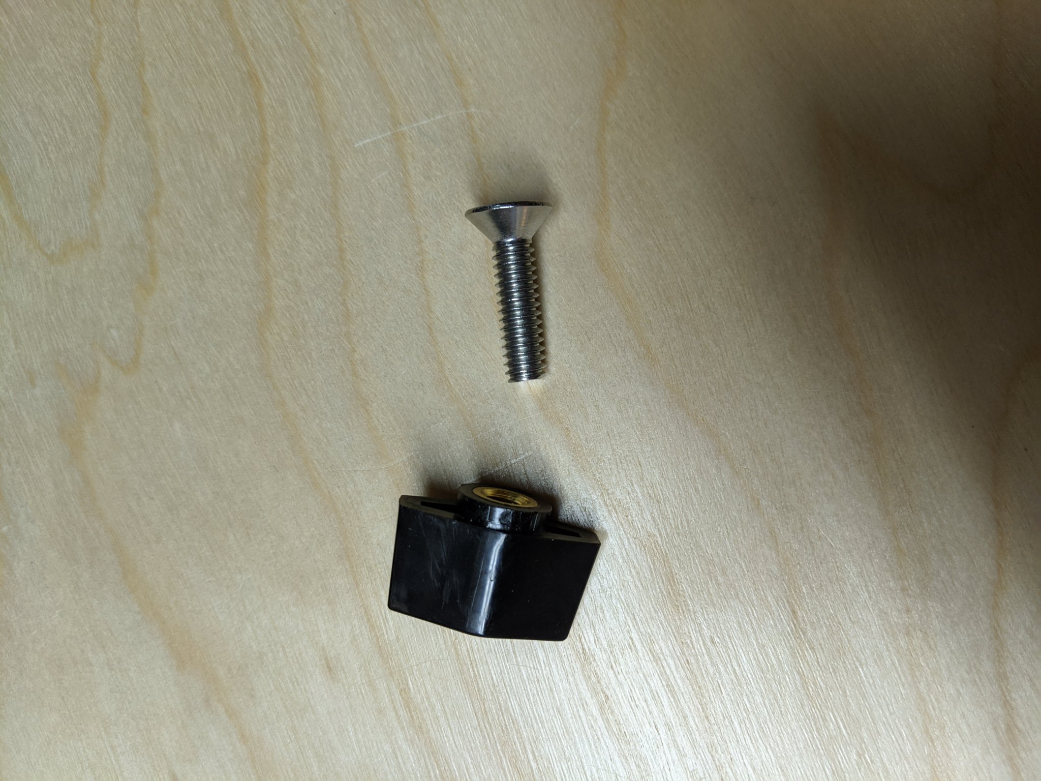

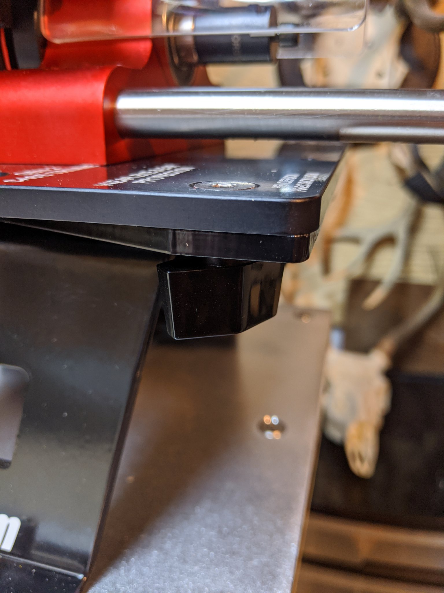

I have mine mounted on an inline precision mount, but didn't buy a blank plate even. Two 1/4-20 x 1" bolts with T-Nut on the bottom (Thank you, McMaster Carr, again...), the henderson base plate has two of the 4 holes that match up exactly to those on the inline precision ultramount.
Tagging in, another Henderson owner here. Haven't used it a ton so far, but picked it over the Giraud because Giraud would have been more expensive for me once I got set up for multiple calibers.
Picture? I have an old Dillon 1050 mount that I could use if it adapts...
