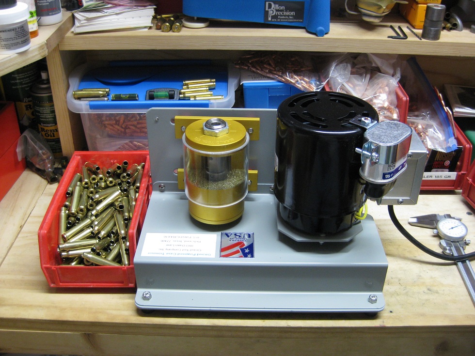

I thought id go ahead and confirm the already pretty well known fact that these trimmers are awesome. I received it a week after ordering it, and it was packaged very well! I had to do a small adjustment to the depth for the brass length but that only took about 5 minutes.
The trimmer is fairly quiet and the trim length adjustment was pretty easy to do.
Once up and running i did about 1500 .223 cases in 1.5/1.75 hours. its incredibly fast. Of the cases with matching head stamps, they were all within the .001 tolerance that was advertised. In-fact, most of them were right on the dot.
The only real improvement that i would say is that instead of coming with a standard nut, id like for it to have come with a lock ring like the Hornady dies. It wasn't a big deal to buy them separately, but for the price it would have been nice to have that included.

yes, you need additional case holders at the minimum iirc they are $30. thats where i recommended getting the locknut. they keep you from re-setting the cutting depth each time you change a caliber.
if you want to do like i did and keep all re-calibration out of a caliber change, get an additional cutter head as well. then you just have to quick change out 2 parts and then you are good to go. i belive the cutter heads are $45.
when you order it, it comes setup for one caliber already.
as far as pictures, ill have to taek some later today when i get a chance. heres a picture of it and a video from online. they are about 10-11" wide and about 7" deep. pretty small all in all.
