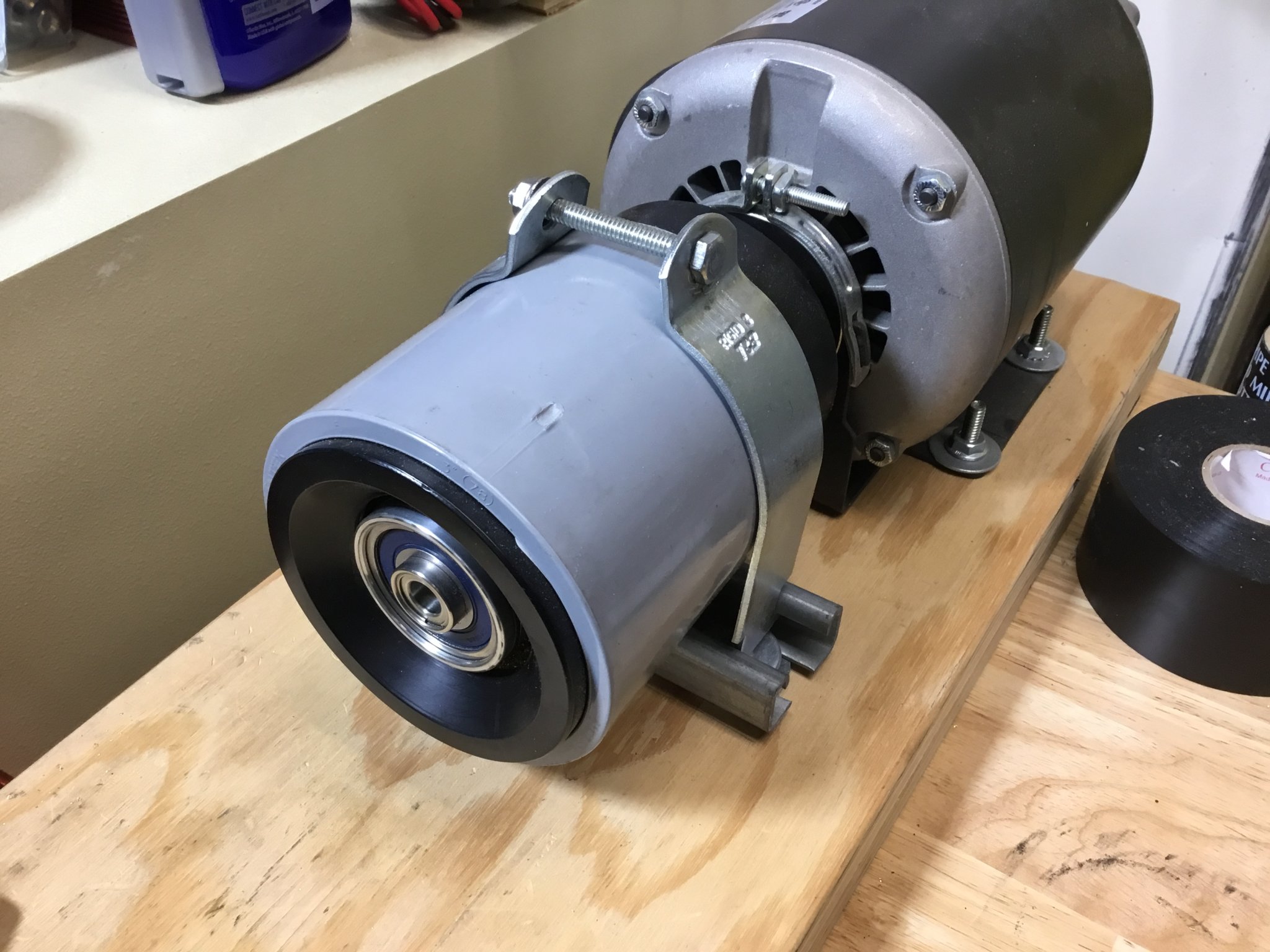

Here is mine, its connected to a motor with a rpm of 1700 and I control it with a foot pedal which you can buy at harbor freight. I put a pvc coupling over the trimmer with a abs reducer to catch all the brass trimmings.

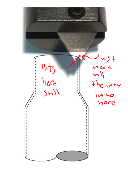

If the case doesn't need trimmed, say hasn't stretched. Will it still chamfer and debur? and how easy is it to change out calibers?
While my fired brass doesnt always grow enough to reach all the way into the depth of the cuttter blade to cut down the over all length it will still usually hit the inside edge enough to clean up the chamfer. I run every single piece through the giraud every single loading.
Rangemaster, I really like your setup. Was getting ready to fab something up, and was wondering if after using it, you would change, or do something different, if you had to do it over? Had you ever considered mounting it vertically so the trimmings would fall? Ever had issues with it not clearing the trimmings? Just thought I'd ask. Like I said, really slick set up. Good job!
