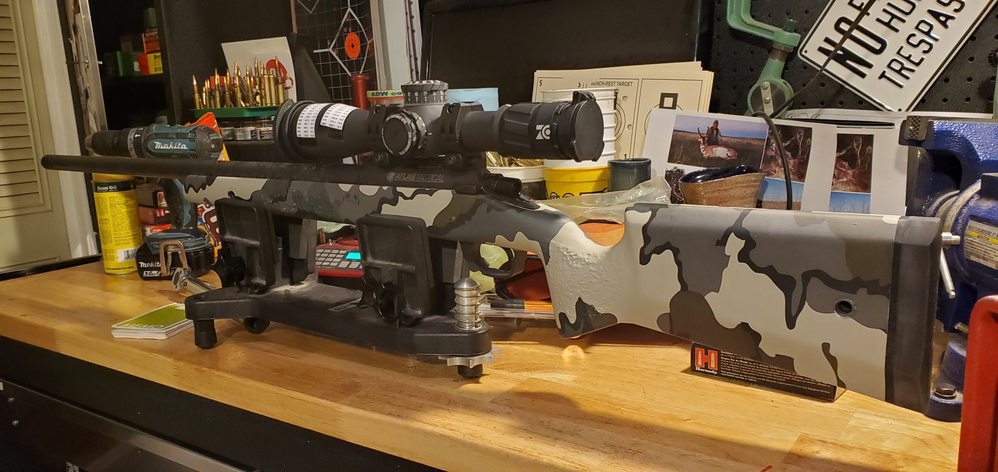

I run a TT315M on my 6CM and have run it out to 1700+ with no issues. Coyotes don't stand a chance out to 1200+.
Another on a lightweight mountain .280AI elk rifle.
My ZCOs are on a 25SST and a future 6.5SS suppressed shorty I am currently building. Both long range deer/pronghorn rifles.
