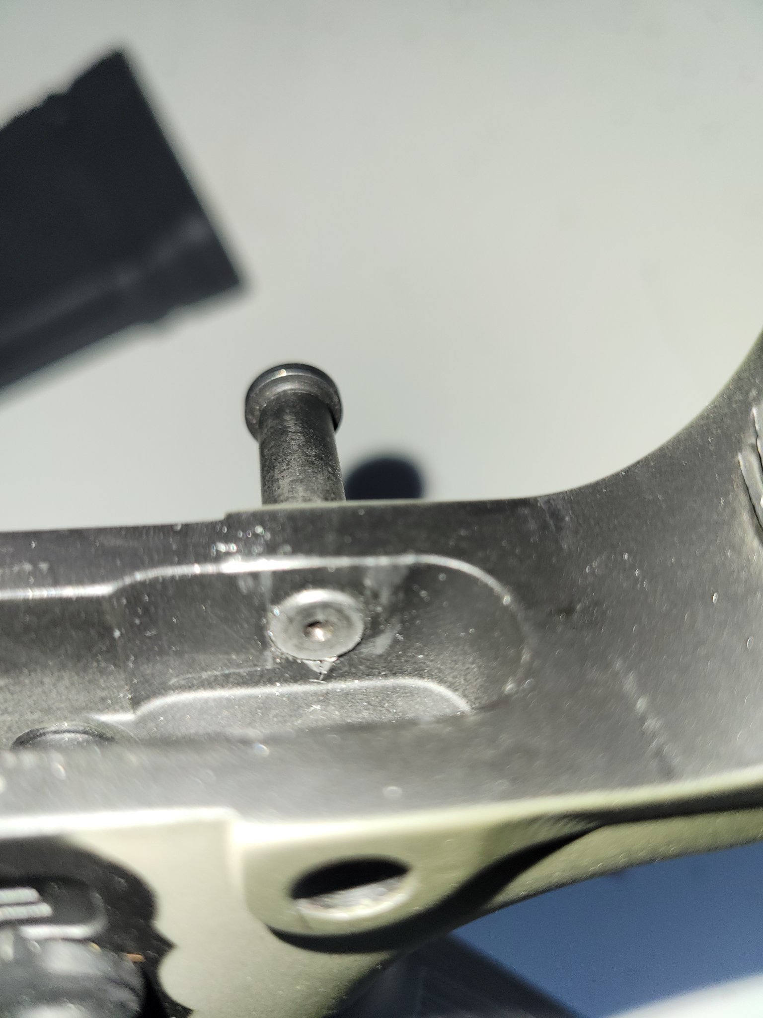

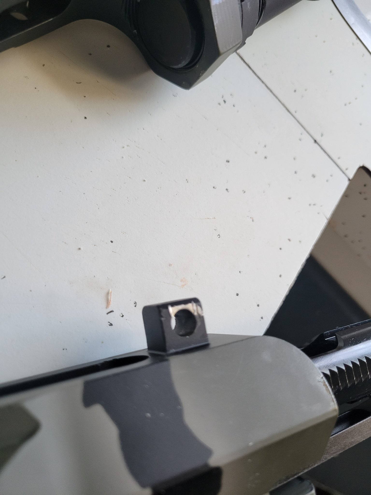

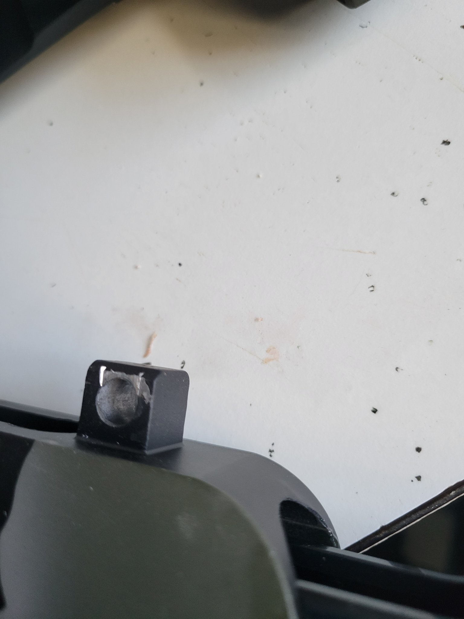

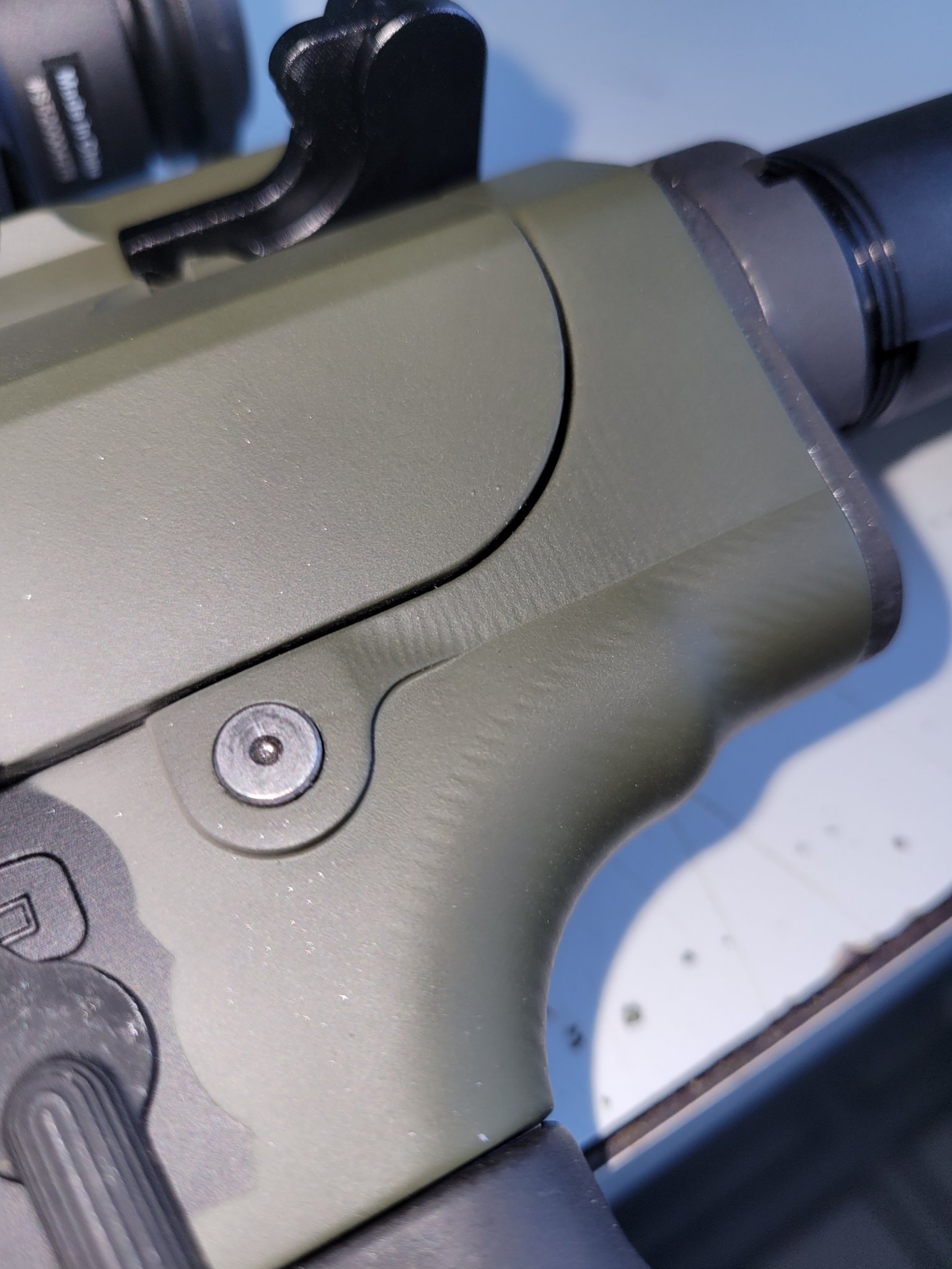

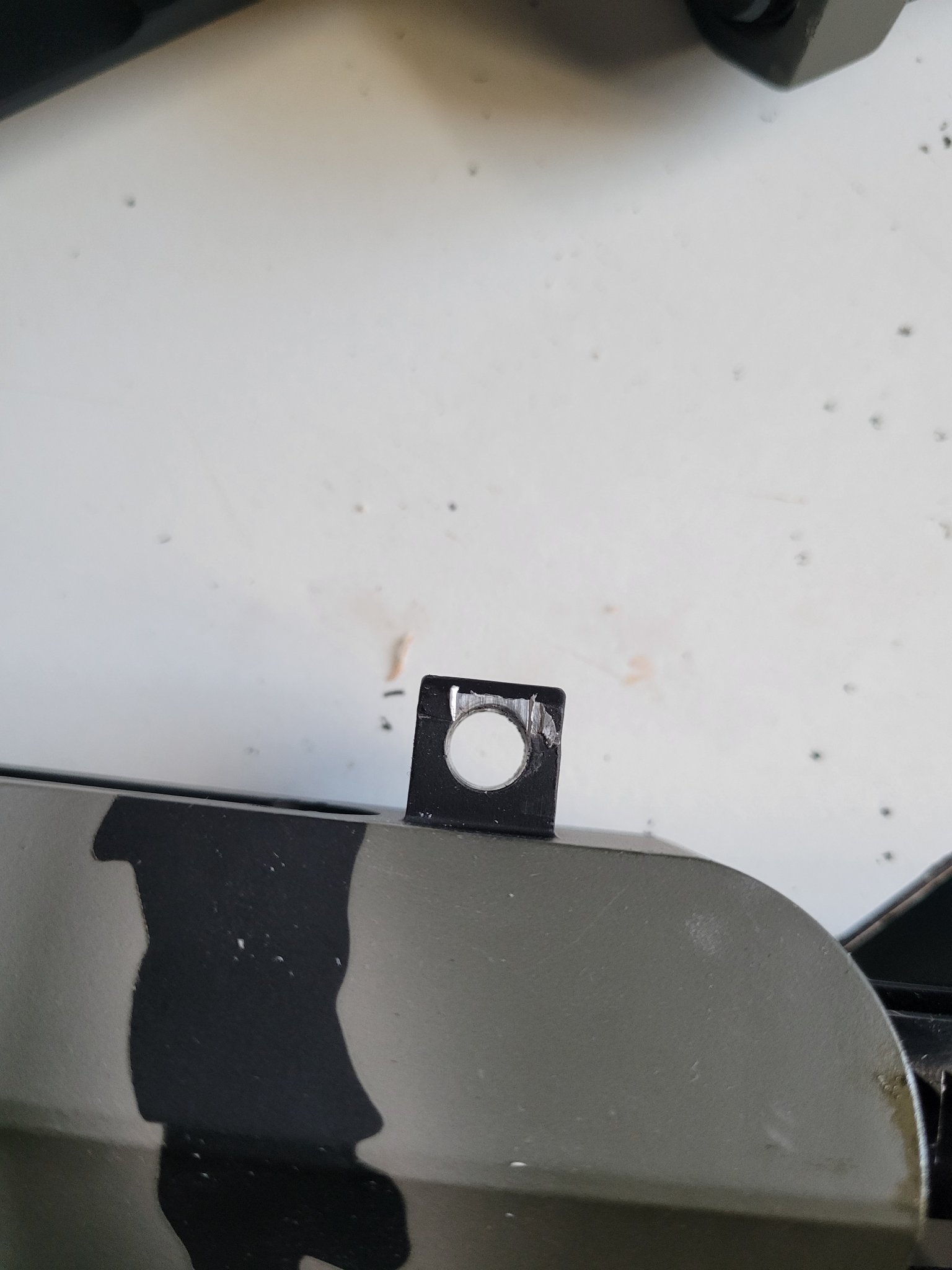

I might stay away. It does look cool, but the fit and finish on my 308 are sub-par. If they havent perfected the 308, then im sure the 300 win mag is lacking as well

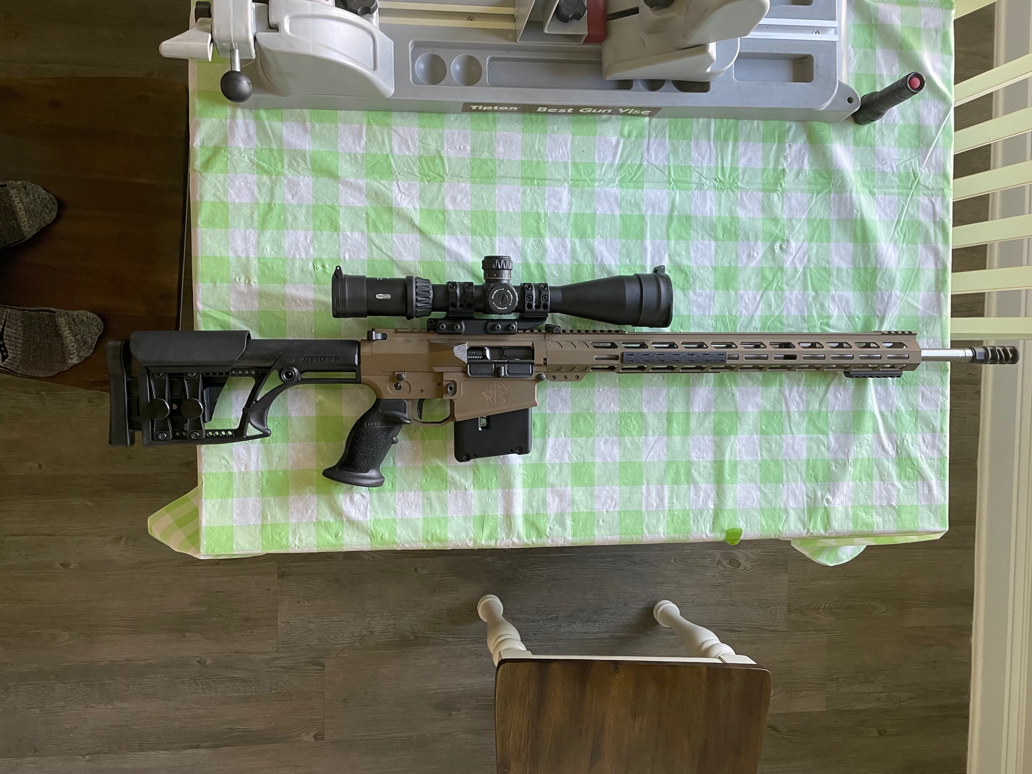

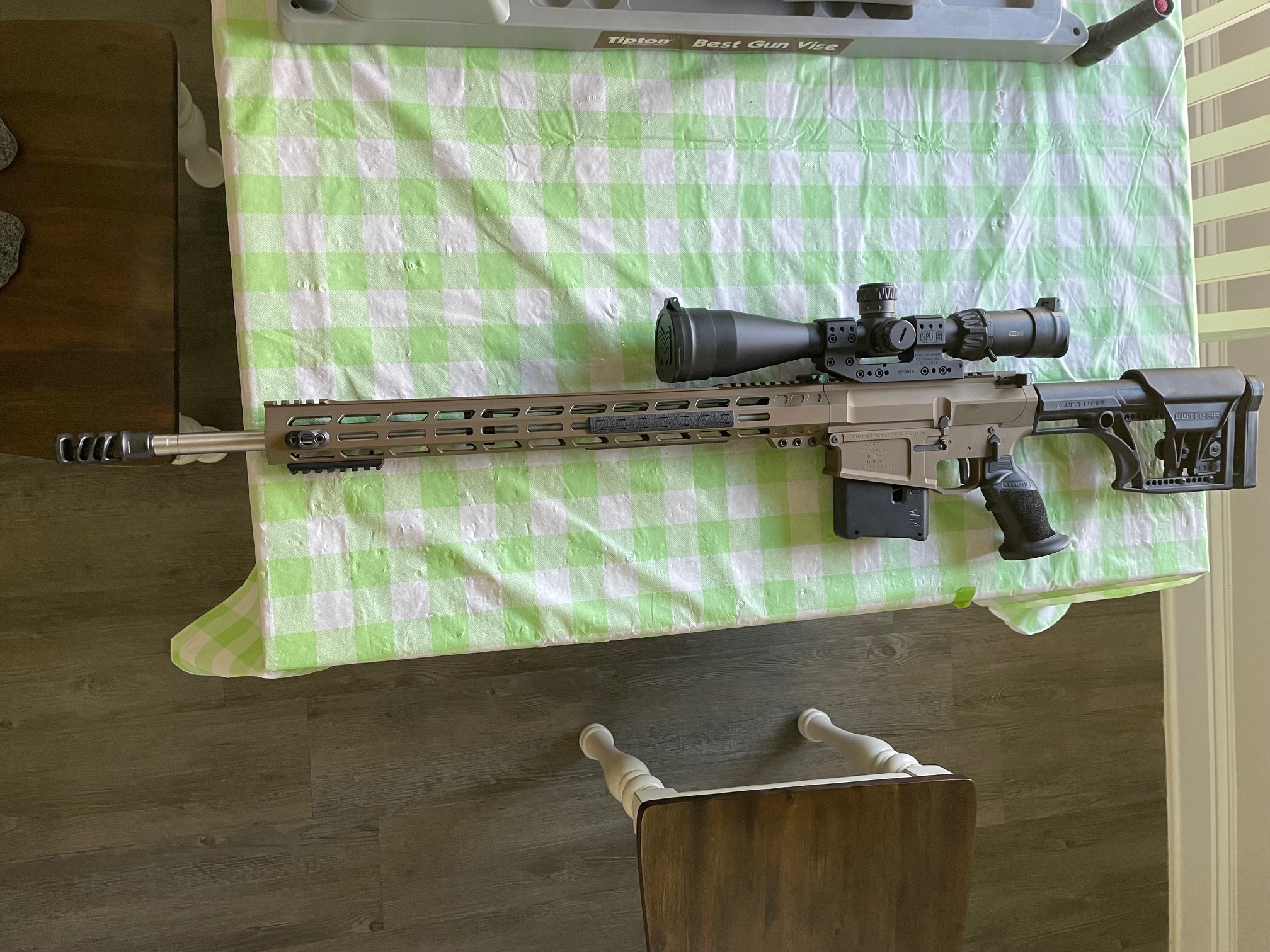

Well I happen to own one. It definitely looks better than the 308 version pictured in this thread. Hand guard and lower have no burrs. Or sharp edges. Upper receiver had some burrs. But that was simple enough to take care off. Very little play between upper and lower. Took a look at the rifling and Crown. And they look excellent. No excess machining marks. I literally went through the whole rifle. Every part was nice and tight. I did find a few nicks on the buffer. Which was from the factory test firing it. Had to install an off set Galloway precision off set buffer pin. I did the standard test on the lower. Put it on safe. Squeeze the trigger. Watch for the trigger pins to move. And they Didn’t wiggle in the least. Which is a good sign. When I installed a picatinny rail and sling attachmen. They literally fit perfectly. No play back or forth. One thing that I don’t like is they use a roll pin to hold the firing pin in place. BCG is nitrided finish. And the only thing that looks standard is the cam pin. Which I will be replacing with a POF roller cam pin. I did replace the buffer tube spring with a Tubbs flat wire spring. I also installed a Larue MBT trigger, LMT muzzle brake, Luth grip and PRS stock. Had to go with a Luth stock. Because of the longer then normal charging handle. I had to move the cheek riser back to clear. I also replaced the charging handle latch with a extended one from Strike Industries. Magazine is really heavy duty. They only offer a five round right now. I did send an email and they claim they will have a ten rounder in the future. Took it out to the range. To sight it in. Loaded up some test rounds. Every thing went great. Recoil was not a issue at all. I wasn’t going to buy this rifle after reading some of the negative comments on this forum. So I looked on the internet. And everyone that bought one was happy with theirs. Right now with my starting load I‘m shooting one MOA with 185 grain Berger VLD bullets with MP 700 powder. The powder is a bulk powder similar to Accurate Magpro. Ejection is around three to four o’clock. Brass looks like I shot it out of a bolt gun. No case swipe or grated primers. So I just loaded up some more that are slightly hotter. Searching for a node between 2700 -2950 FPS. Will update once I have worked up a load that I’m happy with.

Took it out to the range yesterday. Finally settle on 75.2 grains of MP700, COL 3.36, 175 gr Sierra Match Kings and Hornady cases. Ejection is at two o’clock. Brass looks great. No pressure signs. It is still a one MOA gun. Which is fine for me. It shot the Berger VLD excellent. But then I started to have feeding issues. Had the same problem with them in my AR10 rifles. So went to the Sierra Match Kings. It runs like a sewing machine now. Would have went with heavier bullets. But the 175 grain works well in all of my 308 rifles as well. Going to pick up a new chronograph from Garmin soon.
