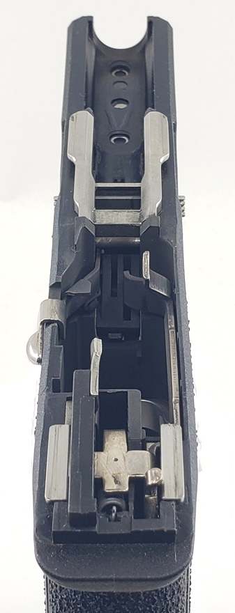

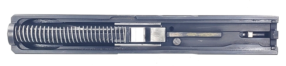

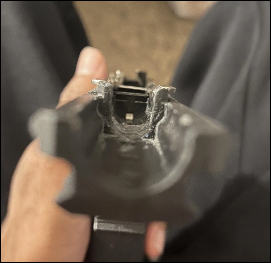

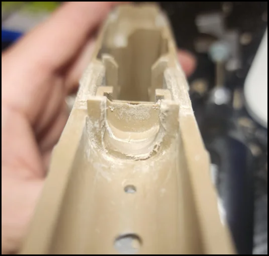

But, in your case, it may be something else, AS WELL. How does your RSA channel look in the frame? Seeing some photos of the inside of your frame would help. Like these:

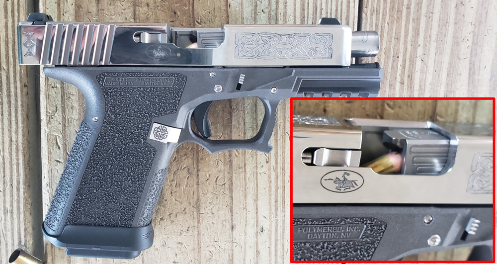

Also, if the slide lock spring isn't seated completely, it can interfere with the recoil spring assembly. Is your slide lock spring protruding into the channel? Or is it flush, like this?

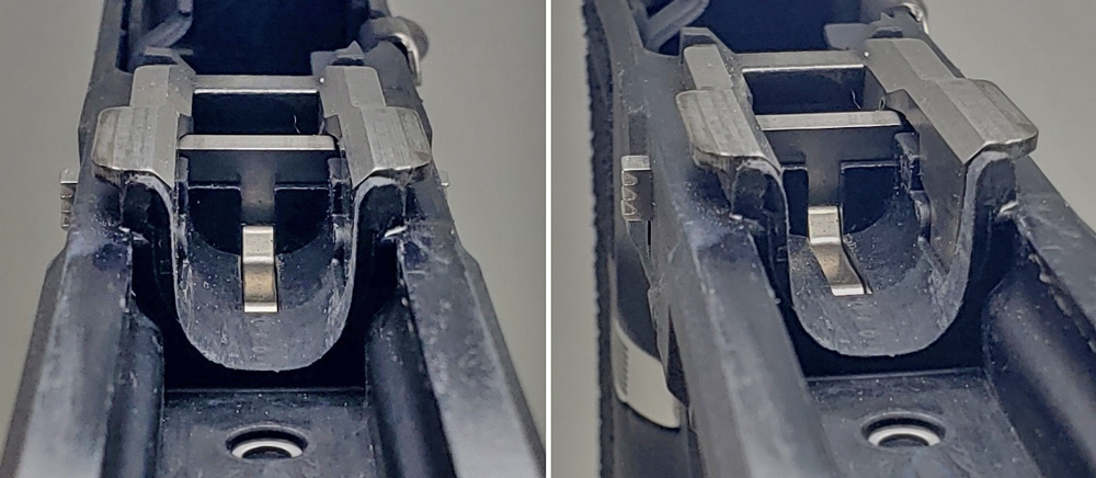

Are you rails level? If you put the slide on the frame with only the rails installed... Does the slide move easily on the rails? Or is there friction?

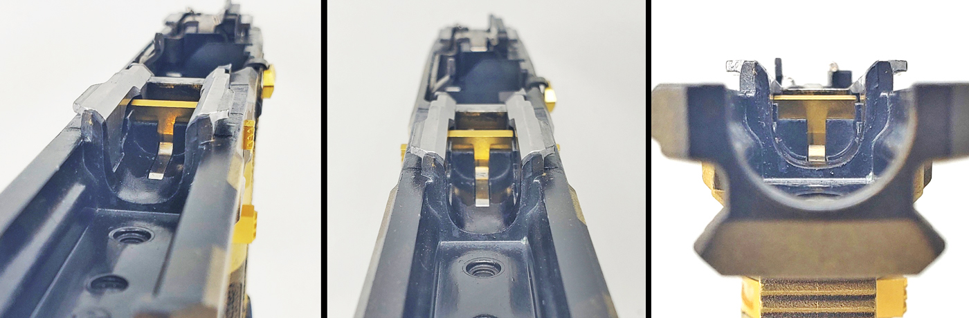

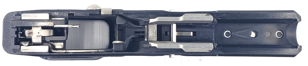

Other photos like these can help, too:
Lastly... for your internal frame and slide parts... OEM Glock? Or aftermarket?

Photos or it never happened! :) But yeah... photos of the RSA channel would help. I've seen a lot of them that the builders THOUGHT were finished... but not so much. :)
For most of my builds, I use OEM Glock RSAs. For the "Tank" build pictured previously, with the ported barrel, I used an uncaptured spring from Wolff Springs on an RSA guide from Rook Tactical.

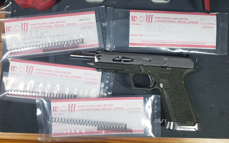

So... the RSA channel cleanup helped... maybe. With the 15lb spring--being cocky, I went back to that--it ejected cleanly but didn't feed. I will probably clean it up a bit more.
Next step is to try a micro comp, mostly bc it came in the mail this afternoon and looks cool on the pistol.

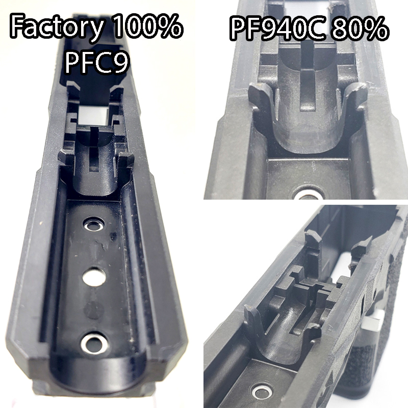

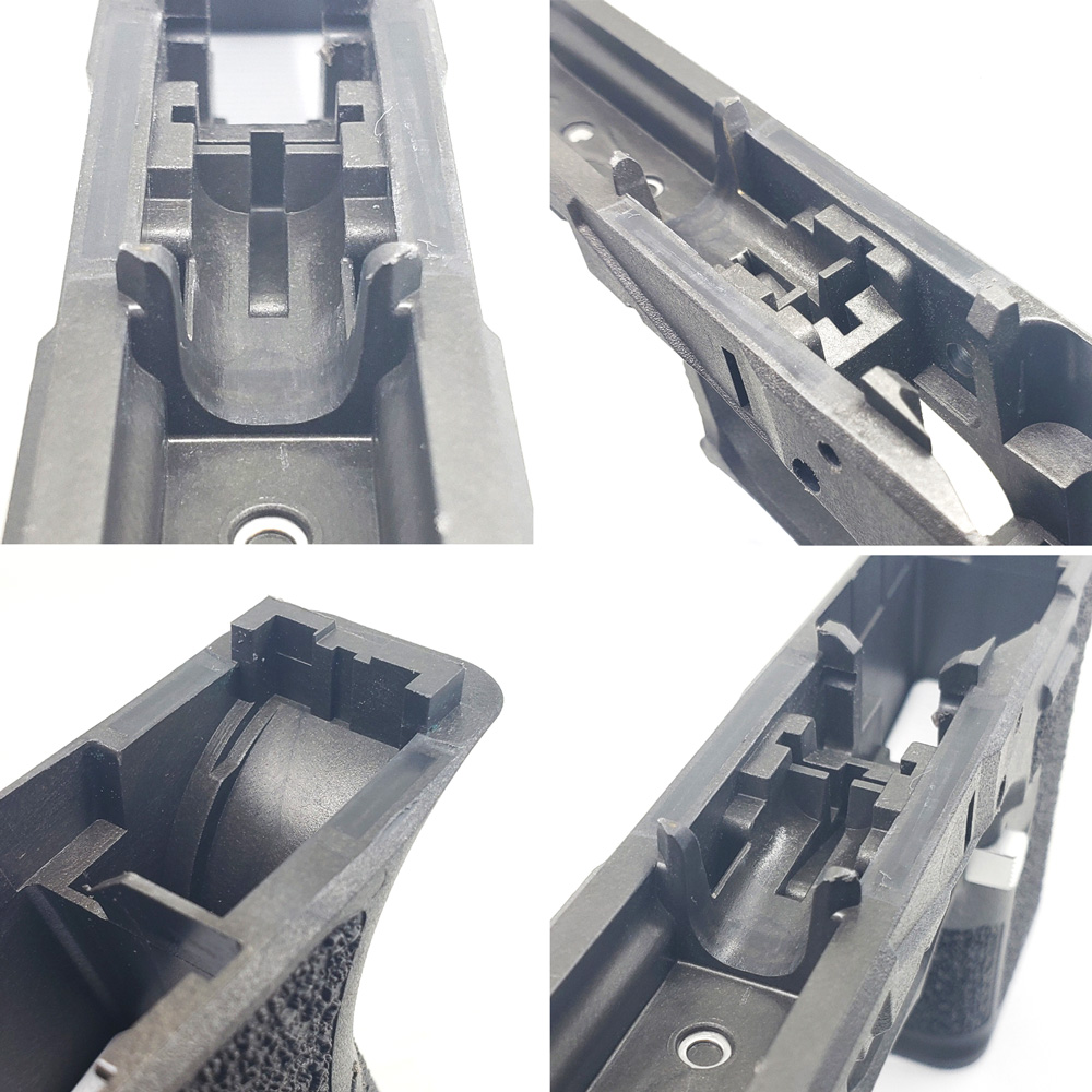

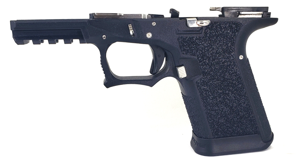

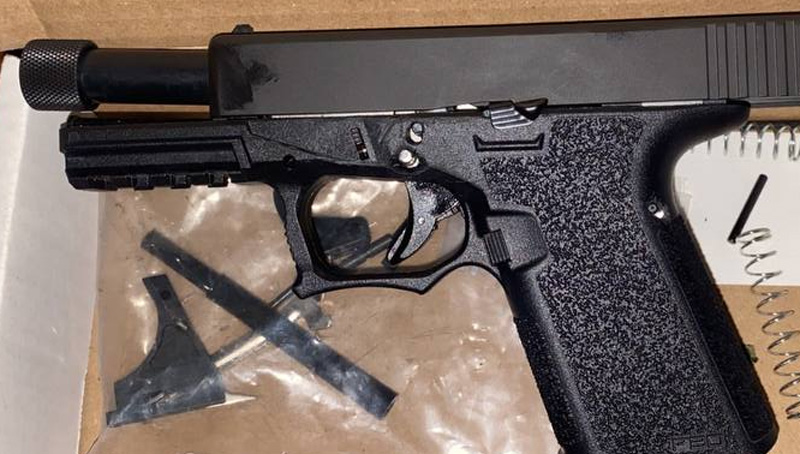

Here's a factory finished (and serialized) P80 frame on the left vs my 80% P80 frame on the right.

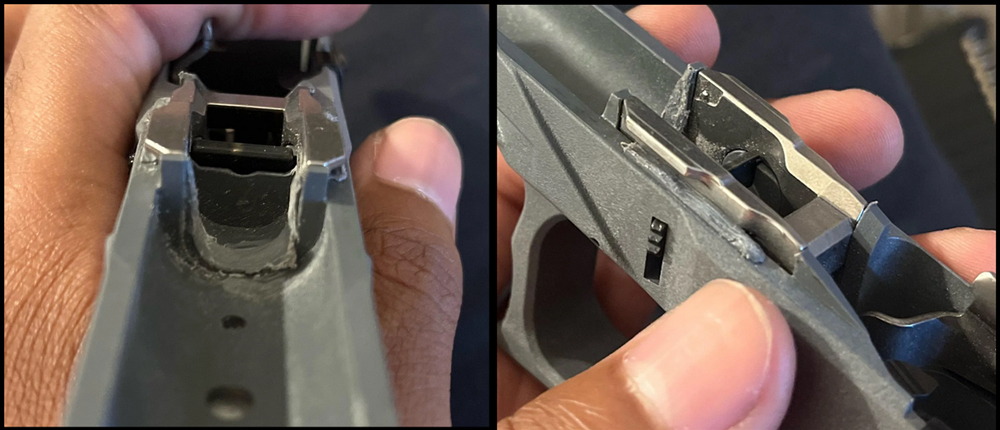

Another one of my 80% frames:
But this is what we also see "out there" with questions, "Why won't my build cycle?"

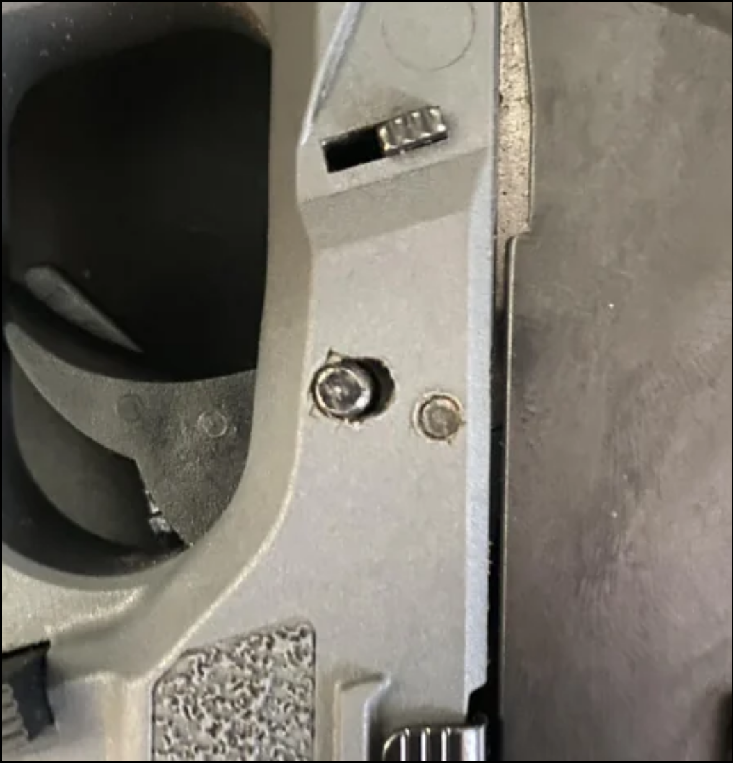

This is basically what I am going to do. I ordered a kit with a few color coded springs, because the various springs I did have fell into a big jumble and I pulling my hair out trying to assess which ones are what weight. So I am starting over.
Once the springs arrive, I'll work more methodically with the various spring/ comp/ no comp options.

In case any of you having been biting nails awaiting this story's conclusion...
I put in a different recoil spring and rod, picked a 15lbs spring and it cycles fine. I ran out of 115 gr, and I have a feeling it might hiccup with that, but with a few 124gr commercial loads it was fine.
