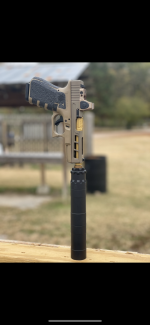

I picked up my rugged obsidian 9 suppressor today, and headed to the range.
The gun/host:
Glock 19 (slide was sent in to be cut for optic).
NineX19 threaded barrel
Factory internals

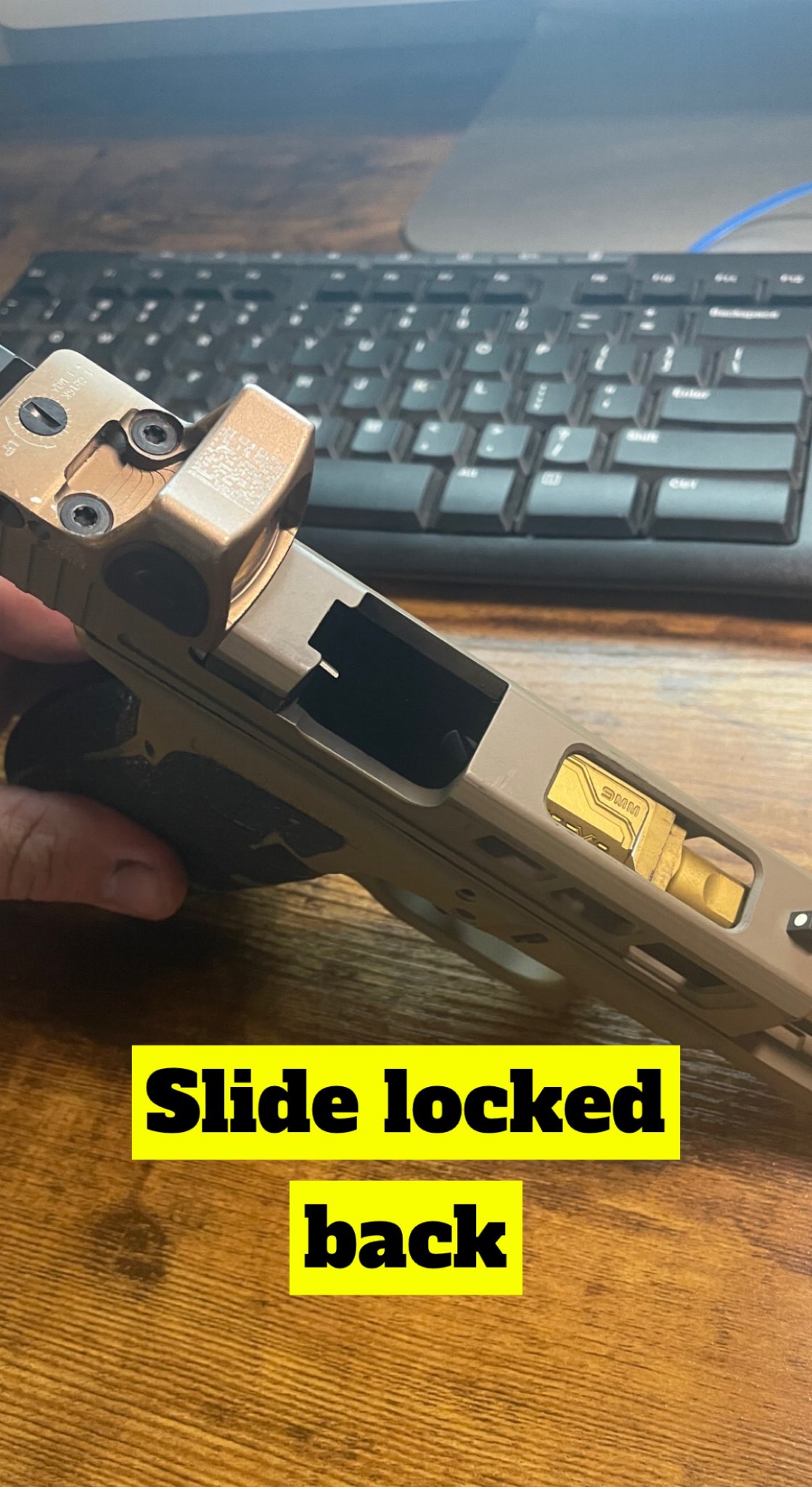

After mounting the supressor, I fired the first shot. Slide locked back, past the slide lock position. I could not get the slide to go forward. What I found was, the slide reciprocated so far back, that the barrel caught the slide cuts.
The obsidian 9 has 2 configurations. The full length, and half length. I tried firing some rounds down range with the supressor in the short configuration. Same problem occurred, however I was able to get at least half a mag down range, before the jam.
Note: The gun cycles just fine without the suppressor
I’m thinking the gun may be over gassed? I was speaking with a buddy at the range, he believes that the slides reduced weight (due to the cuts), is causing the gun to cycle extreamly fast/hard, with the added weight, and pressure from the suppressor.
I’m wondering if changing the recoil spring/rod would help?
Any advice/help would be greatly appreciated!
I’m going to attach a few pictures.

No gas system, can't be "over gassed."
There is no way for the slide to go back further or to lock on anything other than the slide stop/release lever. Unless parts are broken or the wrong parts are installed.
Wrong parts, broke, or assembled wrong.

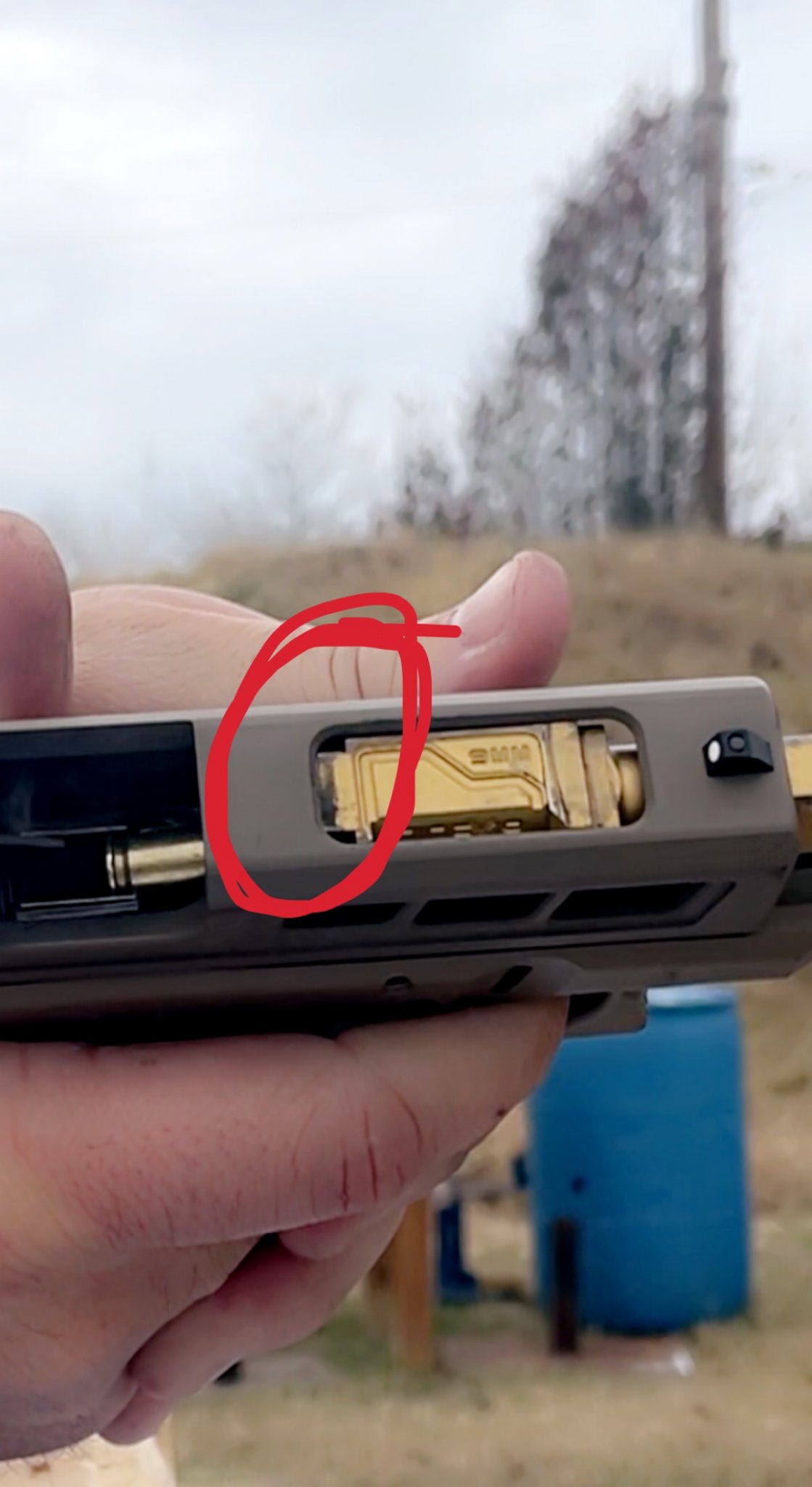

Thanks Zach for the input! Iv attached a picture where the barrel is catching the slide. It’s interesting because this is never an issue shooting without the Supressor

It's hard to tell from the photo, but when I rack a G19 fully it doesn't go back as far as the one in your photo #2 based on the relationship between the last cocking serration and the rear of the frame.
Are you sure you don't have a "Gen" mismatch between the barrel and the gun?

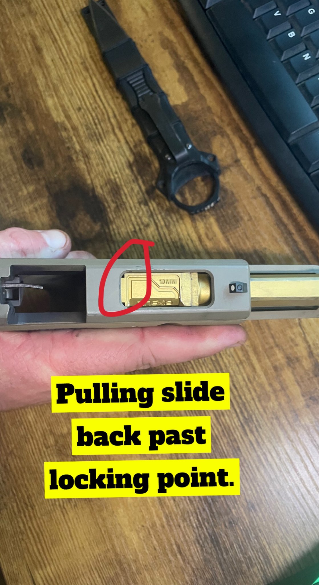

Look, the mere fact that you can lock it back some further point past the regular slide lock point is proof that this combination of part/mods is fucked.
Zak...I have another glock 19 completely factory in front of me. I just locked the slide back...in order to drop the slide, you have two options... either use the slide release...or pull the slide FURTHER back, and let it go...

No Glock is supposed to do that. Pistol is fucked regardless of the suppressor. QED.
Either it has the wrong parts, it's assembled wrong, or it's broken. I'd put faulty milling in category #3, if it that turns out to be the case.

Your problem is that you had a perfectly functional slide milled out so that it looks "cool" and whoever did the milling was a moron.
Your barrel locks into that cut when the can is on there because all that weight hanging off the end of your barrel levers the rear of the barrel up into the idiot hole some moron machined into your gun.
Unless you specified the exact dimensions and locations for those holes, the "gunsmith" owes you a new factory slide plus a refund for the cost of milling.

I should add that the reason that hole is a problem is that the slide reciprocated rearward PAST the point where the slide release holds it, then comes forward slightly to rest on the slide release.
I would bet you the guy who did the milling measured his cut based on where the rear of the barrel hood was when the gun was locked open, and not when at maximum rearward travel.
This has nothing to do with your can or slide velocity or anything like that. It has to do with a gunsmith whi is far too much like most gunsmiths and has no fucking clue how to understand at an intuitive and minute level how a gun actually runs as a system. He can tell you what each part does but he cannot see them all working together in his mind in 3D at every point in the gun's cycle.

As said by MK20 and Zak Smith, your slide cuts screwed up the slide. Those cuts are kind of stupid anyway; they're just windows to let trash inside the gun, and the reduced slide weight is NOT a benefit unless you're competing with very light loads. (The only benefit of that lightweight slide is the ability to cycle lighter loads.)

The solution is to use a slide without excessive lightening cuts that lock up on the barrel hood.
That proves nothing it's designed to go back slightly farther not go back twice as far as it's meant to like yours is.
Thanks for the input.… read the context pertaining to the conversation… never was stated at any point, that slide goes back “twice as far”. That would be a catastrophic failure. With detrimental consequences.
