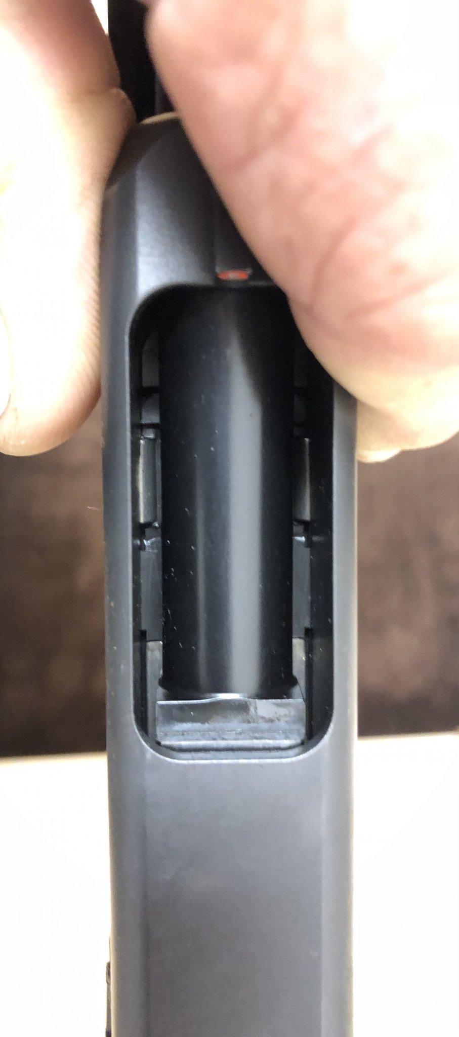

The slide should not be able to get hung on the barrel even with the cut, the rear of the barrel tilts down the first 1/4" of rearward slide travel and starts to rise back up at the same position. Barrel should be tilted down and completely clear the slide.
Most likely gen mismatch or shit parts.
When the barrel tilts down, it slides against the inner top surface of the slide. That’s where it appears to be hanging up.
Look at one of your own slides, there’s wear marks there because the barrel is in contact.
Reactions: Pappyreds
Yes the slide does make contact with the top of flat on the barrel but it is the front (on mine at least)
of the square (where it locks into the slide ) not the rear where this seems to be hanging up.
Nevertheless without phisically examining the pisol its not easy.
Reactions: Yondering
That top cutout window in the slide is your problem. The cutout on an OEM G34 never reaches back to the lockup geometry around the chamber. Not a wise idea to do than on the shorter slide Glocks.
Glock doesn't mill open slides so far rearward that the barrel chamber/hood is exposed when the slide is retracted. The addition of the silencer weight downward on the muzzle causes the rear edge of the barrel to ride against the inside of the slide. The slide was milled incorrectly so now the barrel catches on the barrel hood sized window.
Exactly. Maybe .200" (I'm guessing) of the front of the locking surface is exposed in the OEM window when the slide is retracted.
Yep. Pic is of my G34 slide all the way back to its mechanical stop.
OK I see what you're saying now, got it. That's a fair point.
I wonder if the cutout is wide enough that it's allowing the barrel to lift up in the cutout? If the top of that barrel's chamber area is beveled enough, it might be.
