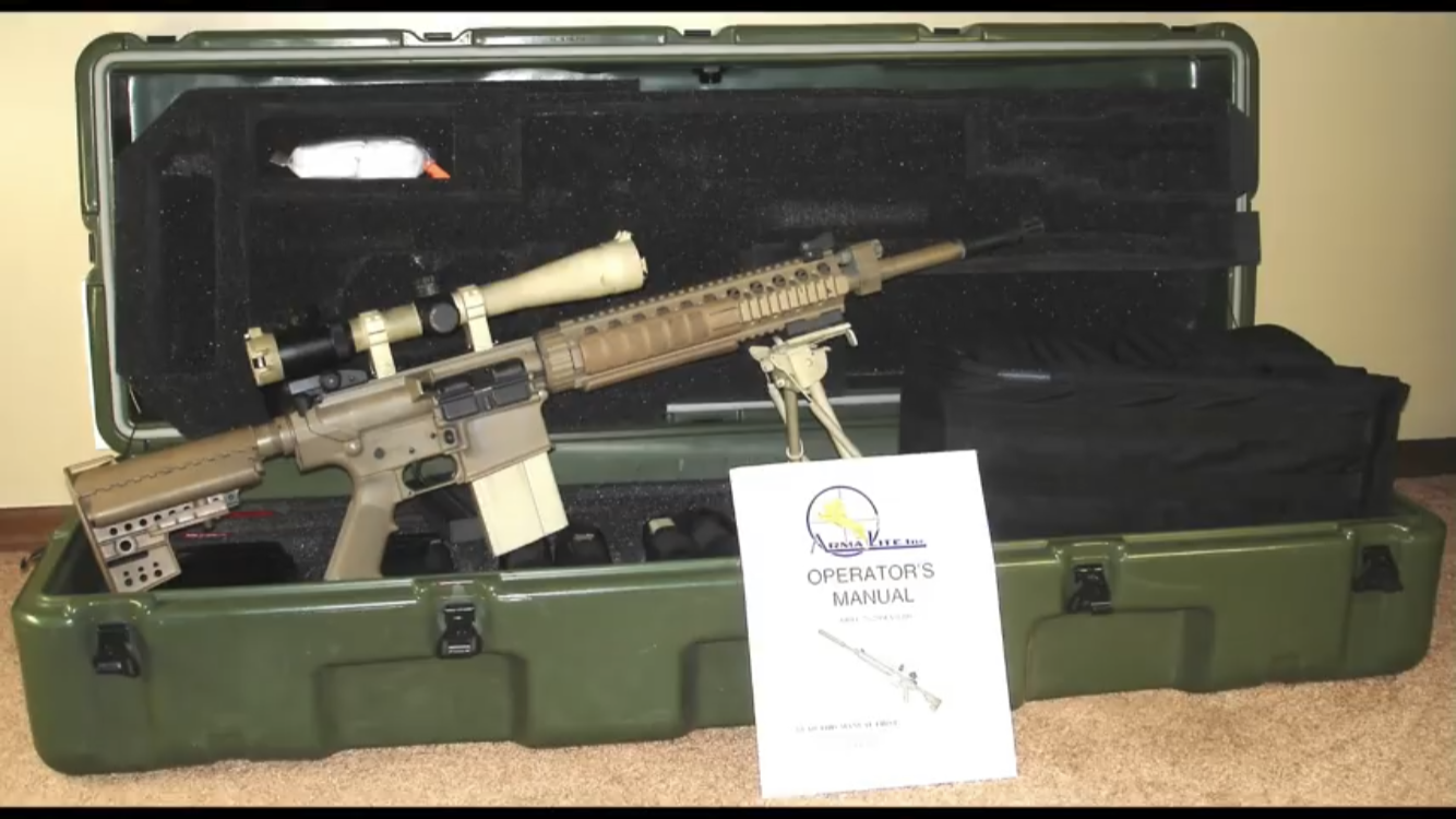

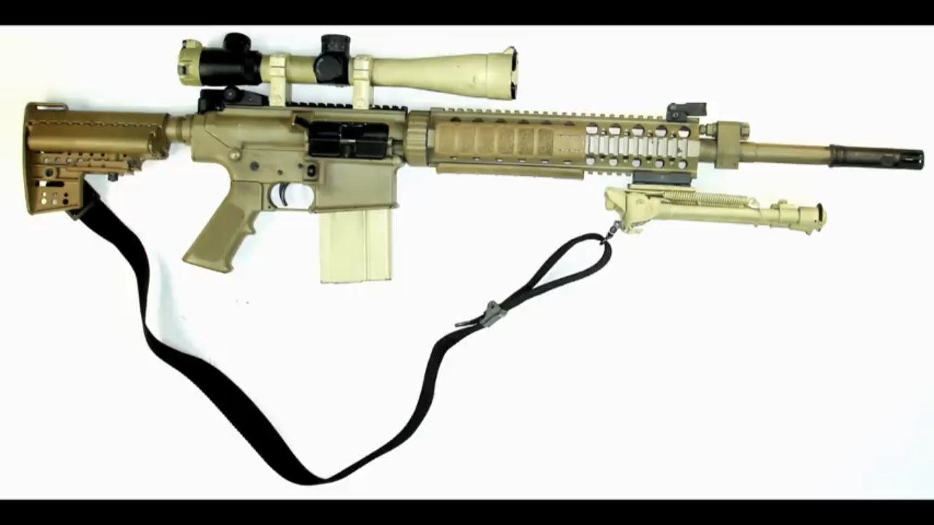

Which Armalite? pre or post 96?
According to Chris Bartocci these are pics of actual rifles submitted for the XM110 trials. Screen shots taken from one of his videos on the Armalite rifles.
I don’t know the full specs of the rifles. I have no official documentation of their performance during the trials.
ETA: In this video, ( ), he mentions JP Enterprises competed as well. I’ve never seen any information on the JP Submission but would love to if anyone has any or could direct me on the right path.
