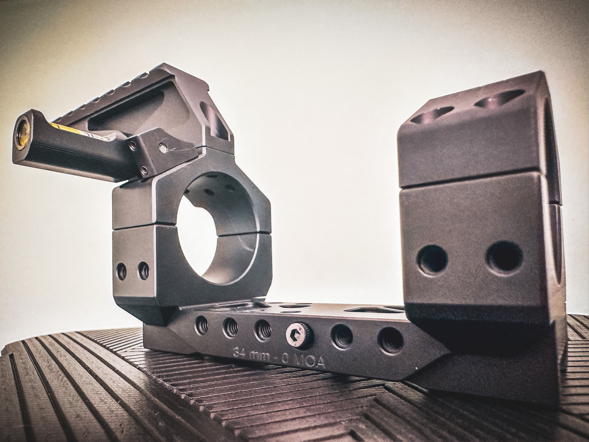

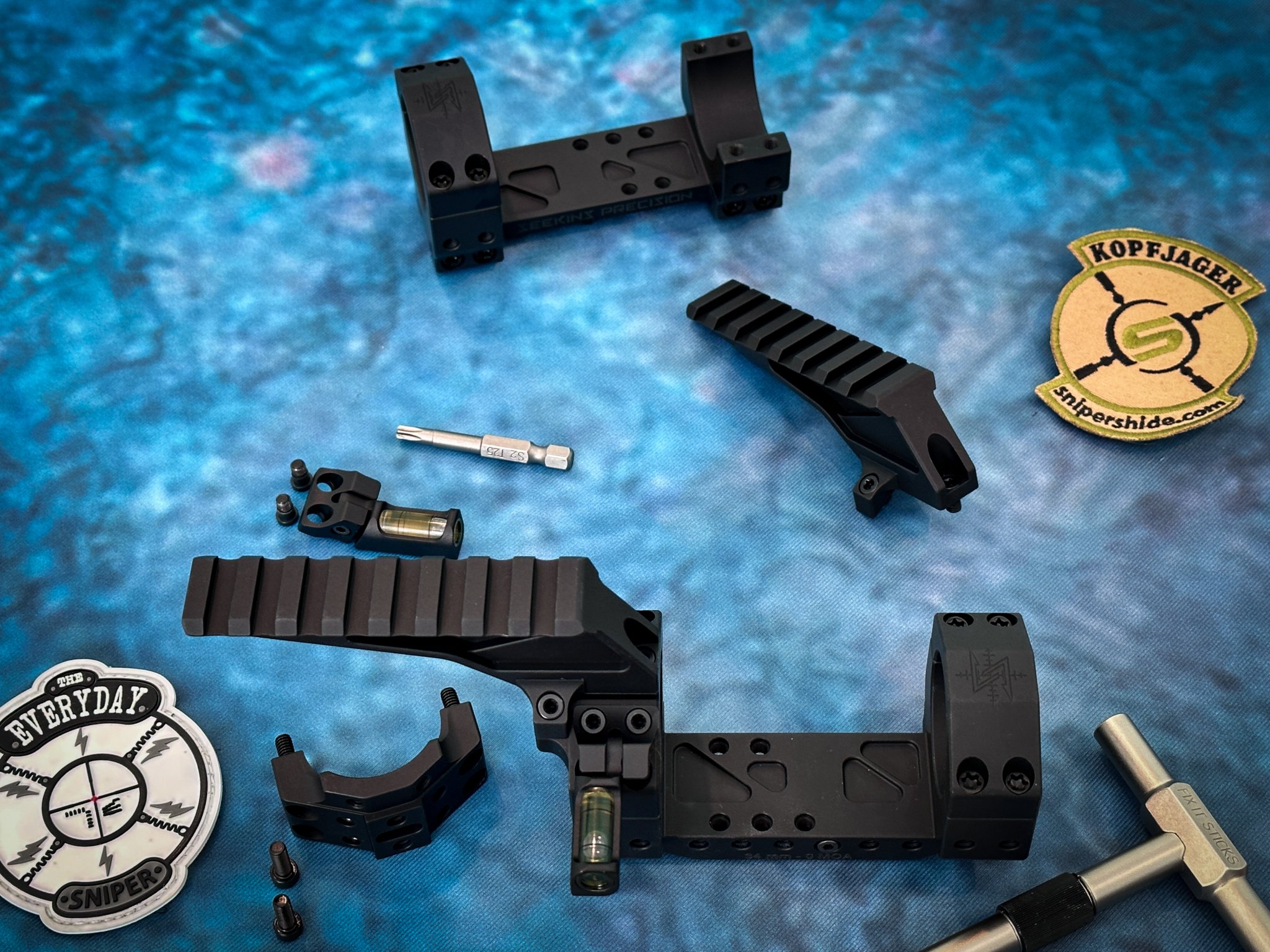

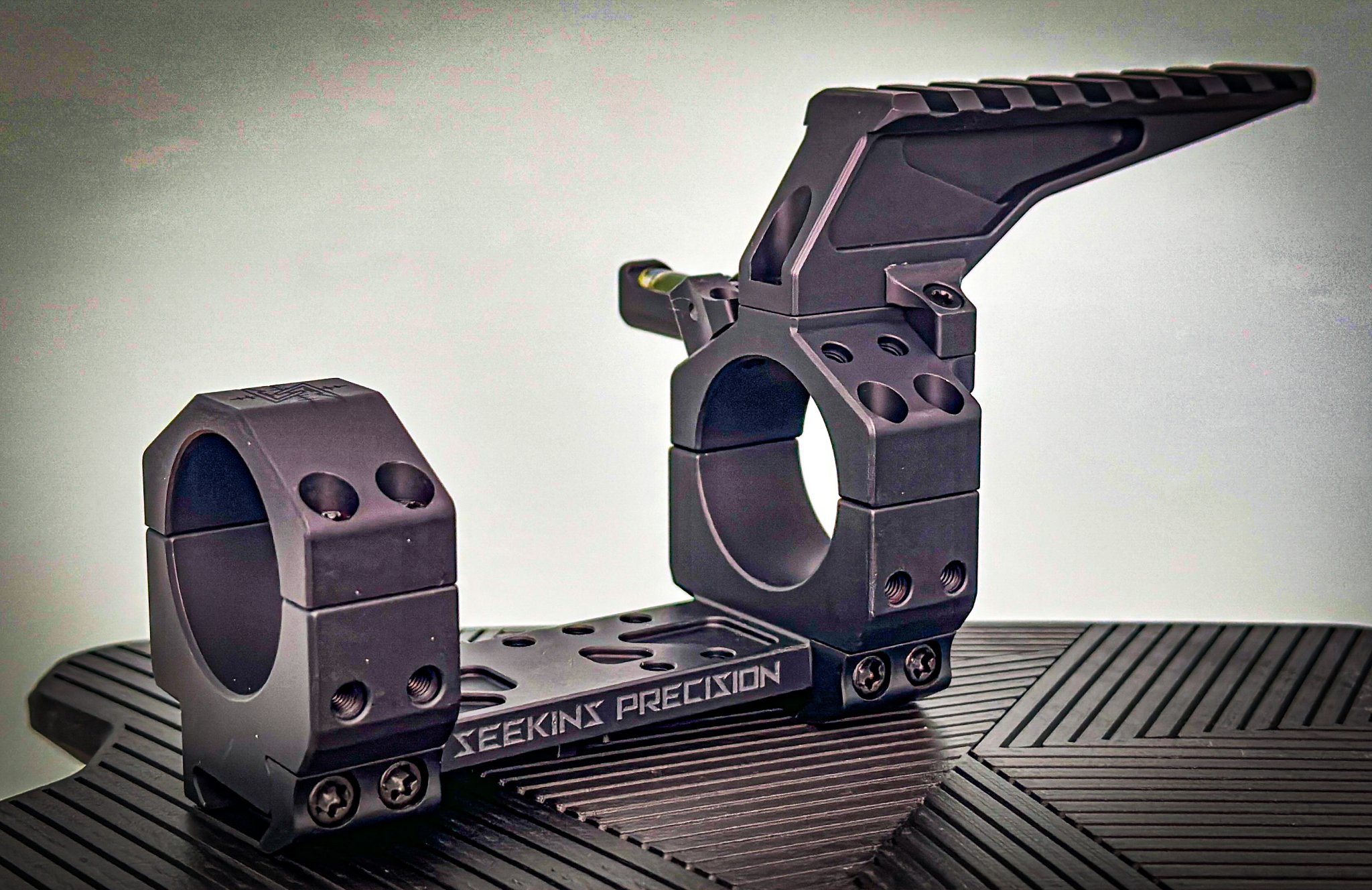

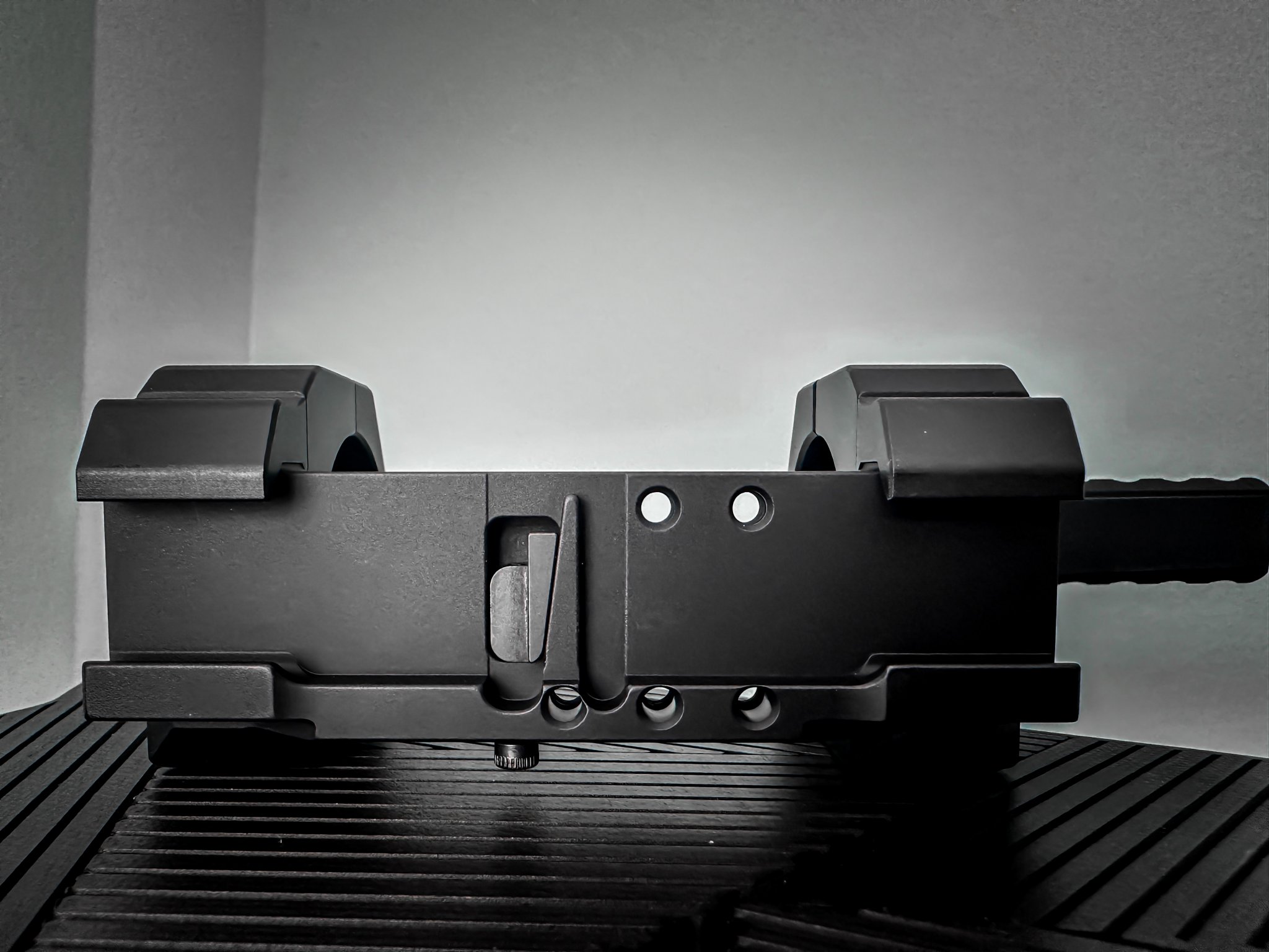

Seekins is dropping their new mounts with a new height. Original he made these in 1.1" as the most popular height, but I just got a message he is doing the 1.54" and those will fit all our new scopes.
The Seekins is next level, backwards compatible with all their rings to add the top cap feature, including with Vortex. Plus his one piece mounts have the "wedge lock" which is new and next level.
To me, the best bang for the buck is Seekins when you look at everything he does.
This mount will change the game in a lot of ways

That checks a lot of my boxes. Will they be $500? Ya know, so we know they’re as good as spuhr?

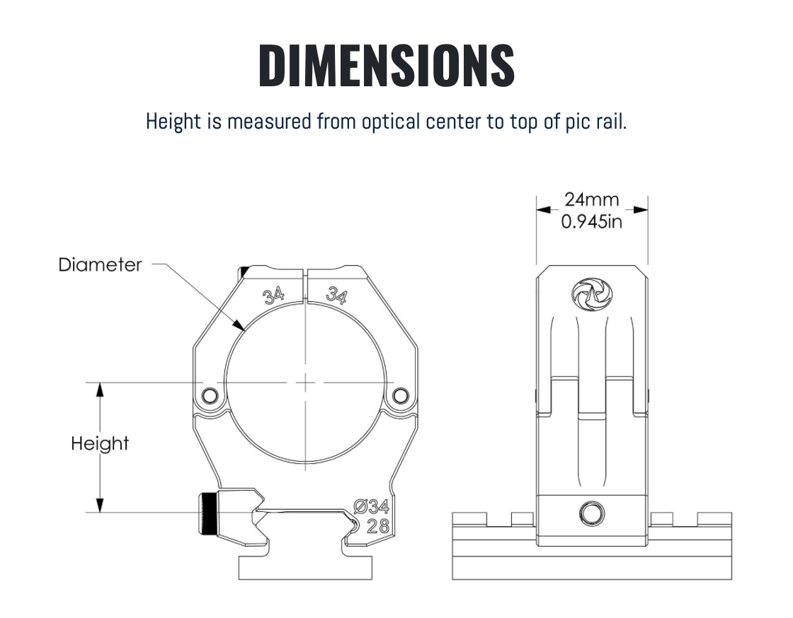

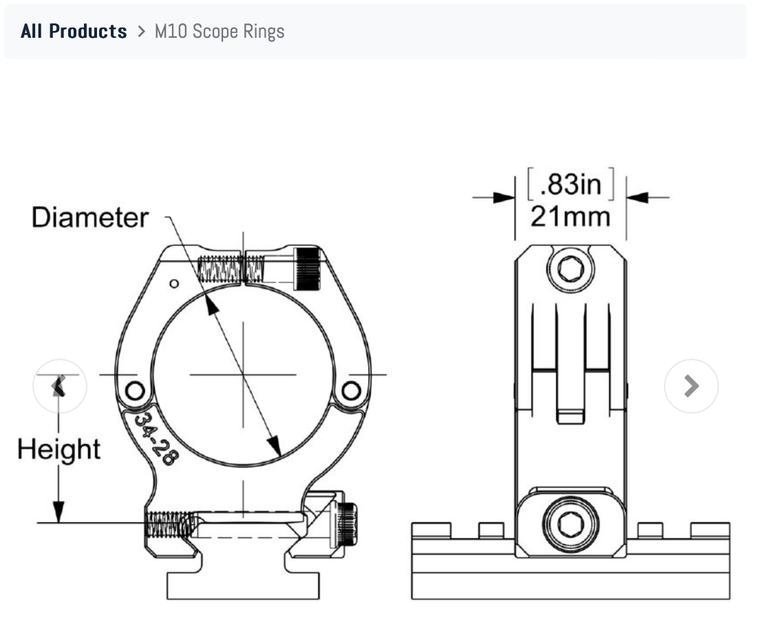

Yeah, I haven't either, but I also take a lot of what folks on the interwebz say with a grain of salt. I go by my personal experience because I'm not afraid to put my money where my mouth is, and buy something to try so I have experience with it. And I've never had a single issue with any of my sets of ARC M-Brace rings...They've all been absolutely rock-solid.
That said, I heard several years ago, that the older version of them, called the "M10" rings, did have some sort of issue, and they revamped and beefed them up, and called them the M-Brace. The M10 rings were only 0.830" wide (front to back), and the M-Brace rings are 0.945" (nearly a full 1" front to back), and they have been beefed up in several spots. I'd almost bet money the people who had problems were running the older M10 rings...
Notice that even the interlocking hinge knuckles are thicker on the M-Brace rings. And they also improved the base clamp design on the M-Brace rings.
M10...
M-Brace...

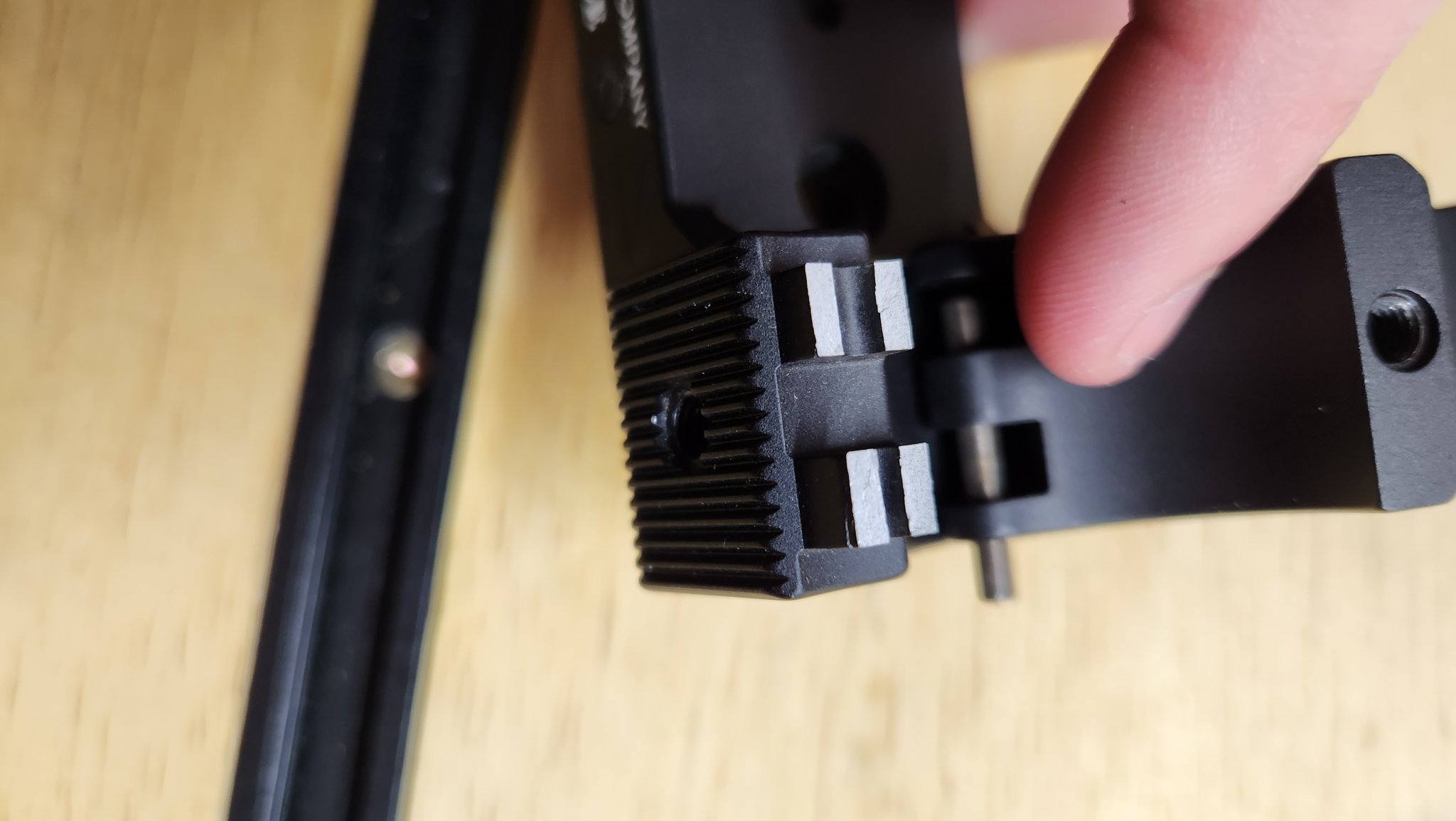

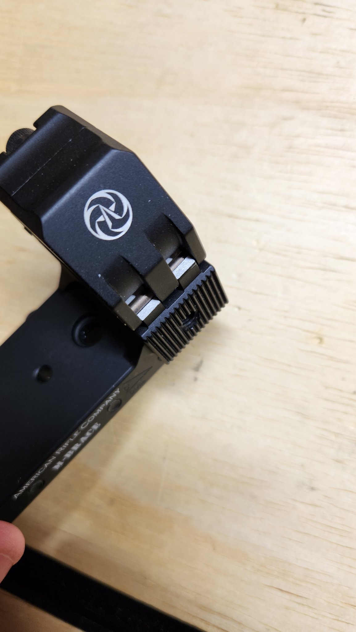

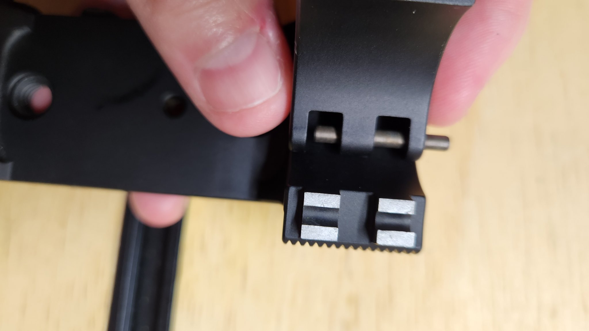

Had one for a season of PRS. Rifle wasn't a safe queen by any means but the rifle never saw any crazy stress like dropping it or dumb shit like that. Always traveled in a soft case packed decently in the car.
I went to a night match in December and Temp dropped to zero or a little below. Next day I went to clean the rifle and noticed the mount looked weird. Saw the ring had cracked.
ARC customer support took care of me. Had a new mount within the week. I was wary about running them after this incident but a week later a buddy of mine had the exact same experience. Sold it, went to Hawkins and never looked back.
To the mount's credit, I never noticed a zero shift with a 6GT. Granted I have no idea when it actually let loose.
Really a shame. Super easy to mount, great price, and generally no complaints other than I could no longer trust the design after seeing 2 of them crap out at the same time in the same manner. My wild ass guess is it couldn't handle the cold.

When did you buy it? I wonder if there was a run of them with bad jojo.

That's a bummer.
