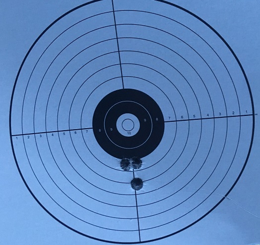

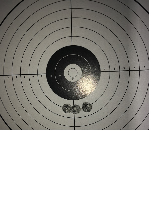

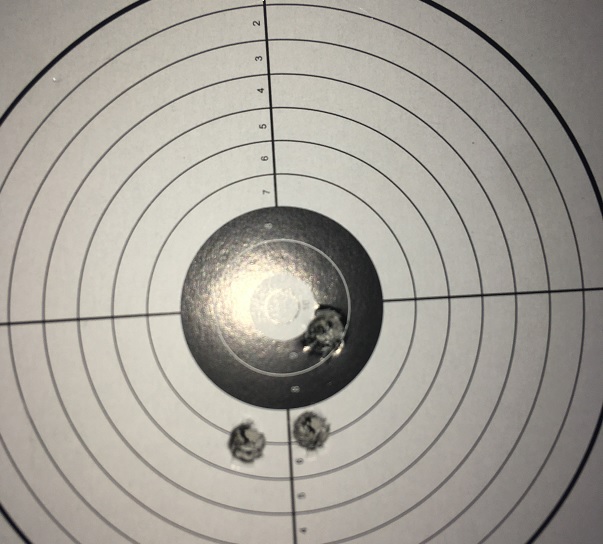

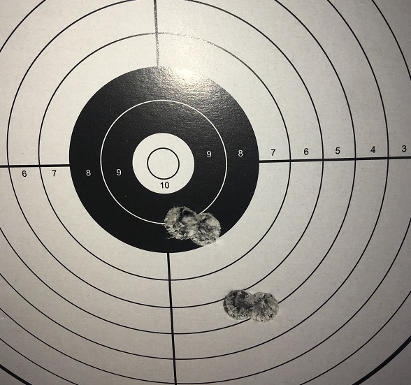

I was shooting today at 50m (the 100m rang was unavailable). The rifle is sighted in at 100m, I did not play with the turrets, just trying to get the tightes group possible. The target is measured in cm- the 10 ring (the white one) is exactly 0,5 cm (0,2 in) wide.
I was shooting 77gr Hornady Black using Leapers bipod.

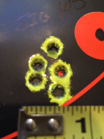

How are you measuring your groups? That target is only 5cm across that is just under 2 inches. So if your groups are all on that target at 100m your under 2 moa at 100 yards. Still not great Hornady black is not a match ammo by any means. Still in my experience its much better than most cheap stuff like WWB and AE. It is probably a 2MOA ammo in a good rifle. What your showing there looks pretty good with that ammo. Is it 62gr ammo? I have found lots of rifles like 60-62gr better than 55s.
