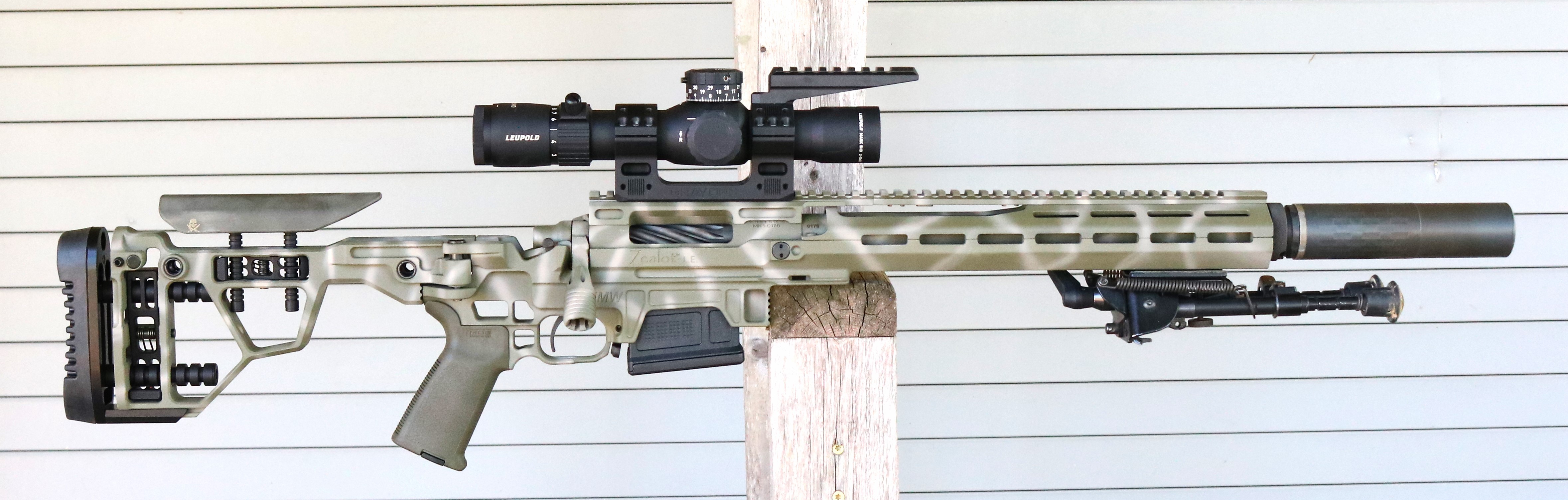

I have one in SFP and have shipped quite a few rifles with the std FFP model in Mils.
It is one of the best scopes I have seen for what we do. What we don't do with them is run n gun type stuff so I can't offer first hand experience with that.
I can say that the FOV is excellent but we have never tried to use these from 10-400 without readjusting the parallax. In fact the adjustable parallax was one of the original draws for use because it is so important for us at the closer ranges. The eyebox, image brightness and resolution for a given X is one of the best we've seen. Capped wind, locking Elev, Nice Illum with timeout and the small footprint are the schnitz.
I can also say that the glass quality and design allows us to resolve things better at 10x than some of the other scopes can do at 14x or more. I may be wrong but I would guess that a scope with lower magnification would offer more of a "deep field" focus than the higher X scopes with all other things being equal.

You got a make that NSFW bro. That is one absolutely sexy rifle!
