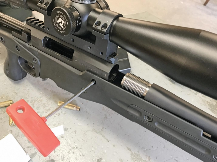

In my AXMC, not only is the POI consistent between barrel swaps, it also stays within 1/3 MOA between three different 338LM barrels (at 100 yards). I suspect it would be even closer if they were the same length barrels.
It is indeed very impressive.
Haven't had the Kraken but had a couple other Cadex rifles. They are great rifles, but IMO not AI's and barrel sourcing is definitely a concern.

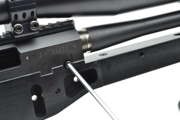

As to the AI POI shift, yes it is 100% repeatable if you follow a certain process. If you just slap the barrel in and torque the nut to spec it will take a few rounds to settle in each time. For repeatable POI:
1. Install barrel with hand guard removed so no dust or debris inside the hand guard and get pushed down between the mating surfaces.
2. Wipe action face and barrel shoulder off before installing the barrel.
3. Install with butt down, muzzle straight up and snug with a wrench, just a few ftlbs to seat the barrel, not cranking on it.
4. Torque the bolt to 70inlbs. I also found this makes the gun shoot better too being tighter, but POI is also consistent. IMO 49 inlbs is not enough for best results.
Do that and you can cut a group as tight removing and installing the barrel each shot as you can leaving it on.

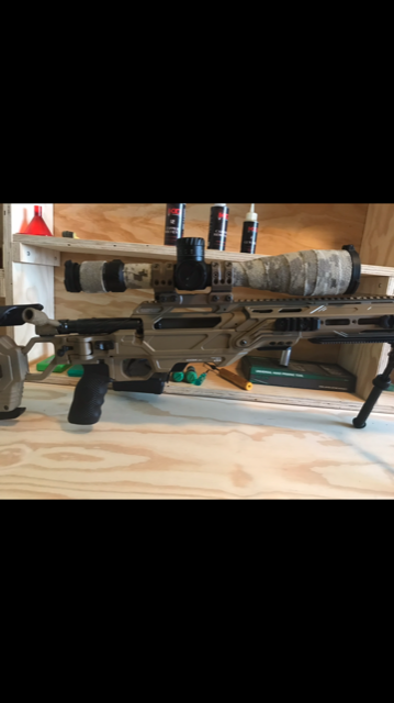

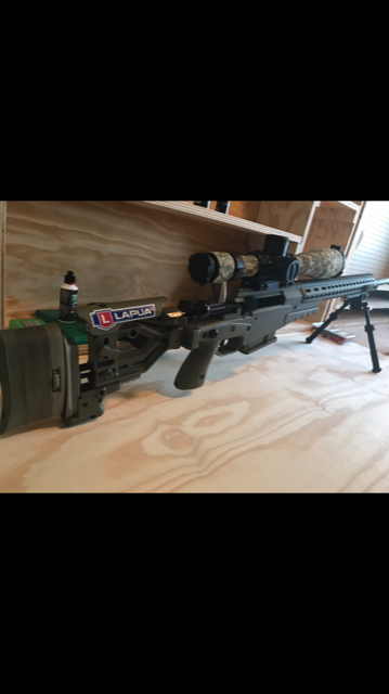

Own both, mostly what everyone has said is true, the barrel availability is way better for the Ai.
the barrel change is quicker on the Ai but the poi shift and repeatability on the Kraken is better, the Kraken is probably the best repeatable switch barrel system out there.
I would trust the Ai trigger more out in the field, and the Cadex trigger doesn’t really have a true 2 stage trigger like advertised, the first stage is is very short and non adjustable and very very light to where it doesn’t really function like a true 2 stage. But the trigger is very crisp and in single stage it is just as good as my trigger tech, and the cadex trigger is really reliable and more so than most, just not quite Ai reliable.
the bolt and feeding on the Ai is better, the kraken bolt won’t slide back and forth as smoothly because if you aren’t running it back and forth really straight it will feel like it gets stuck if you put pressure to either side as you are running it back and forth. The Ai you can press into it towards either side while running it and it will still slide smoothly. But that being said the kraken bolt is very well built and bomb proof and it does run very very good and smooth if you you are a half decent shooter and know how to run the bolt straight. Bolt lift and close is pretty close between the two
the Ai is sexy and has that mythical look to it and I do like it equally in looks, but..... the cadex system is in my opinion the best machined system/chassis out there, and they are probably the best CNC machinists in the business, every cut and angle and joint is perfect.
Both are incredible systems and the kraken is a very reliable rugged system, as we all know Ai is. You won’t be disappointed with either one and maybe seeing as you have owned an Ai take a little harder look at the cadex or try getting a hands on with one before deciding.

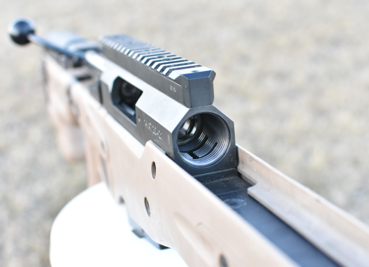

The Kraken action by itself, is actually a nice spec’d action.
It has v-bed slots cut into it to mate with the v-bed kraken chassis. Which I’m a huge fan of this.
1.1875” tenon. I like bigger tenon.
0.350” integral recoil lug
Up to 3.850” magazine
So, it’s not like the kraken can’t compete. It’s just that Cadex is treating it like a secret and that’s BS.
Any good gunsmith out there can take a Cadex Kraken and make a standard action wrench to match the actions lug pattern. They can remove the barrel. Measure it and duplicate that and make their own barrel. That’s easy. But why should they have to do that when companies like AI allow their AXSR/AXMC print to be available to gunsmiths.
