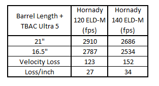

Below, you'll see some Magnetospeed MV info for Hornady factory ammo and a Kreiger Light Palma barrel that was 21" and chopped down to 16.5". For reference, the TBAC Ultra 5 adds ~25FPS if I remember correctly. Don't shoot much without it.

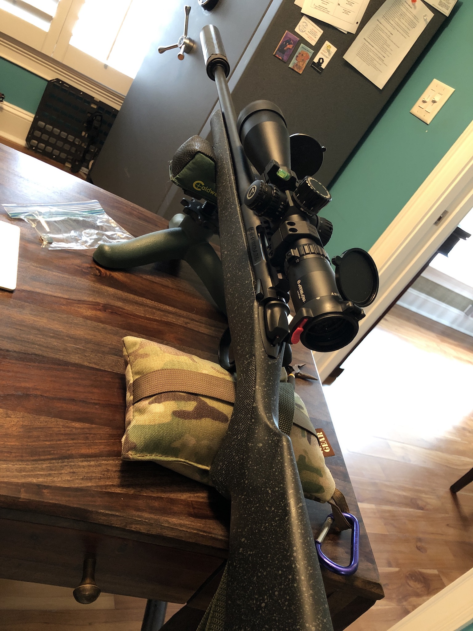

Before I had my AX I cut a Ruger RPR in 6.5cm to 17” and it was the handiest little thing. Now my AX has a 18” 308 barrel and 24” 6.5cm barrel and while I like shooting the 6.5cm better I love how small and handy it is with the shorty 308 barrel. This thread my put me over the edge for a chopity chop on the 6.5 barrel
