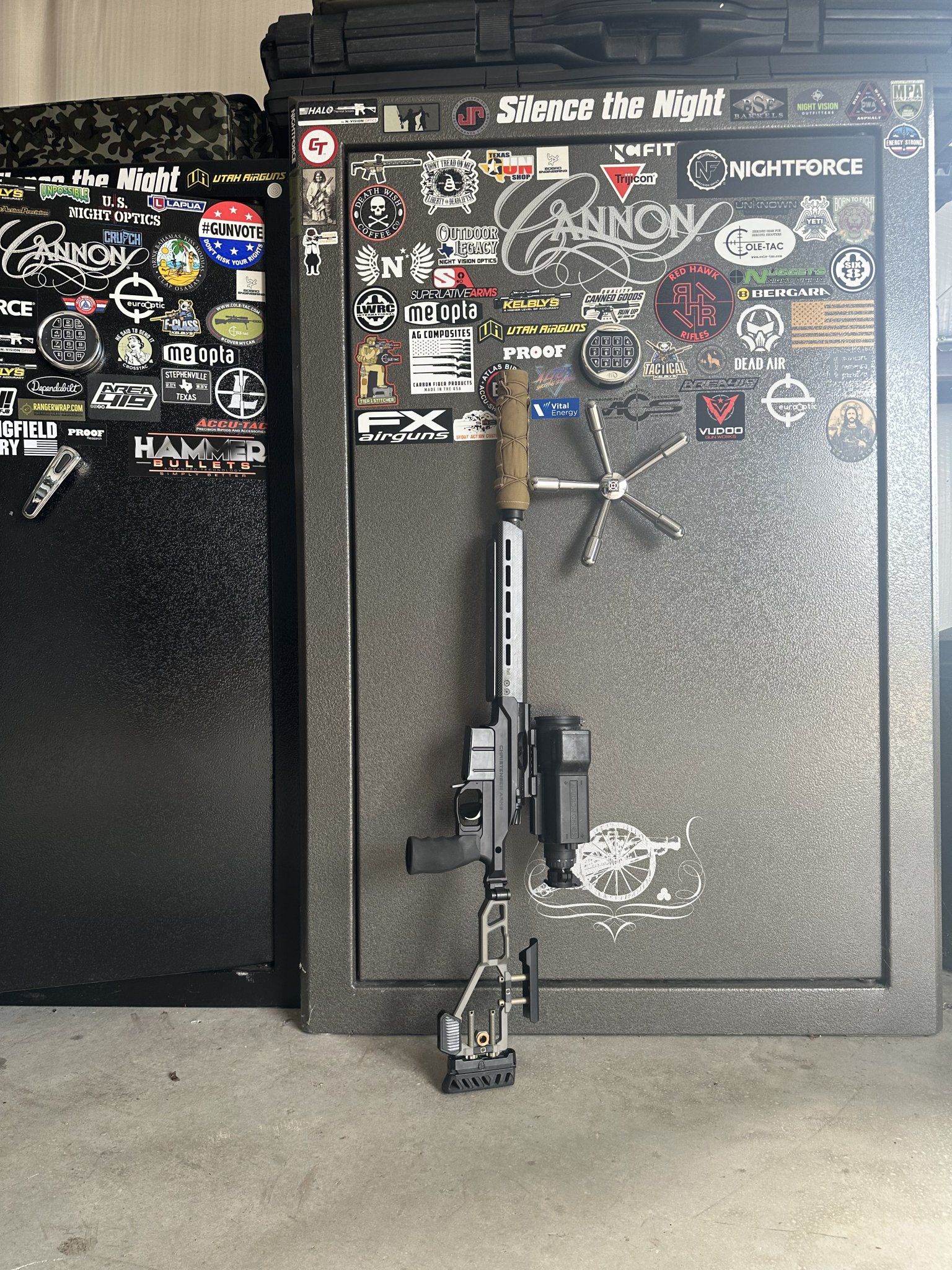

I happen to be looking to do exactly that...a "covert"
My TL3 has 4 barrels already, all for various uses...but I just grabbed a JTAC chassis and am looking at an SBR caliber to do a covert build. Probably 9-10 inches. Standard .308 bolt face. I'm thinking a 6.5 creed with a light bullet for coyotes and heavys for random plinking. Suppressed of course.
...or even .223 bolt face in 9-10". Again, suppressed of course.

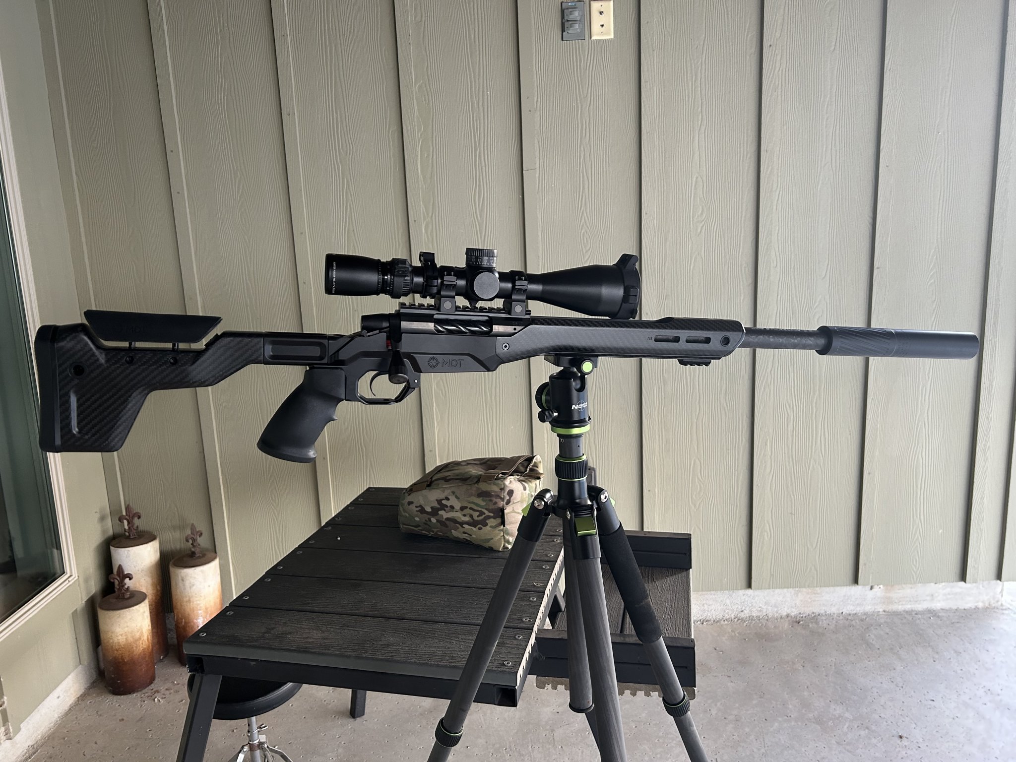

I have a MPA 6.5 with the Spencer barrel. It's always been pretty quick. Cut it to 16', Suppressed Omega. I get 2741 fps with factory
Hornady 140s. I can't even count the number of pigs in Texas that have been exterminated by it.
I don't regret it at all. Everyone that has handled it , shot it. Thinks it's the tits.....

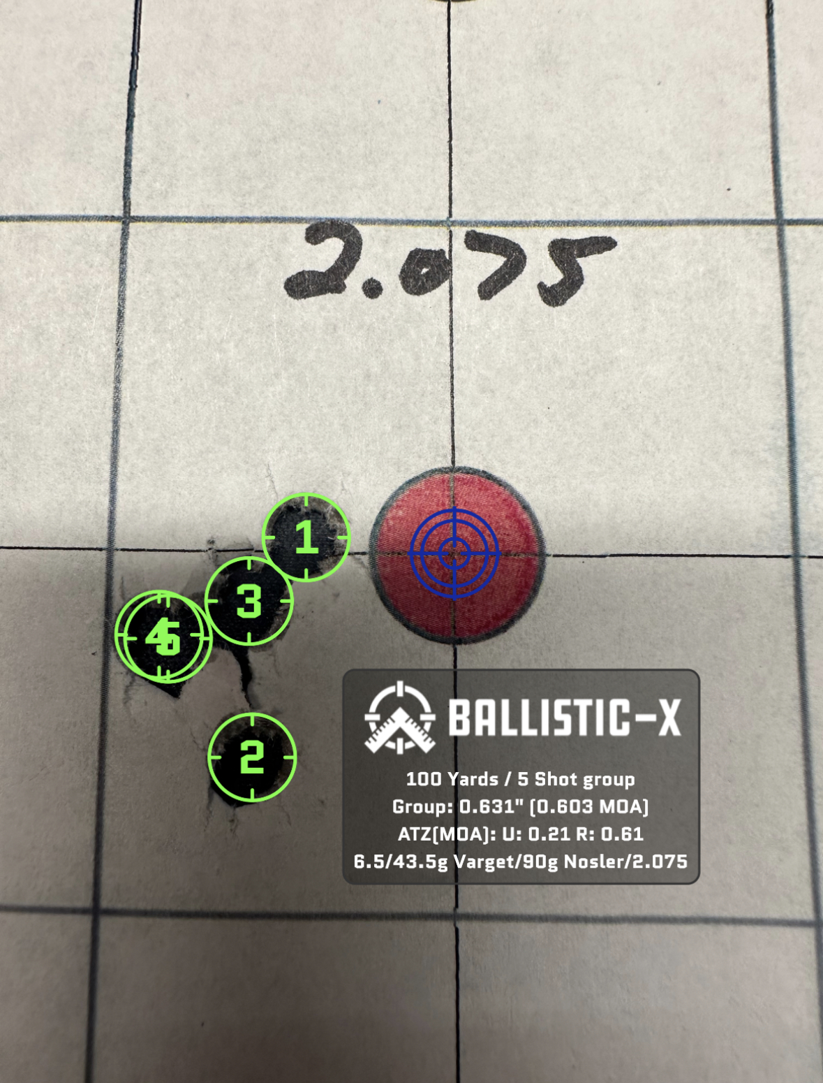

I own a 18" 6.5 Creedmoor in Medium Palma, and love it...2550ish with Berger 135 Classic Hunter and 140gr ELD-M factory ammo.
How does it shoot at that speed? I have been trying to do load development on my 18 " 6.5 creedmoor. Been trying to get it to 2700ish but is not consistent. What is ur charge? Looking for more consistency.
Better than I can shoot, most times. I was shooting factory ammo with both the 135 CH and 140 ELD-M.
2700 with any 140-class bullet from a 18" 6.5 Creedmoor would be pretty warm IMO, but one could get there with 130s.
