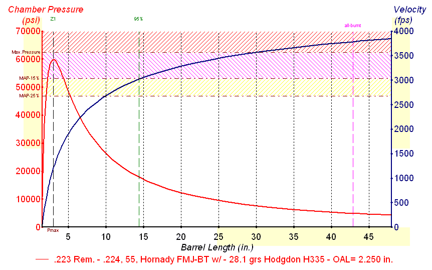

I'm currently using H4350 in a 24 inch 6.5CM. I'm getting a new barrel next week, and am wondering if I should be looking at a slightly slower powder to get the most out of the longer barrel. It doesn't seem like a lot of difference, but it's new to me, and I know there is a great deal of experience on here.
No, burn rate choice is more a funciton of bullet weight and rate of volume change behind the bullet (chamber volume + bore volume growing over time).
Most of the speed is gained in the first few inches, a few inches of longer barrel wont suddenly make a less optimal powder selection more optimal than a better powder selection in the first place. Choose the best powder no matter the barrel length.
3,800 fps at the end of a looooooong ass 48" barrel.
In the first 10" the bullet is going 2,700 which is 70% of its total speed if one were to run a 48" barrel.
At 25" ----which is 15 additional inches (aka a barrel 2.5x as long, aka a 150% increase in barrel length)---- and the bullet is going 3,500 or 92% of the total possible speed... but thats only an additional 30% in the velocity gained with a barrel 150% longer.
