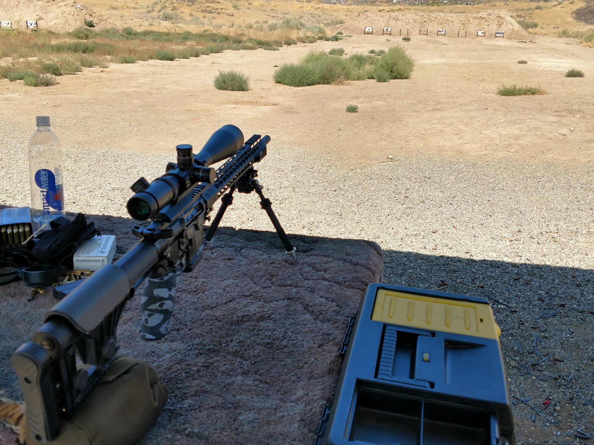

This is a Compass Lake 18" Krieger intermediate gas, fluted wylde chamber. Only thing I did different was run 9/16 threads versus 1/2 inch threads, I prefer to have a bit more meat at the end of my barrel.

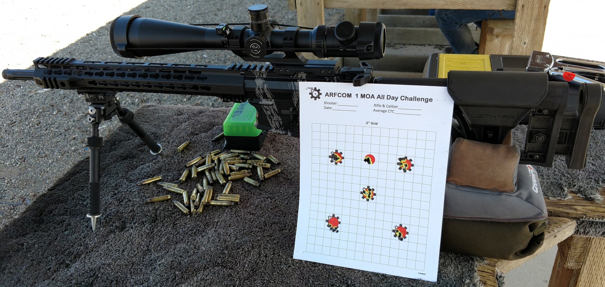

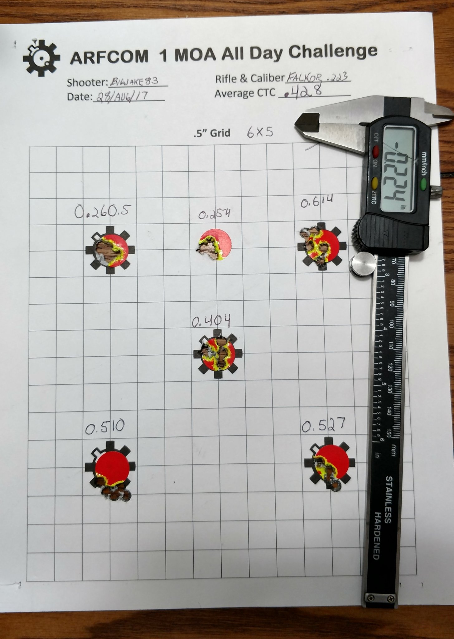

One thing I've noticed with the CLE Match or Wylde chamber is every barrel I get from them will shoot Black hills 77gr at 1/2 inch or less.
WOA and Criterion seem to need handloads and a little luck to achieve that.
