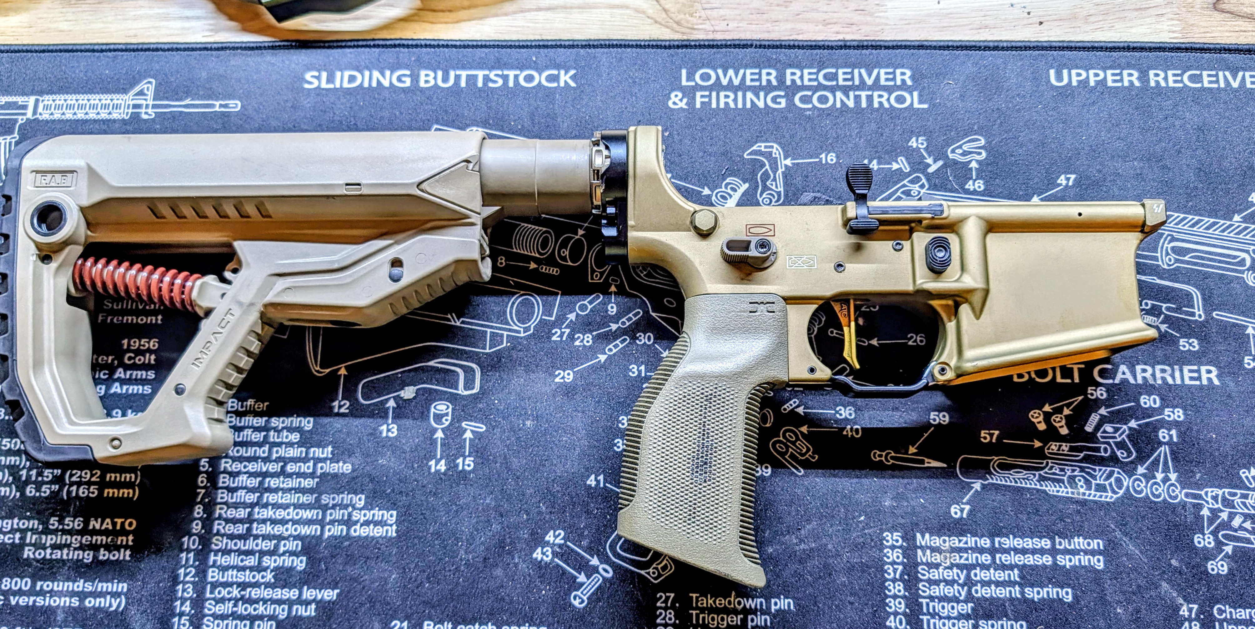

I've been using either my Aero M4E1 lower, or my ADM lower for most of my builds. But I've had a LMT MARS-L Tano hiding in my safe just waiting for the perfect build. It was finally time to bring her out.
Because I wished to avoid further beatings, I resolved to use pieces of rifles I already had or stuff I had squirreled away in my safe to complete this rifle.
Because the LMT Tano Lower is a very hard color to match - I decided I would have to make this a 50 shades of FDE build.
Noteable parts:
Driven Arms Co Grip
ATC Gold Flat trigger
Hera Arms Safety kit (different styles on either side)
Forward Controls winter style trigger guard
FAB Defense Impact stock
Strike industries take down pins
Geissele Super 42 Braided wire and H2 Buffer

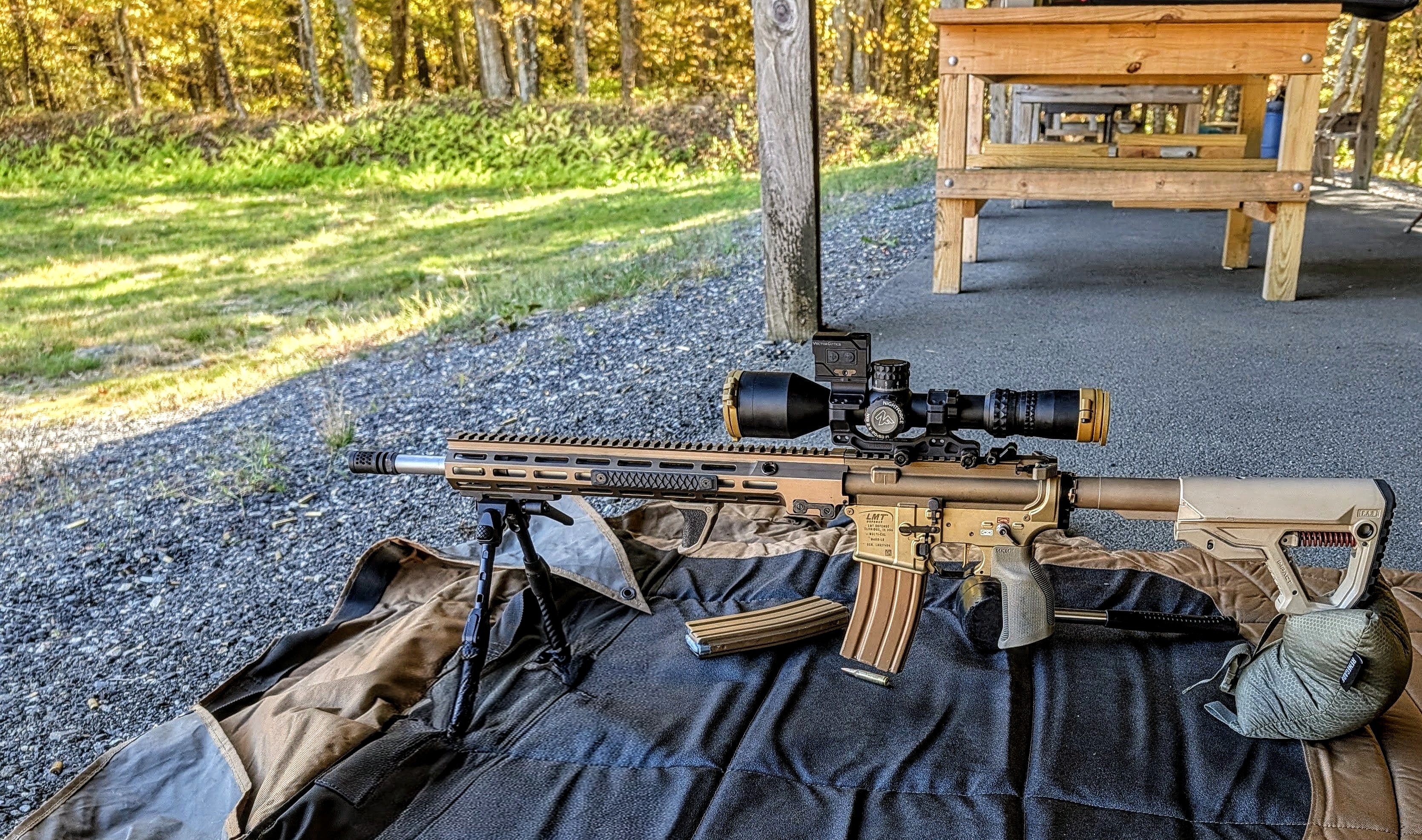

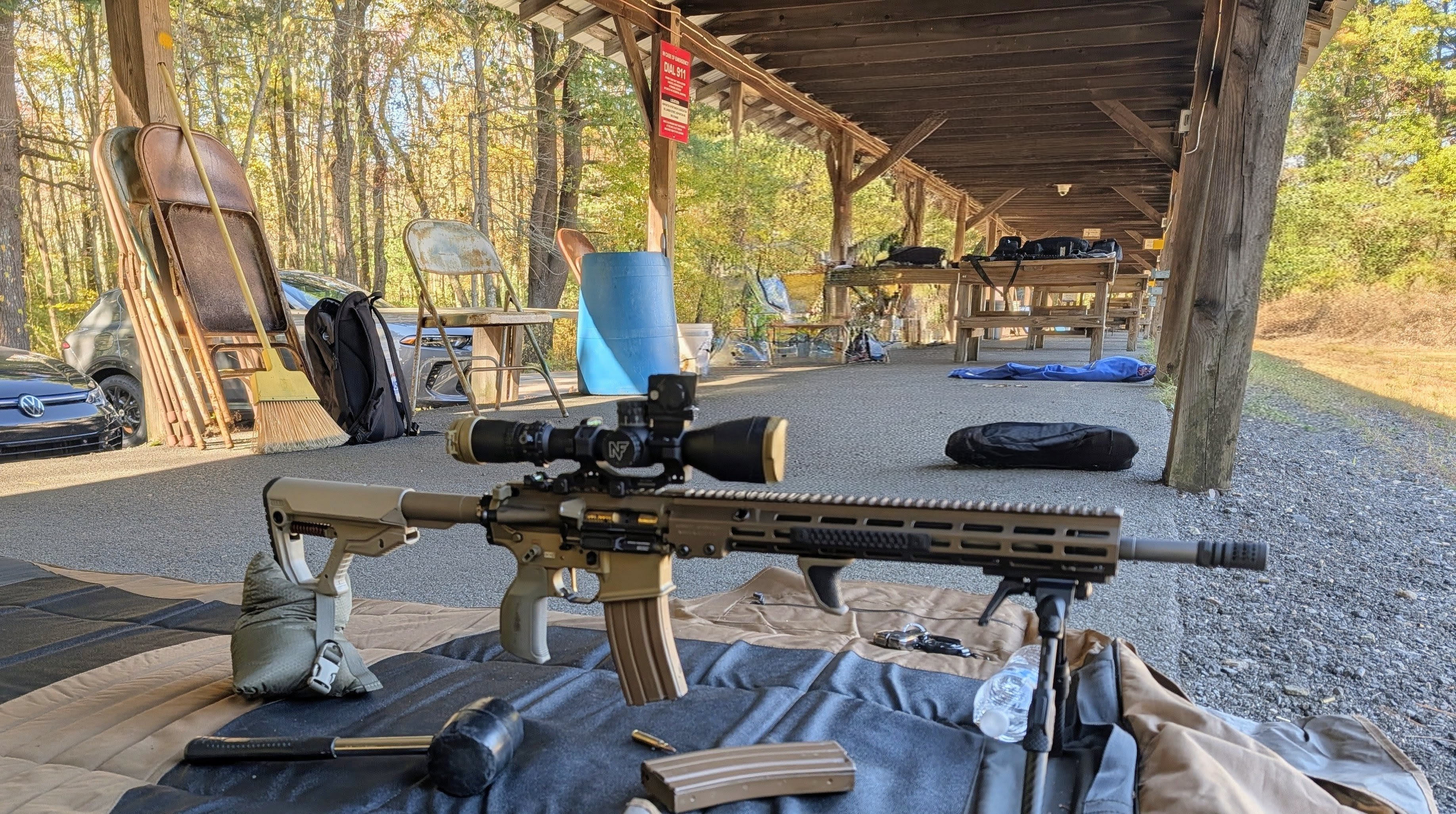

Right away I knew I had to call her Goldilocks. I didn't know how well that name would fit until I took out to break her in.
I went back and forth between a Cronus Gen 2 4.5x29 optic and a NX8 optic - but eventually I decided That the Nx8 2.5-20x with a 12 o'clock ACRO style* mount would be perfect.
Why you ask?
It certainly wasn't because my scope caps were FDE on my nx8. Def not the reason.
*Thats a chineasium ACRO clone called a Vector. Havn't heard of them? Me neither. Not sure where my brother got it. But, he's using my Steiner MPS on a Glock 20 with a B&T USW pistol frame on it right now and won't give it back. He gave me this to hold its place until he can get his hands on an ACRO. I plan to pee on him in his sleep if its not returned soon.

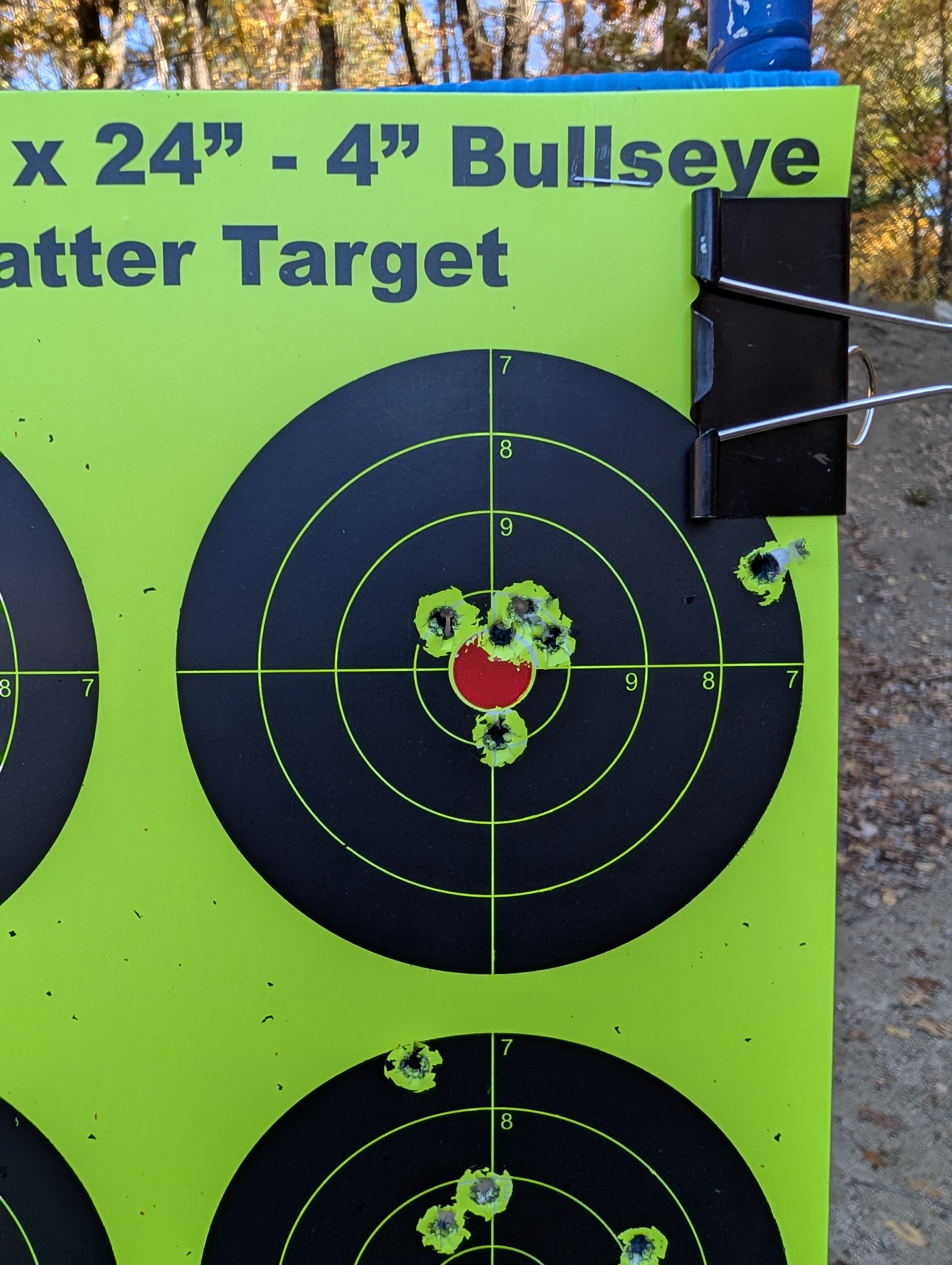

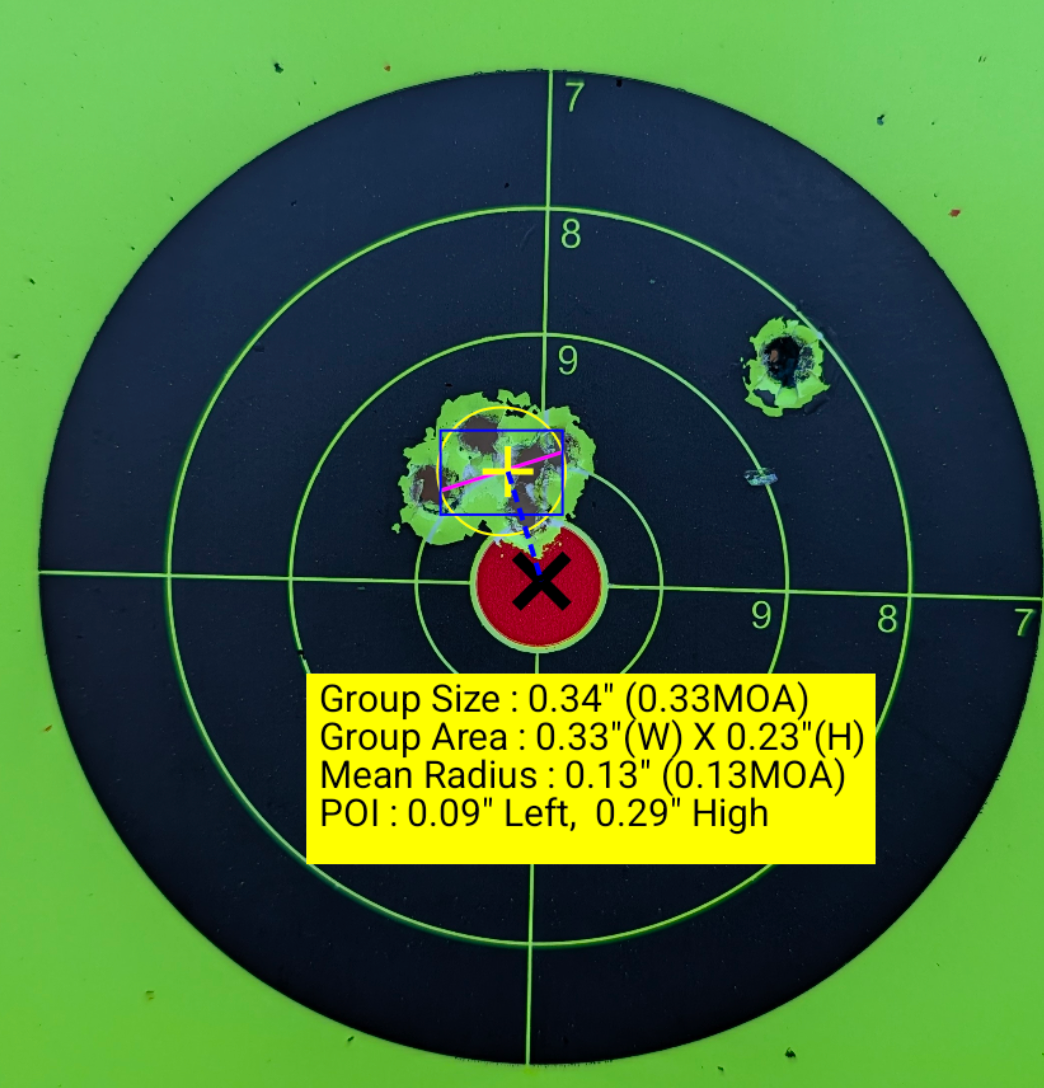

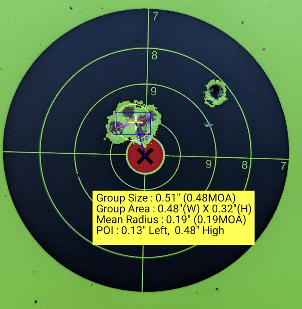

Once I (finally) got her sighted in she did this:
That's a 4'' target, 1/8th'' bull at 100 yards. The rando is actually one of the sighting in shots. That's my story and I'm sticking to it.
.33 MOA for a 5 round group is probably one of my best gas gun groups ever. I was shooting with a few other people who were waiting for me to go to the tactical range and I didn't have a lot of time really shoot her after the zeroing in misadventure - but with 80 rounds down the tube I'm really excited to see what this one can do!

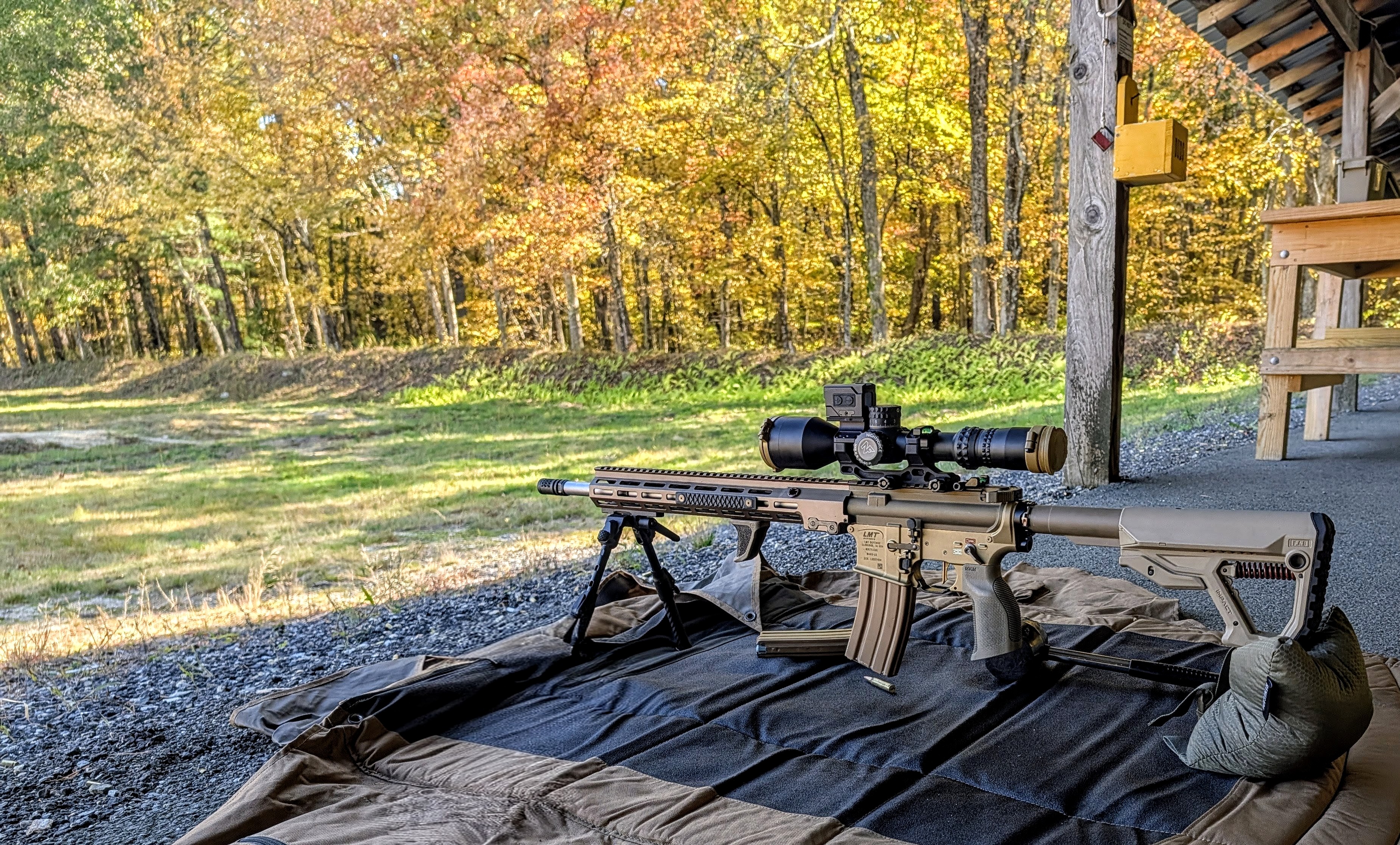

Gratuitous Fall picture!

Everything about the build seems solid, but what is with that weird stock with the red spring in it?
Cant you just use a B5 Sopmod like normal folks?
It actually has a significant recoil damping effect allowing me to stay on target and fire again sooner.
When I run the larger one on the softest setting on my 14.5 noveske build it almost feels like it's lowering my split times with an almost bump stock like effect. It's certainly much easier to stay in the A zone when dumping 5 to 10 round strings.
My double taps are getting getting tighter and tighter as well.
I've built hundreds of rifles with b5 stocks. I wish primary arms wholesale would tell me exactly how many B5 stocks I've bought from them. Everyone loves the sopmod with the bag rider and the cheek pad - but I wanted to try something different with this build!
I have never seen that stock before, if it works it works.
But its not my cup of tea.
As a mk12 fanboy I run A2, Sopmod and Socom stocks on my lowers.
Reactions: MarshallDodge

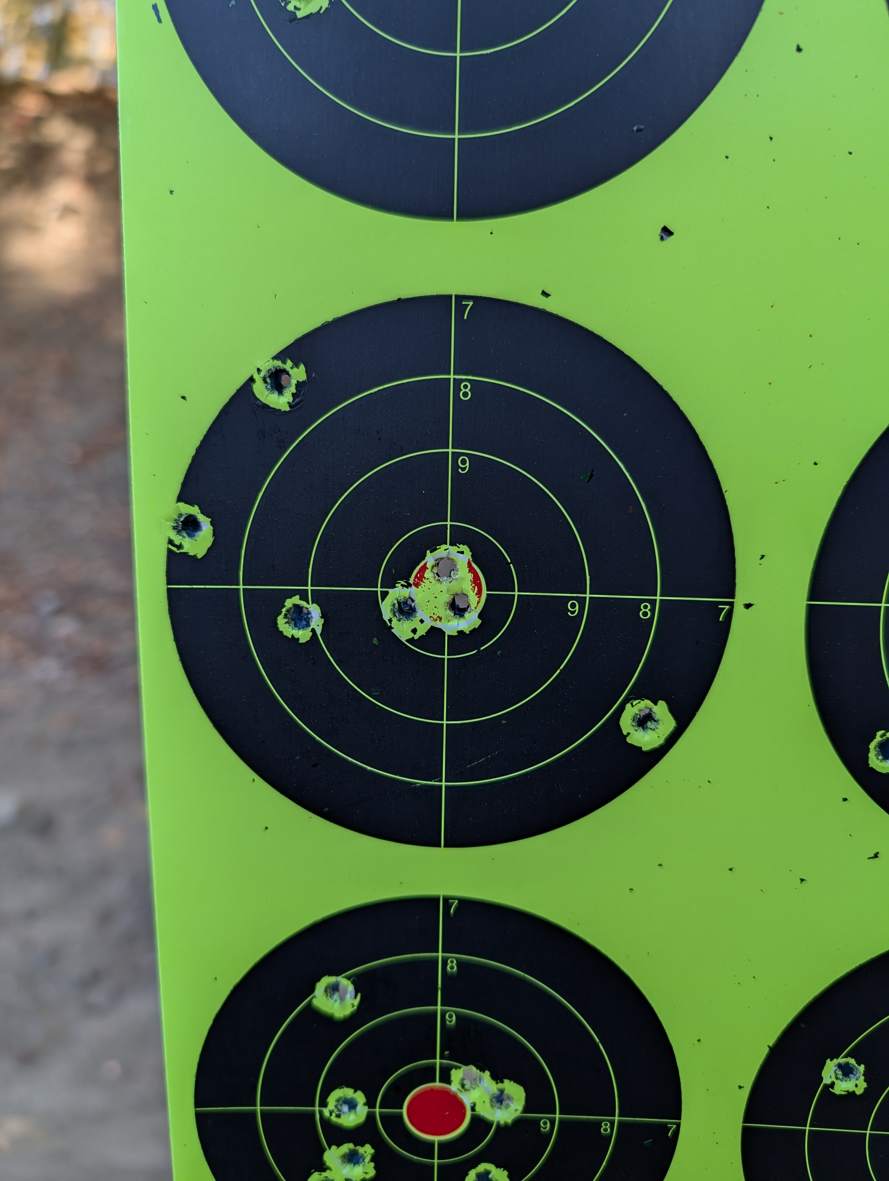

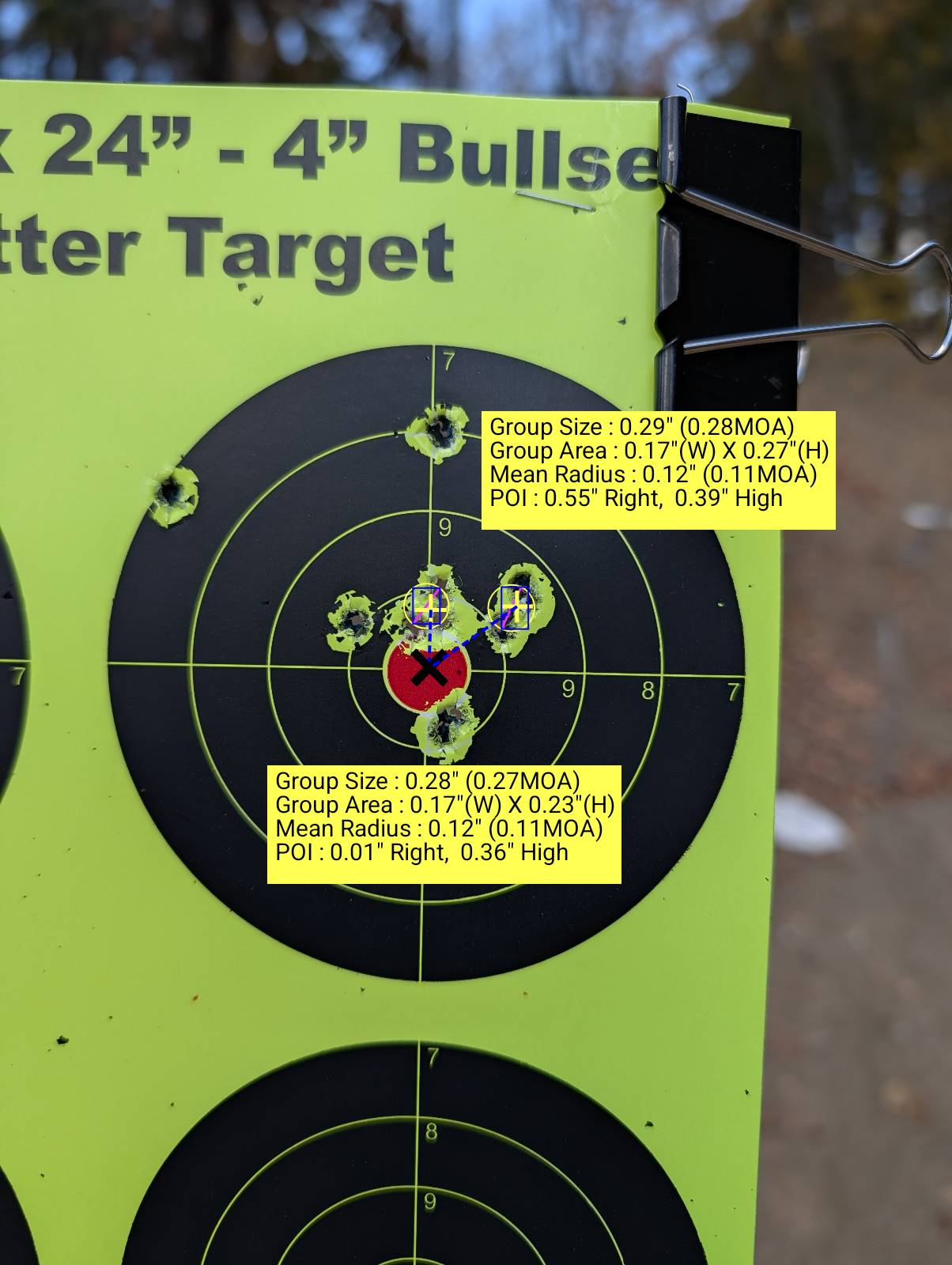

1/8" is .125
Bullet diameter is .224
That bull isn't 1/8" and that group isn't .34". Still a real good group. Nice build.
Cool build.
You may want to get out a caliper and measure your group to confirm. I think your software is off, but still some solid shooting
Id honestly be surprised if a free app called "Range Buddy" was perfect.
If nothing else it allows me to compare groups across my own builds and see what is working and what needs improvement.

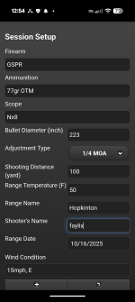

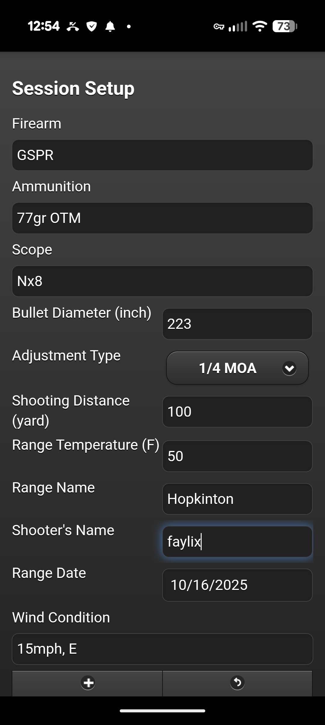

Range buddy is good, you just need to feed it good info. Change the measurement of the bull to 1/2" then use setting to put in the bullet diameter. Then you put circles on the bullet holes instead of guessing the center of impact. It will give you much better/consistent measurements.
Those settings look good.

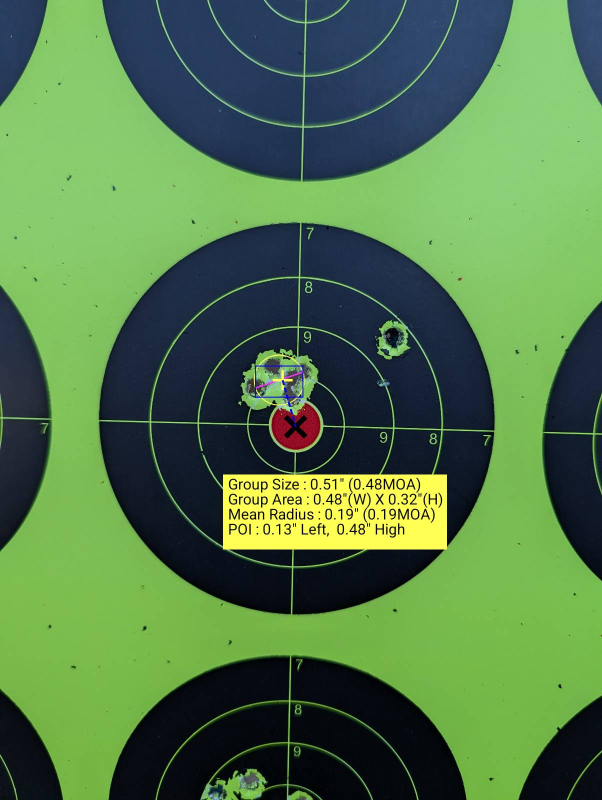

There isnt a setting for bull size, but when you plug in the distance or 4" from top of target to the bottom the group size goes up to .48 something moa.
Which makes sense.
That's annoying, now to make scaling consistent I'm going to have to change a lot of data.

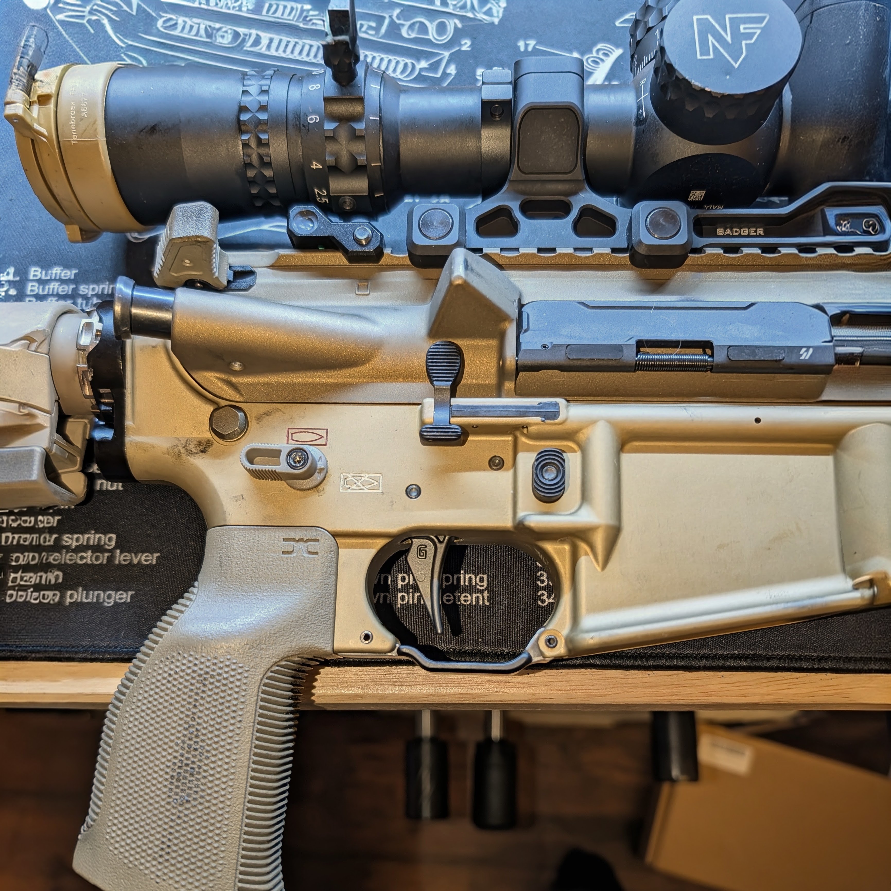

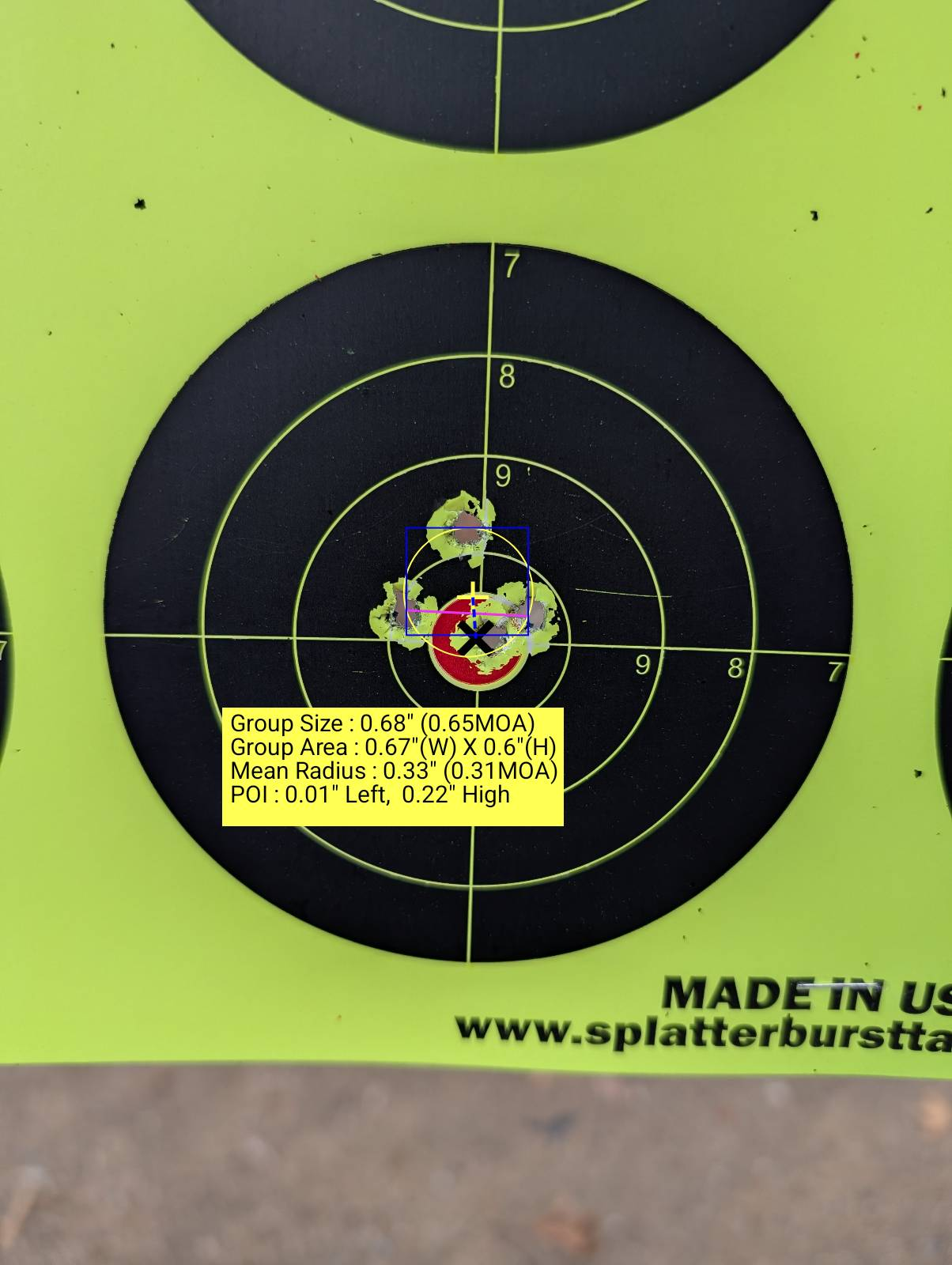

Today was super windy, but for some reason I was either super twitchy or something was up.
Eventually I managed to put a few together but it just wasn't my day. I've been having some trouble with the atc trigger and the safety so when I got home today I swapped in the SSA-EX.
Might as well go full G$ right?
Do you think someone would tanodize the lightingbow for me?
Swapped from the MDT bipod to one of my atlas bipods and swapped the SSA-EX trigger in.
Still not loving the dispersion but every now and then I'm seeing hints of where I want this setup to be. Might have something to do with the fact I'm running a bit of a fever this week.
Also switched from defenders 77gr OTMs to HSL's 77gr OTM rounds today.
Oh well, I'll keep working it. Probably crossing 200 rounds on the barrel at this point so we are nearing break in.
* All moa calculations have been fed proper data this time. Plugging in the 4" distance from top to bottom of target and using .223 as bullet size.
