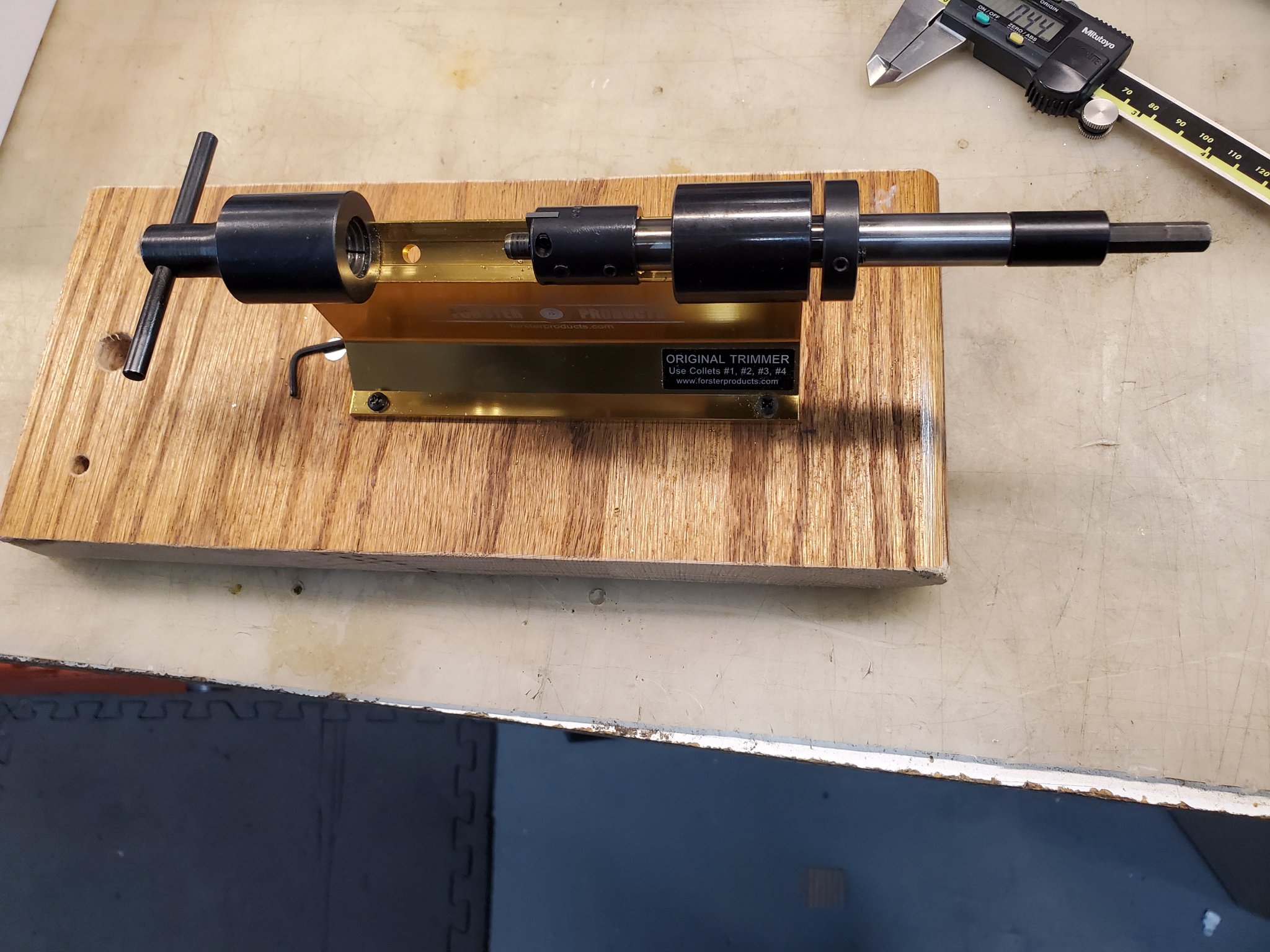

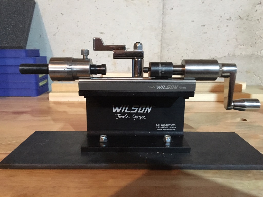

Have owned Giraud, Henderson, Wilson and waiting for the trimmer head for the 21st century.
Sold Giraud for Henderson as it’s easier on the hands than a giraud. Likely going to sell the Henderson soon since I won’t be selling the 21st century and don’t need them both.
For speed and comfort, I don’t think you can heat the Henderson. Unless rigging an amp mate to work with Giraud.

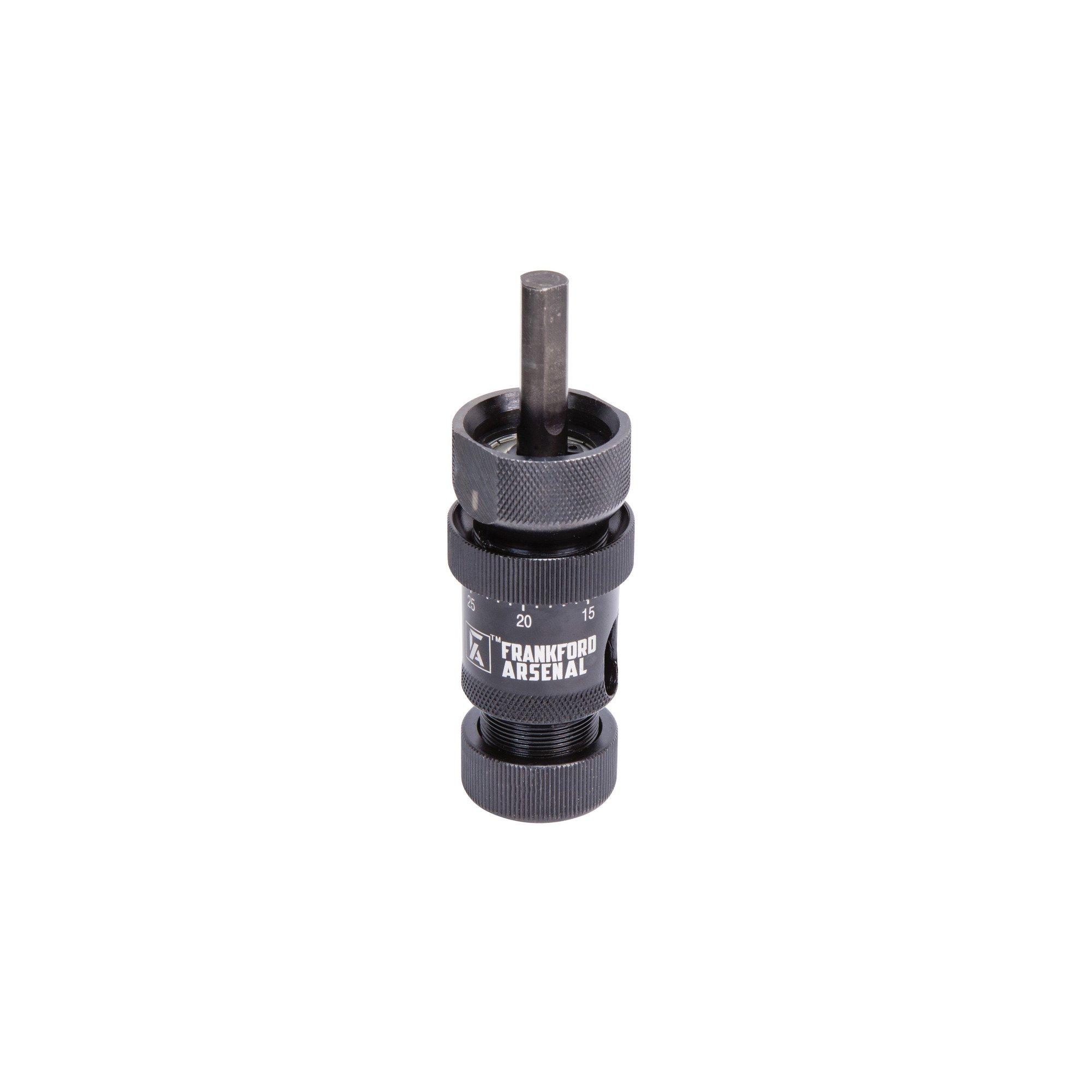

I found one of these for less than $40 and as long as your precise on your set up it works really well.
Case Trimmer for Ammo Reloading | Frankford Arsenal
Frankford Arsenal's Universal Precision Case Trimmer for reloading works with any 1/2 inch drill or drill press and includes a durable storage casewww.frankfordarsenal.com
