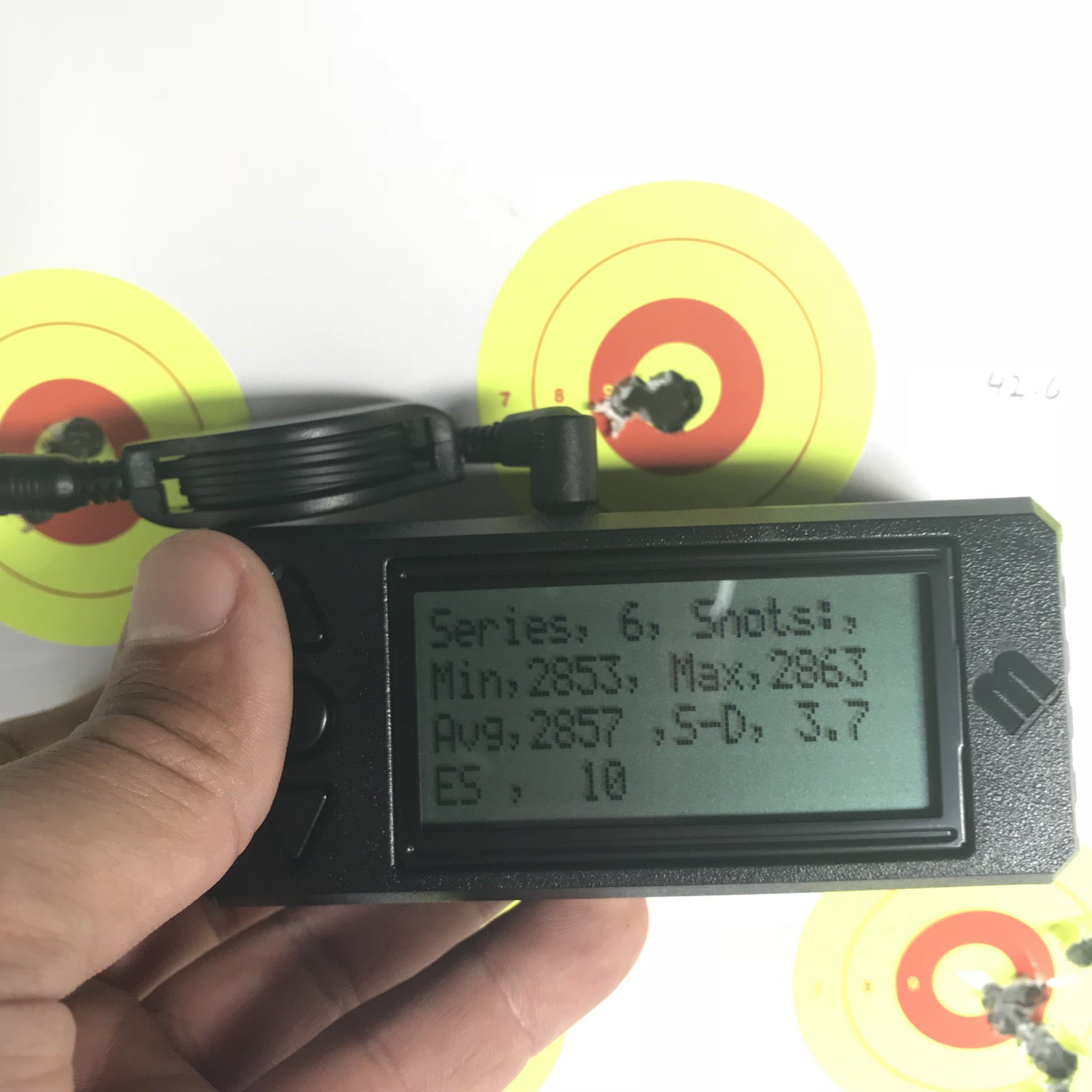

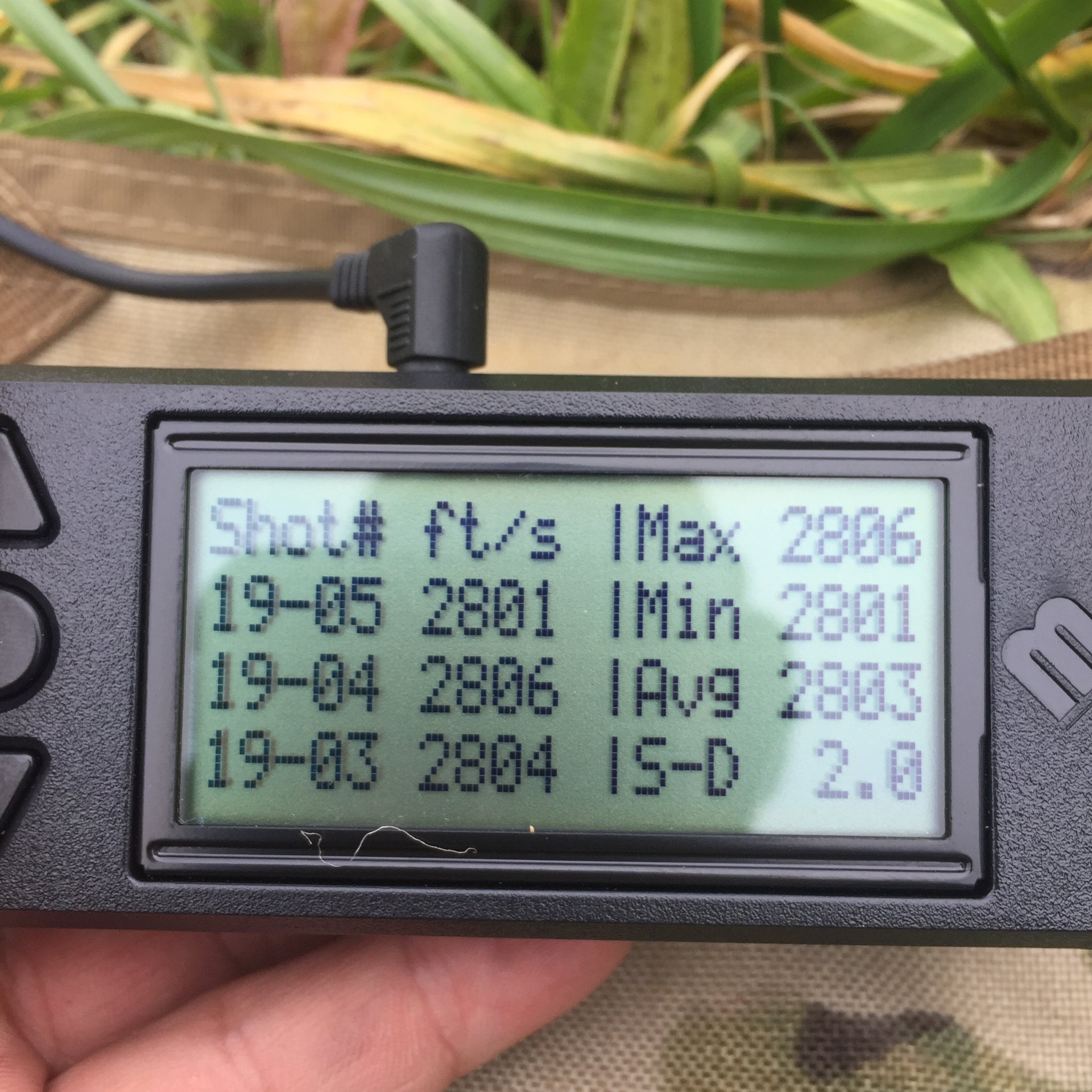

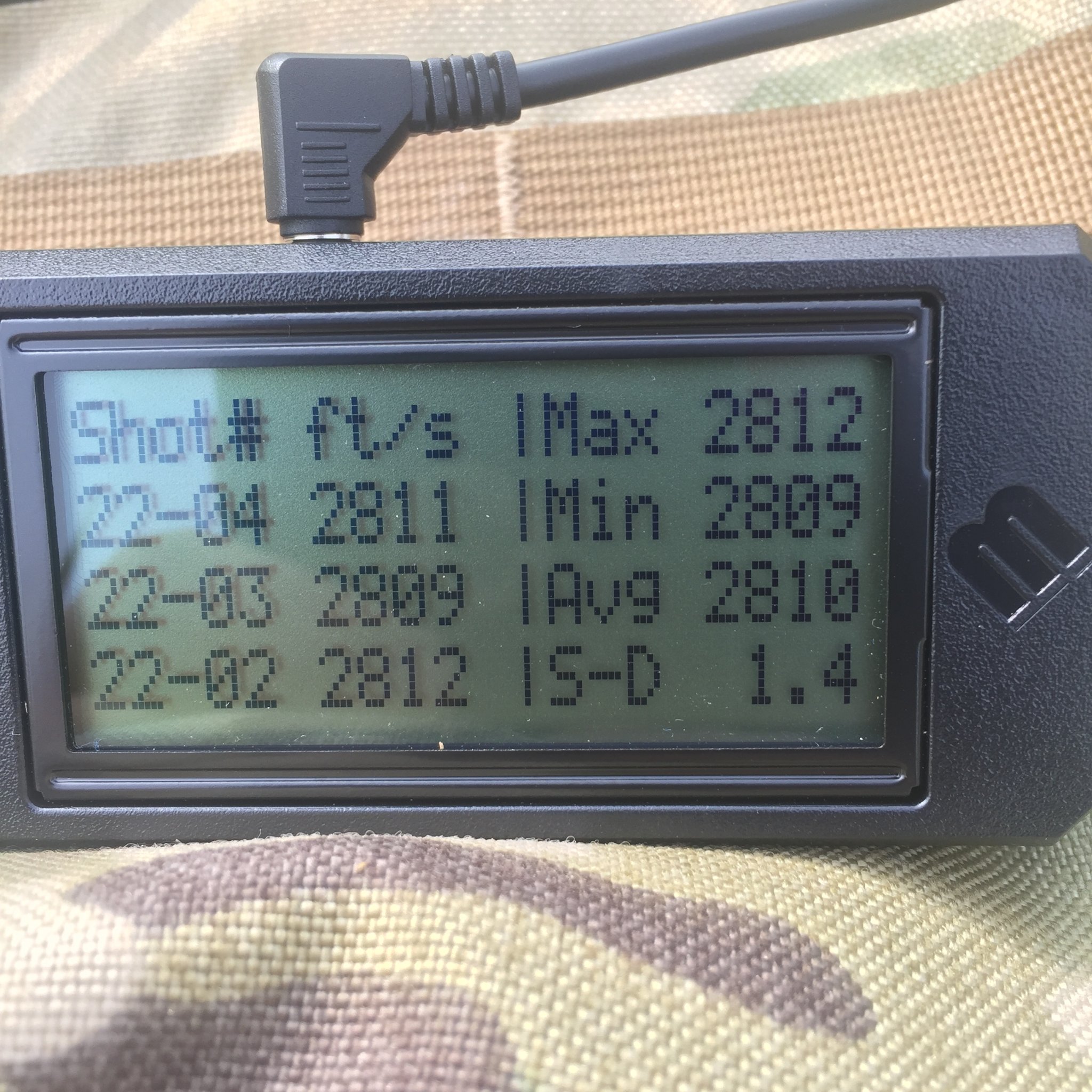

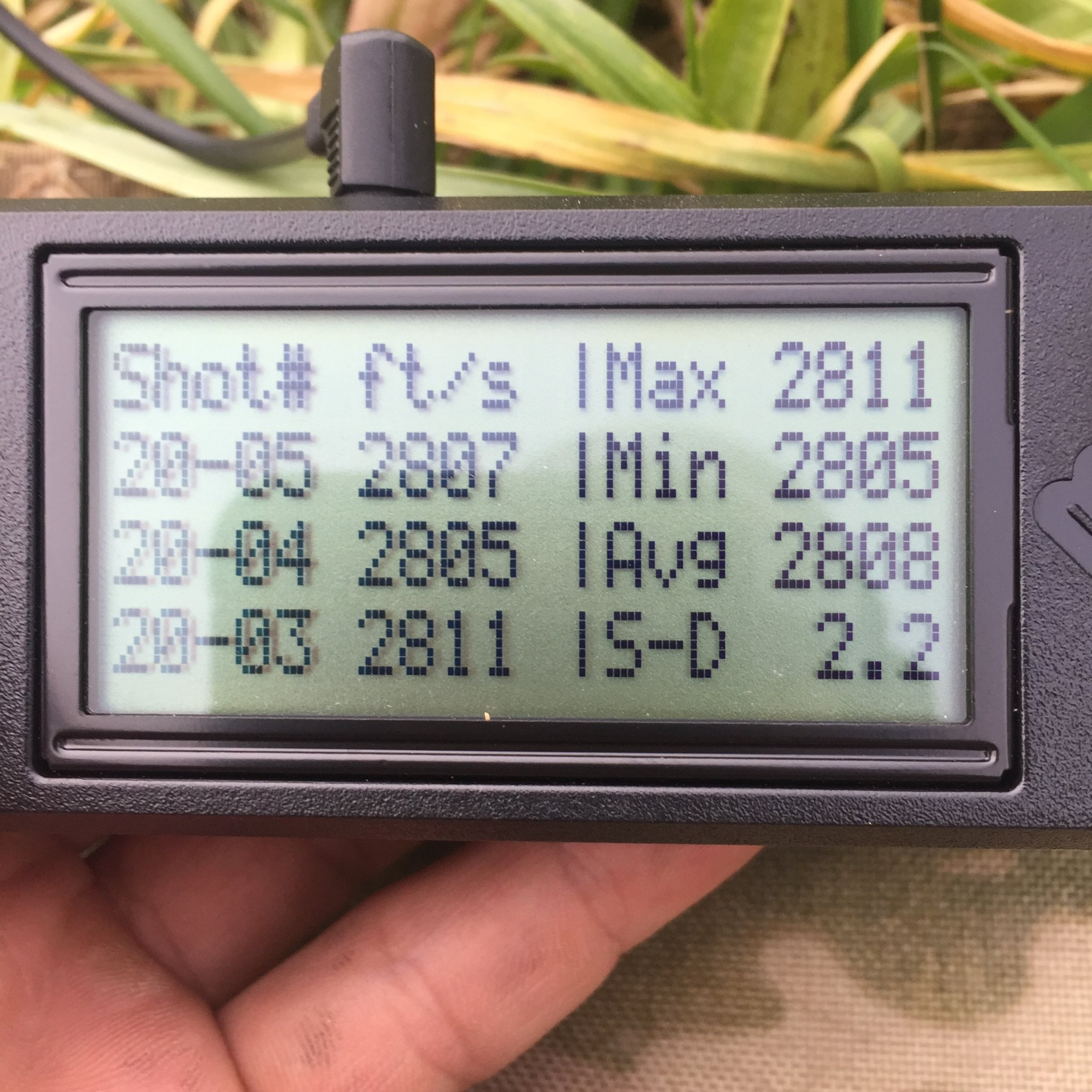

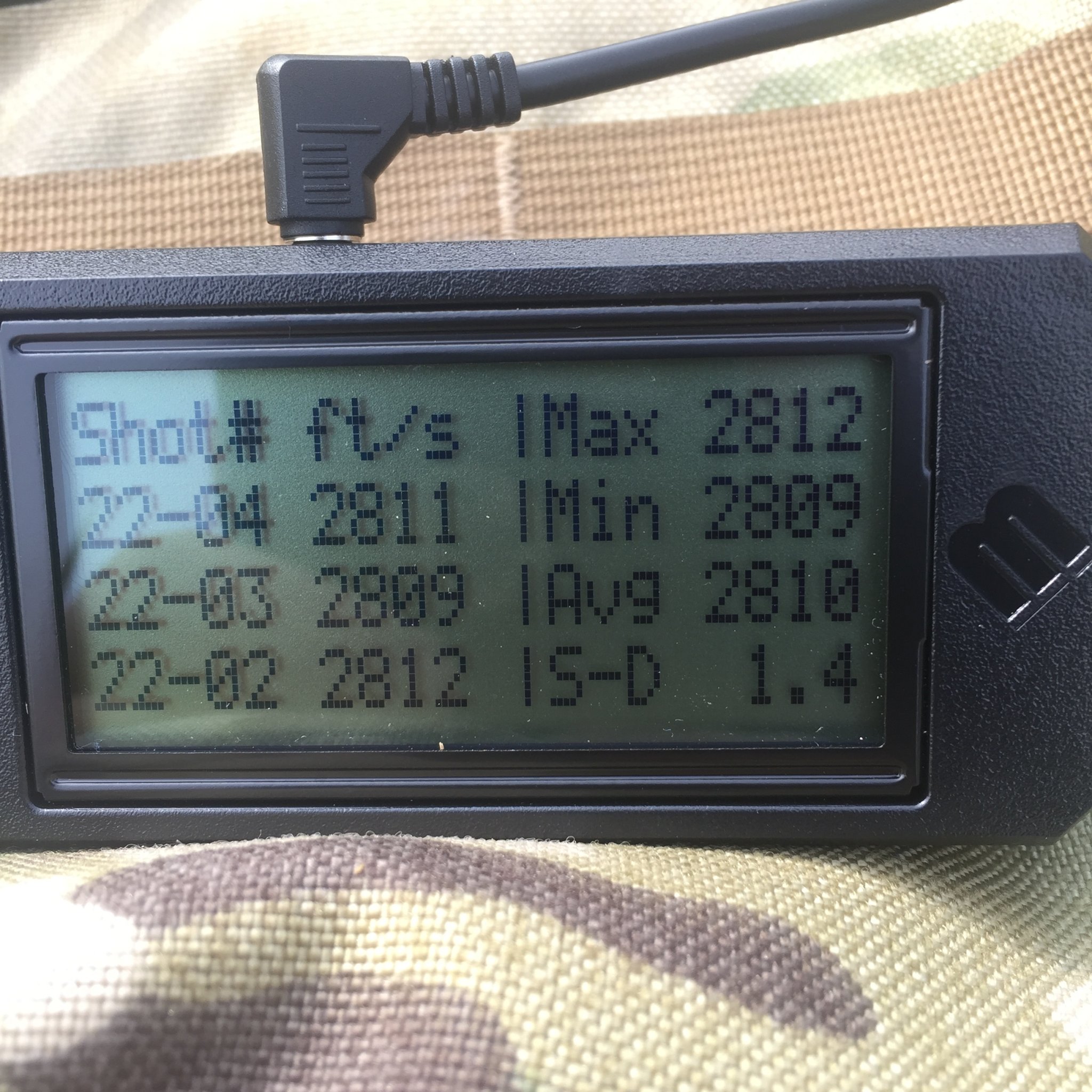

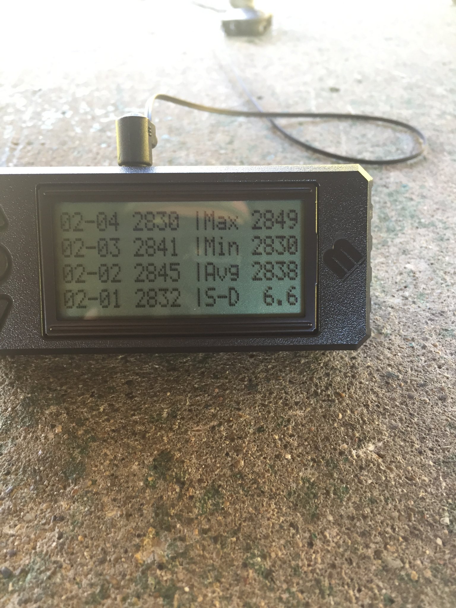

    If you decide you want to pursue a reduction in ES I would recommend changing to Lapua brass. I am shooting a nearly identical set up to yours at an almost identical velocity. My ES was worse than yours and changing from the Hornady to Lapua brass seems to have solved the problem. I am sub 10 ES on the Lapua brass using CCI 450 primers.
    I had weight sorted the Hornady in 1 grain incremennts and next turned. I did not weight sort the Lapua. I only neck turned it. The Lapua necks were thicker which allowed me to turn a little thicker which may have helped.
    Reactions: JimLee
    Hands down the Lapua is better brass.
