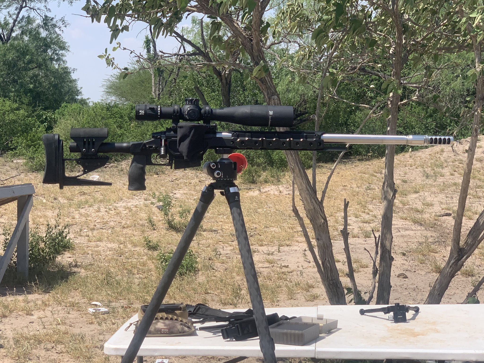

Here’s what tuner looks like on a brux mtu contour with a fat bastard gen 3 brake.

For those wondering about adjusting the tune 'on the fly', there's a thread on another forum where someone mentioned a rule of thumb of 'down and out' i.e. as the temperature goes down, turn the tuner out, and as the the temperature goes up, turn it back in. Not talking large amounts - maybe one or two marks if that (depending on the size of the increments).
Obviously it's something you'd want to test *a lot* before relying on it in a match. Might have to play with it myself, just to see :unsure:
I’m very much in favor of everyone shooting a match I’m at changing the settings on their tuners as they day goes one.
Change often. Once a stage at least.

Cool to see that MPA is picking it up.
I'm still curious to see if this is something that sticks or if it's going to be a flash in the pan like barricade blocks/wedges.
What would concern me is the retention method. I hate grub screws. If those come loose, your groups and shooting will go to shit in a hurry. Could be something that works against you. Our sport is a lot harder on equipment then F-class and benchrest.
I personally don't like the idea of adding another failure point on a rifle, particularly one that can quickly change how the rifle shoots with very small changes. Same reason why I don't like the idea of most "switch barrel" setups.
Anyways, I'm really curious to see where this gear trend goes in PRS/NRL.

If the threads are machined correctly, it doesn’t move. It’s a very tight fit. I haven’t had it move with or without the screws.
But, I also clean every 2-300rnds. Which means the muzzle brake is removed. So I take the time to make sure the tuner is still in the correct location. Thus far, it’s never moved. I think anyone that is serious enough to use one is likely checking their system all over (action screws, scope mount, brake, etc) before shooting a match. I’m sure someone won’t and it’s will bite them in the ass.
The last club match I won, it was by 1pt. I was able (lucky?) to hit the 1/2 moa on the kyl rack. IMO, this is where small attention to detail in loading or using things like a tuner benefit. Not very often, but when it does, it’s of great benefits.
I don’t think these will take off in a massive way, but I do think you’ll see them in increasing numbers.
Different models have different methods of locking. Some have hard point set screws, some have jam-nut setups, etc. I think part of why Erik's model has been as successful as it has been is due in part to using some nylon tipped set screws, so you can snug them up to where it doesn't turn on its own... but you don't have to go fishing for a tool every time you want to move it.
The first one I got, I sent the barrel to him to have it installed. The second, I took to a local gunsmith to have done, figuring it can't be that complicated in the overall scheme of things. Granted, this was way before there were *any* install instructions included, and the gunsmith machined the entire length w/ a 5/8-24 thread. I'd never taken it off the old barrel, so I didn't know any better. He never tried putting it on, as he'd never messed with a tuner before. Luckily I tried threading it on there in the shop before I left - it went on a little ways, and stopped. Pulled it off, fiddled with it, looked inside and saw the 'straight' section. So, the gunsmith chucked the barrel up in the lathe, and turned down the threads in that area to where the tuner would fit. Looked fugly, but hey, it's going to be hidden under the tuner, so no biggy, right?
Wrong. That damn thing two-grouped worse than anything I'd ever seen in my life. Two shots in one hole, then another couple 3/4-1 moa away. Luckily it was a factory barrel (that had shot pretty well before this) that at that time was zero cost to me. That straight section on the install is there for a reason, as an alignment pad for support. Don't fuck it up.
The other thing that I predict you'll see if tuners become more prevalent will be people claiming that 'someone moved my tuner' when they suddenly can't hit anything on a stage.
