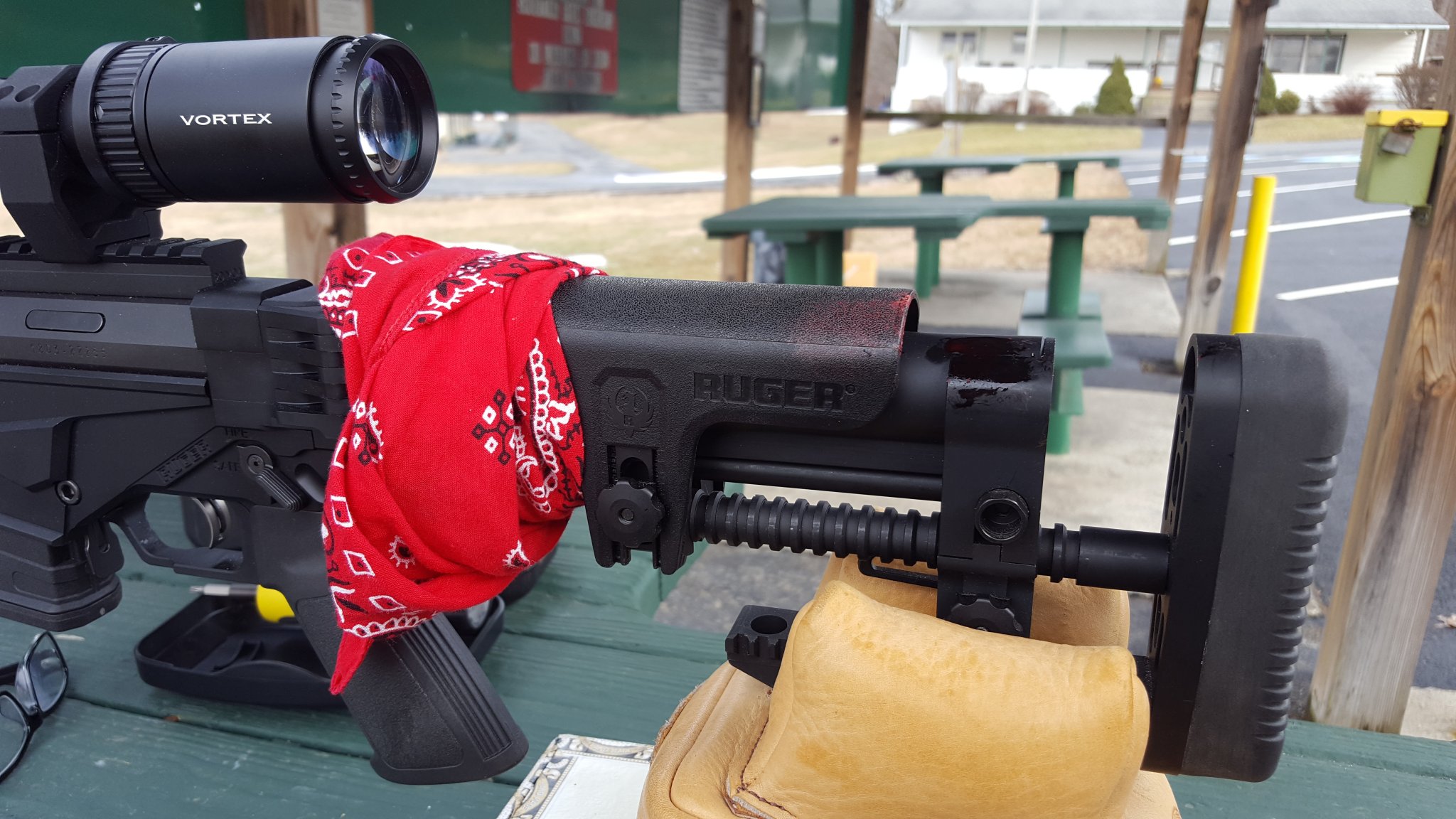

Found the problem. Was out on the range yesterday and was getting sprayed fairly often. The Ruger RPR has a tube (not sure of the name) in the stock assembly. It is inline with the bore and ends just where the butt pad adjusting assembly starts. This tube is capped, but has a very small hole (0.020" ?) in the center. The rear of the bolt has a clear shot all the through to the cap. There must be escaping gas and spent powder into this chamber with enough force to fly through the small hole and sting the face.

Can you take a picture of what you're talking about? Just went to look at my RPR out of curiosity and don't see it. Also, mine has never sprayed me with anything.

There definitely should NOT be any gas coming out of that section of your rifle.
By any chance do you sport a beard of some sort? Short scruff? My guess is you got one of your whiskers caught in some spot or another on the stock. Bolt actions don’t behave that way.

I dont really see how thats possible when the entire ejection port etc would be where the gas would go first.
Cover it with a piece of tape. Fire a few rounds, see if its still happening. Take the tape off and look at it, see if there is any gray residue on it. Then shoot it again and see if it starts happening again.

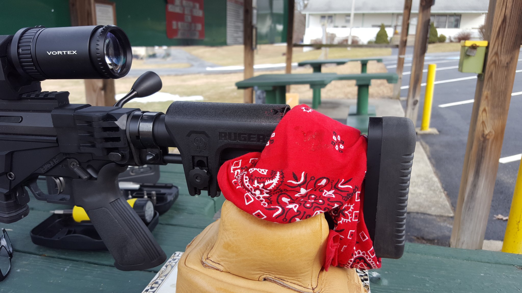

Buffer tube was the name I couldn't remember. I am planning, as suggested, to tape over that buffer hole.
I also agree with a bolt action not blowing back like this. Especially with out some signs on the br
ass.

Could it be a pinch rather than impact from gas leak. When I first. Started shooting a RPR, on several occasions I got the skin pinched between the back of the cheek rest and my ear muff. Happened frequently enough I switched to a magpul PRS stock.

The physics of the way the firearm works mean that if gas is leaking from there, it’s leaking from somewhere else in your bolt/chamber first. If it were me I wouldn’t shoot it until the problem is identified and resolved. That’s just me.
Like Spife said, it would come out the ejection port or somewhere else around the bolt first. Even if gas made its way through the firing pin hole in the bolt face, it wouldn’t make it past where it threads into the cocking mechanism. Even if it did, it would then go into the shroud. But the shroud doesn’t have a hole in the back and is not an air tight seal. It would come out around where the shroud connects to the bolt. Remember the gas is under very high pressure. It could leak from a hole you cannot obviously see. I’d get that thing fixed.

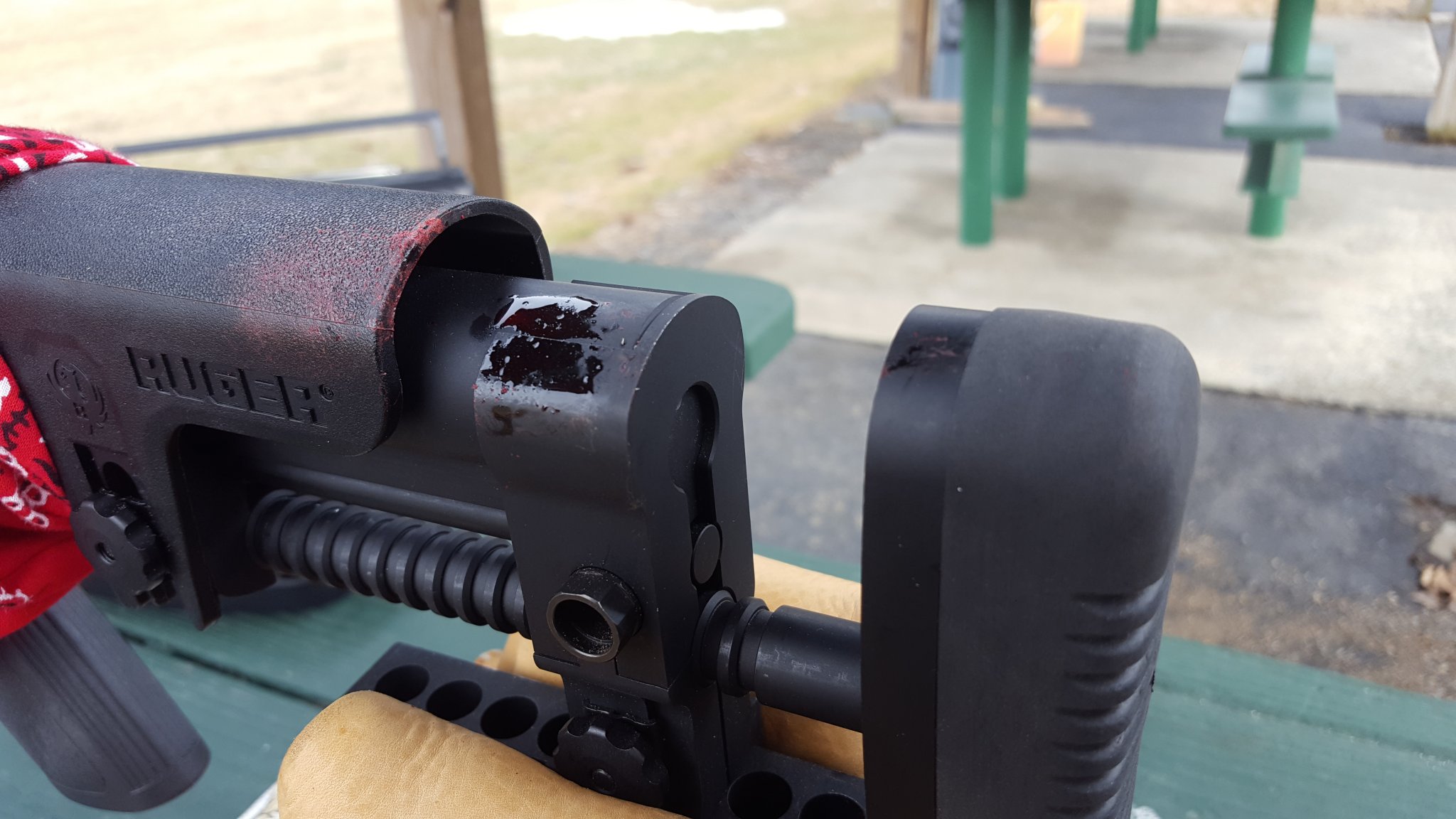

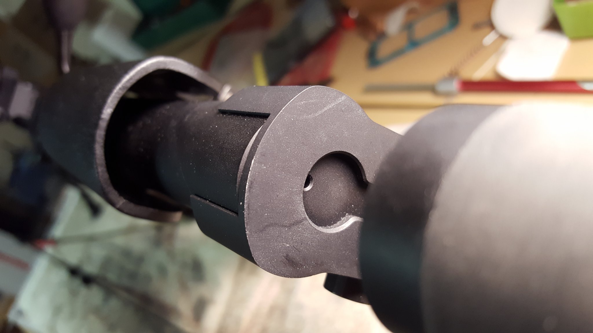

Was load testing today and found the nasty cause. about halfway through the session I noticed blood on the stock. The sting was chewing my cheek up. Before leaving the house I stuffed some wedding in the buffer tube to block anything trying to get through. No help. I then wrapped a rag around the hole area. No help. The wrapped the rag around the back of the receiver. No help. Only then did I feel the edge of the metal where the hole lives while wiping some blood off the stock. Bitch was like a razor. Recoil was dragging the edge across my cheek. Felt like a sting from flying debris, but really was a scraping action. Moving the comb back solved everything. Now I feel like a dope.
Thanks for all the suggestions. Catching whiskers was a close suggestion.
