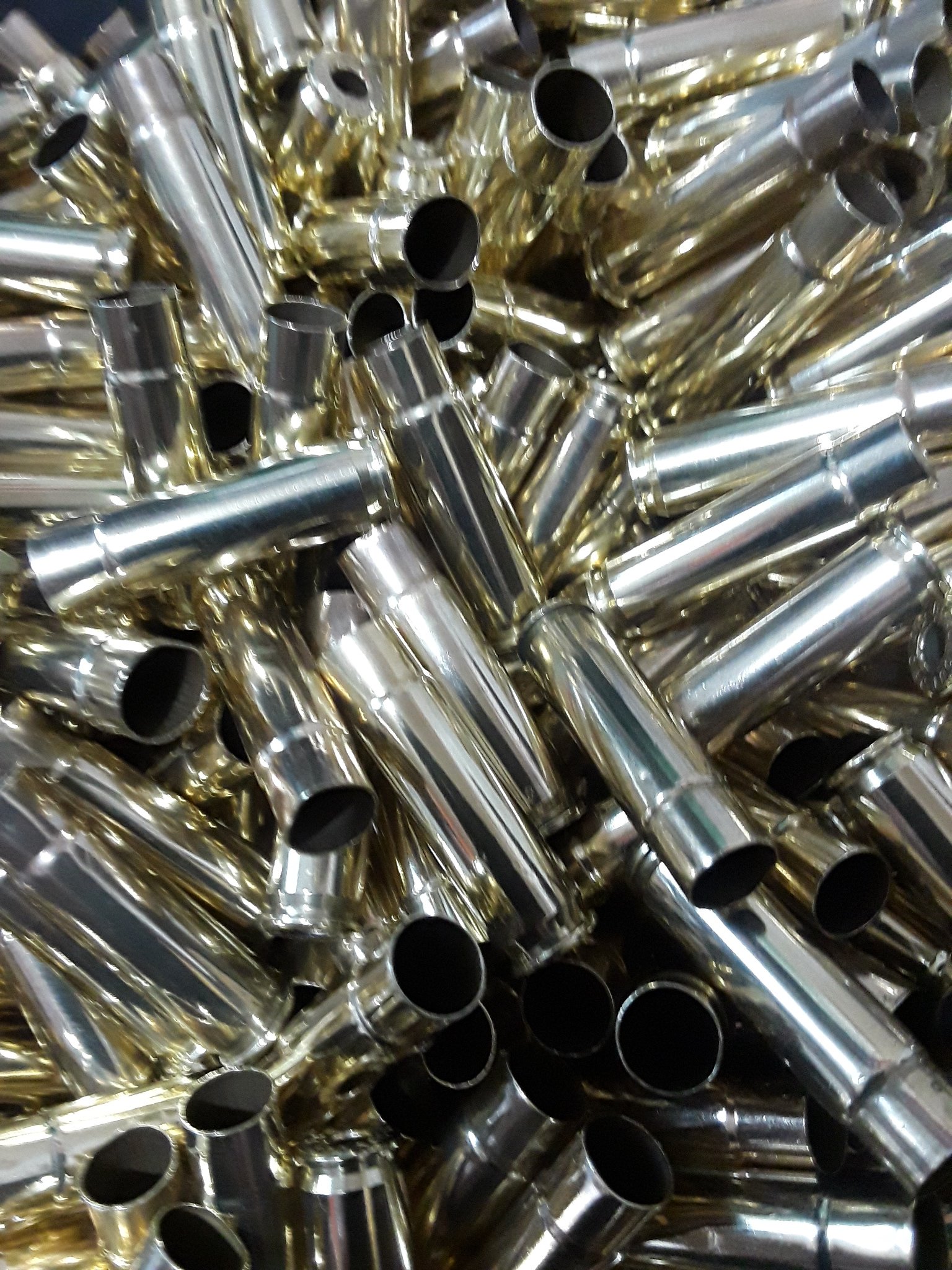

Long time reloader, used Imperial wax for body and neck sizing with no issues. Then I tried wet cleaning for the first time with ultrasonic cleaner.
I love the lack of dust, clean primer pockets and no worries about media stuck in the case. But I noticed resizing brass, when the expander button pulled through the neck I was getting extreme resistance. It was like nails on the chalkboard chattering pulling the handle back up through the case. (note- this was on a hunting rifle that used a standard sizing die, so the neck was getting sized down a lot before hitting the button)
So I tried graphite, slathering the button in wax, polishing the button etc.... and nothing was helping. When I cleaned brass in dry media, no issue. But the wet cleaning resulted in squeaky clean necks and I was getting runout and inconsistent neck tension.
Was about to go back to dry media when I read a tip on 6mmbr. Someone posted a trick of taking a nylon cleaning brush and wrapping some fine steel wool around it (like #0000). Just a couple quick passes back and forth in the neck before sizing.
Completely solved the problem. Night and day difference in sizing and seating. No cold welding, rifle accuracy returned.

NW, I concur with what you've said. The issues all arise from the brass being TOO CLEAN.
6mmBR.com talked about this years ago when they first did their ultrasonic article & I found the same when I messed around with ultrasonic myself.
For in home use, wet tumbling is WAY more practical & gives much better results than conventional tumbling or ultrasonic although it seems to have added extra steps for everyone.

I went down this road when I was considering having someone else anneal my brass. They wanted to wet tumble the brass beforehand, and I have heard negative input about 6.5 CM brass and steel media peening the necks. So I ended up just buying a Benchsource annealer and ordering a RCBS ultrasonic cleaner. The brass came out looking insanely good ( little dry tumble before to knock off the bigger carbon bits, then ultrasonic). Then I started reading on cold welding and leaving ammo stored, etc. So I got some of the Imperial dry neck lube and applicator and went with that for a while. It worked well, and aside from never knowing consistently how much dry lube I was applying I had no issues with it.
Then one day I just got fed up with all the extra work, and started tumbling again with corn cob and a little polish wax, and annealing with carbon in the neck (what I was told would 'ruin' a case by baking on carbon). I've noticed zero difference what so ever in the wet method with all the extra steps vs dry tumbling with corncob. In fact, I had 43 rounds left over from a match a few week ago that I fired this past Saturday that had set for two full weeks. 1.7 SD and 4 ES. I know that was more of the stars lining up and weather being perfect, but even when I first loaded the 100 rounds before the match it was like 4.3 SD 9 ES the day before the match.
I now use the dry lube when I'm running my mandrel in the case necks after FL sizing. I also leave the primers in when I tumble, and just decap them when I FL size and hit them with a steel brush set up on my case prep center while I'm chamfering and deburring. Ultrasonic cleaner is still nice for AR bolts, glock parts, etc. but I wont be throwing any brass back in it.
All the extra prep work never translated to anything on paper or in match results for me. Dry tumble and go on, just make sure to wipe the dust off the cases before you size them.
